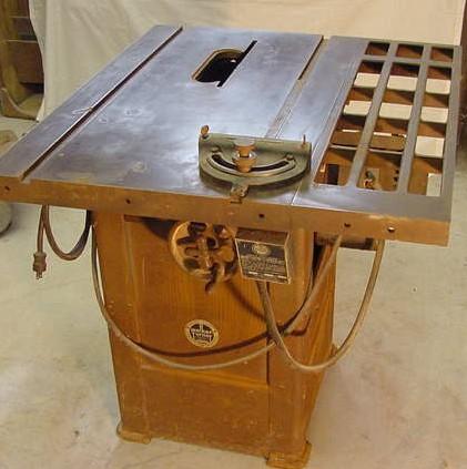

Before I start combing the internet I ask here. I just purchased Walker - Turner table saw. Beautiful piece, old, made in USA of course, very solid, very heavy, running great and missing the ripping fence.
Now I don't want to invest in Biesemeyer just yet, it would cost me more than the saw - not necessarily bad thing, but I want to use it now with minimum money invested.
OK, all that said, the table is 32.5" deep and the fence and the rails for the fence are missing. What would you do? Just clamp a straight board to it? I am open to suggestions.

your best bet is to look through the net and find how the original one was built and try to clone or closely duplicate it, if you are looking for a makeshift rip fence you could start with getting some 2x2 stainless box tubing cut to length, cap the ends drill the caps and run a threaded torsion rod through it hooks on each end and a knob to tighten on the user end,:thumbsup:

I have a fence from contractor saw that bit the dust. The first plan was to bolt a 2x2" tubing on the front and the back over spacers for the rails and than adopt the fence I have using longer C channel or such.
And yes, Kenny, Grizzly was one of the first places I searched and the Fox looks system looks doable, still pricey.
This is what a search turned out, interesting.
The BIG advantage of the Bissy and clones is that no rear support is needed, you only have to have a front rail. That old classic WT saw deserves a nice fence, and so do you fingers;)

Here is a picture.

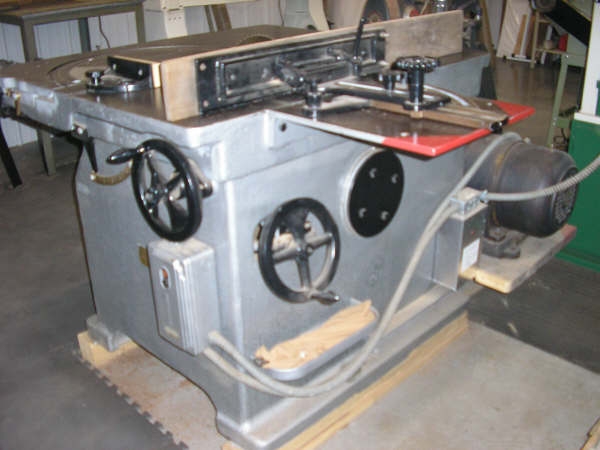

I bought a lathe, dust collector and some other stuff from an older gentleman who was slowing down. He has a table saw he is very proud of that looks similar to your photo. It's not quite the same and I do not remember the brand name. That saw has two blades (like a rip and a finish). When one blade is up in the working position the other is down under the table. A hand crank is used to swap their positions. Has anybody here ever seem one like that?

Double arbor tilting saw with rip and cross cut blades mounted.
Credits: Woodshop Tool Maintenance - Cunningham and Holtrop

my old Rockwell looks very similar made as your saw, Mine has a 1- 1/4 bar across the front that the rip fence clamp slips over, you might duplicate this onto your saw, this picture is a very close resemblance to mine, you can see the bar on front, I only keep this saw because its old and durable :cool: of course I have newer and more modern table saw's that I actually use,:D

SandburRanch --- Thanks for the reply regarding the double arbor tilting saw.
The picture you attached looks very much like what he has. I believe his came out of a furniture factory in Butler Indiana. Here is a picture from the back side that also shows the fence.This saw was originally ran of a "main" drive shaft with a belt. The dedicated motor was added later.

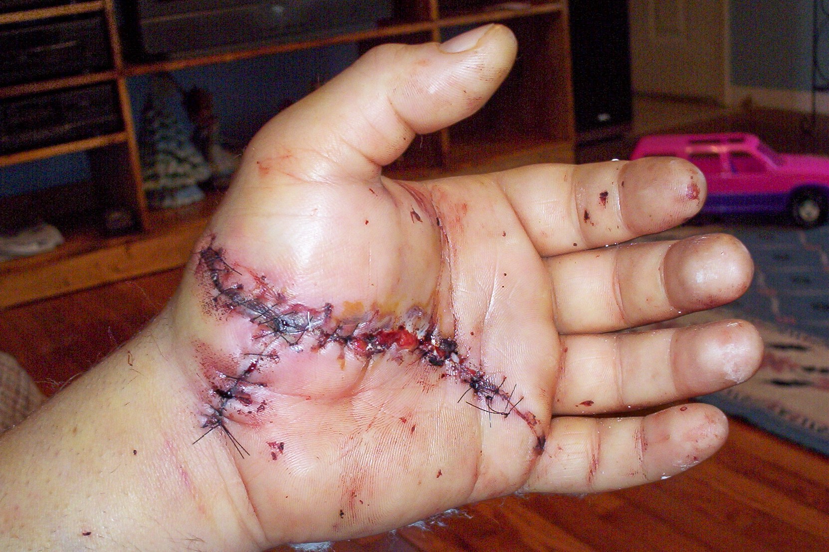

Thought I would post my table saw pic. My Orthopedic surgeon told me, after 3 surgeries, that of all his adult male hand injuries half are caused by a table saw and the other half by everything else on the planet. I am by no means a member of the safety police, but when I tell you it takes less than a second I am exaggerating, it was infinitely less than a second.

Wow. Brutal. Thanks for the pic. I always wonder if I should have shelled out the extra bux for a SawStop. Much cheaper than 3 surgeries. Experiences like yours make me even more careful. I preplan and visualize every cut before turning on the saw.

Wayne, I learned my lesson already. Much smaller damage to my left hand, but it still did hurt - a kerf in middle finger and tip off of little finger.
And you are right, it is a fraction of a second or a ohno second to hurt yourself.
The story goes on, I took the saw apart and cleaned it with scotch pad, lubricated everything and put it back together. There was a busted self aligning bearing for the tilt. Also the bearing housing was cracked, I will have to make a new; luckily the bearing was just a google search away.
