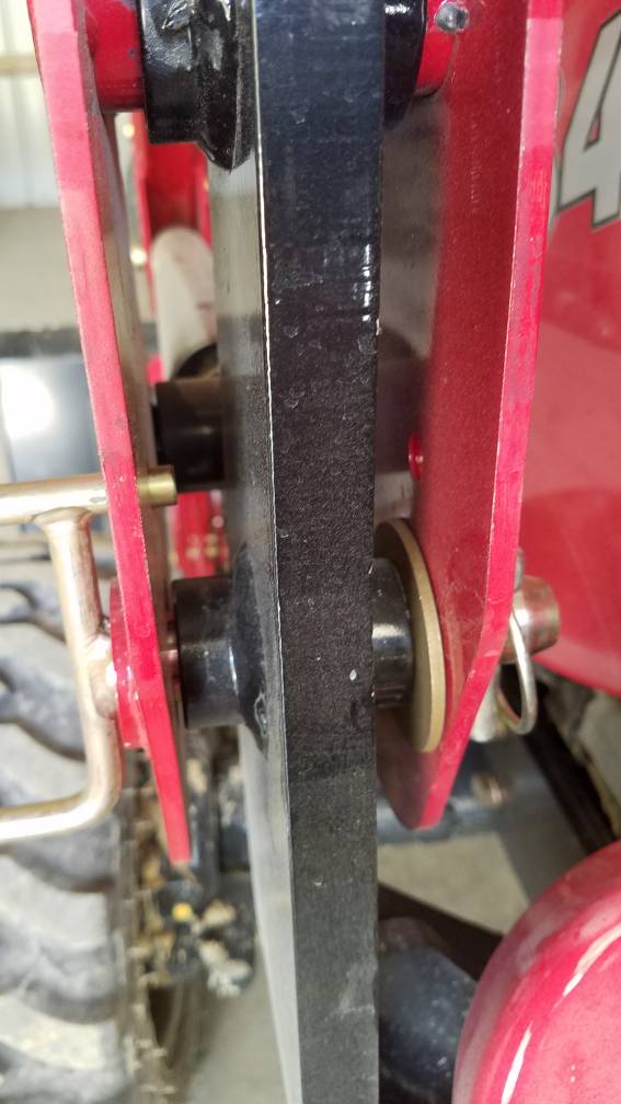

Doing some heavy work with my new T234, I have notice excessive side to side slop where the loader pins in the mount. Also a bit on the top mount. I asked the dealer why...he said it would be too hard to mount/dismount the loader if they manufactured it with a smaller gap. Is this slop a problem? I didn't like it...so I put washers in each side. It really helped to keep the loader center.
Any thoughts or opions??? I'm new to tractorin' ..so be gentle! 20180421_142237.jpeg

For safety...once the loader is on the top mount and then only when it is able to be pinned on the lower mount do I remove the pin and place the washer in. No pinching of the fingers.
Addressing the slop...if I was picking up marshmallows or moon dust in the flat plains of Nebraska ...then I wouldn't have any problems at all. If I pick up an unbalanced load of dirt or rock on my unlevel terrain the loader would shift hard to one side, inside both lower mounts. After the load is dumped, it would stay tweaked in that position until I would lift something heavy enough on the opposing side of the bucket to slam it towards the other direction.
Side to side movement on the upper or lower mounts had me worried that unnecessary wear and tear would eventually affect the operation of my new tractor. (I like to keep things nice and operating like new)
Prior to asking my TYM dealer, I traveled to the competitions lots, looking at JD and Kubota. Their design is obviously different, but appears to have a less likelihood to give in to the side to side play. This is why I questioned it.
Is this side to side movement normal?
Am I using the tractor for things it is not capable of doing? (I love the tractor. It lifts everything with ease.)20180426_202610.jpeg

/ T234 loader slop #8
Any thoughts or opions??? I'm new to tractorin' ..so be gentle! View attachment 556596

You may be right...it is my 1st tractor that I've owned. I'm not blaming anyone. I truly didn't know it's capabilities except for the advertised specifications.
The issue 1st occurred while digging earth with the bucket to create a ditch. A construction equipment task I'll agree.^^ The loader shifted and stayed to one side at the top and lower mounts. I removed the loader and found what appeared to be a weld bb/ weld slag on the top mount that prevented the loader from going back to center. This was only on the left mount. Both are machined smooth except for that chunk of slag. So it was definitely out of place. I filed it down and remounted the loader. It then went back to center.
I've since bought a box blade and have become very proficient with it.
The 2nd occurrence was hauling downed trees out of the woods. Depending on the uneveness of the ground or the load...the loader would shift. Now I'm looking into a logging winch.
I then added washers to the lower mounts. They truly have prevented the side to side shift thus any twist of the bucket.
I agree....i just didn't expect it and wanted to know if it was normal....or if I was doing thing abnormal. Thanks for the input!

The only thing holding the 2 sides together on mine is 1 round hollow tube. The twist can happen at the quick connects/bucket or both loadermounts. Because I'm preventing it at the mounts with the washers...im hoping to prevent it from breaking.
