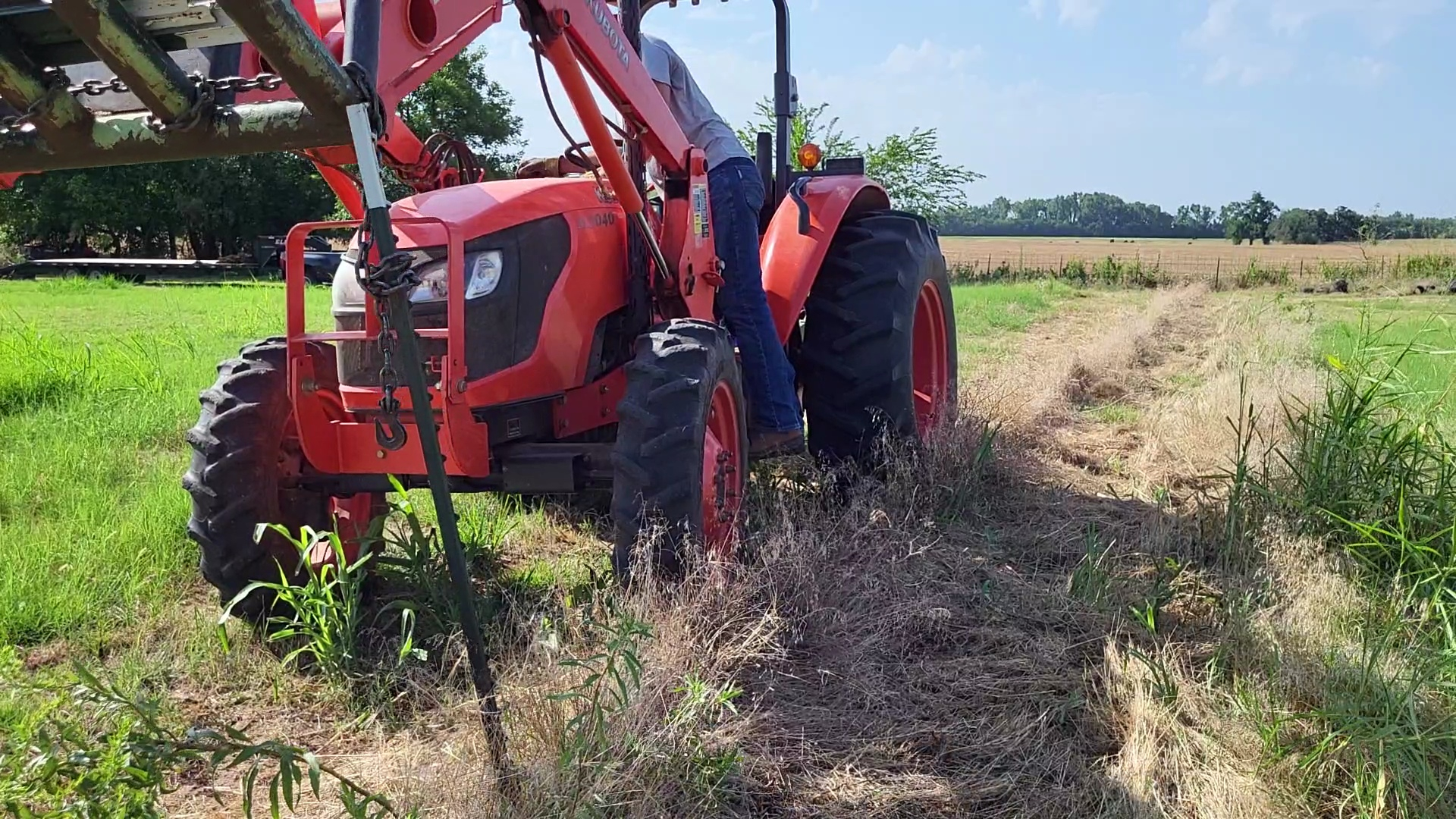

Well it worked good on flat ground, out in a rough gopher mound ridden hay field with fence rows that are naturally built up higher than surrounding grade (sandy ground).... my contraption caused more frustration than anything. I pulled about 15 posts with it before I decided to swallow my pride and grab a good ol' chain :)
I've gotten pretty efficient by myself, pulled over 100 is my guess. It is 98 degrees here with 101 heat index and its only 1:15pm.... so I didn't try very hard to get a helper, thank goodness I have a canopy on my tractor, that's a life saver.

Bummer. I had hopes for your contraption. I liked how you could pull them and release them, without getting off of the tractor.

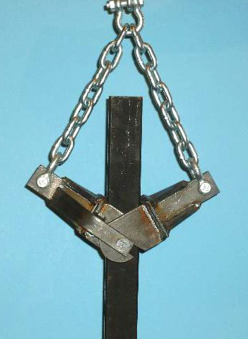

I don't have a lot of T posts to pull, and I have no idea when I'll finish my new fence, which is when I'll have to pull those T posts. I'm guessing around 50 of them. I've used the chain, and it works find, but I tend to bend half of them. I also hate having to get off the tractor to wrap the chain, then get off the tractor to unwrap the chain. Seems like I'm wasting a lot of time.
I think the answer is something like in the picture. It would grab the post from two sides after its lowered over the T post. Then it tightens up as it's lifted, wedging onto the T post tight, as it's pulled out. Then it comes loose when you lower the T post, and comes off on it's own.
I'd spend more time trying to figure out how to make it then I would getting off and on the tractor to wrap the chain around the T post, but if I could buy one, that would be really tempting.
