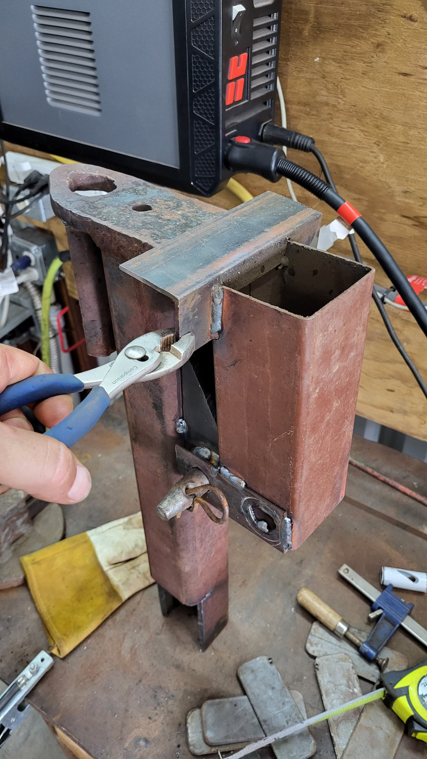

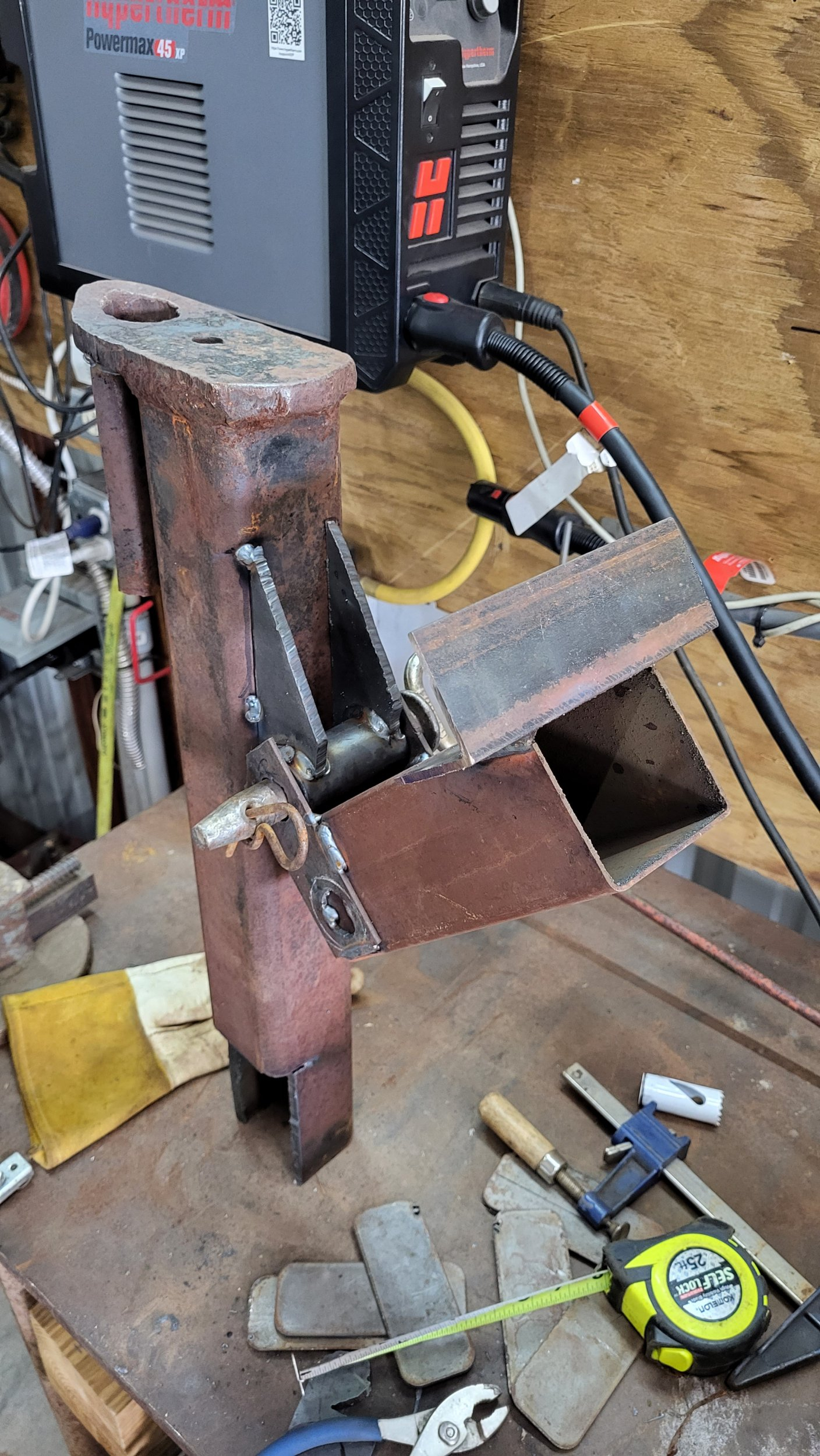

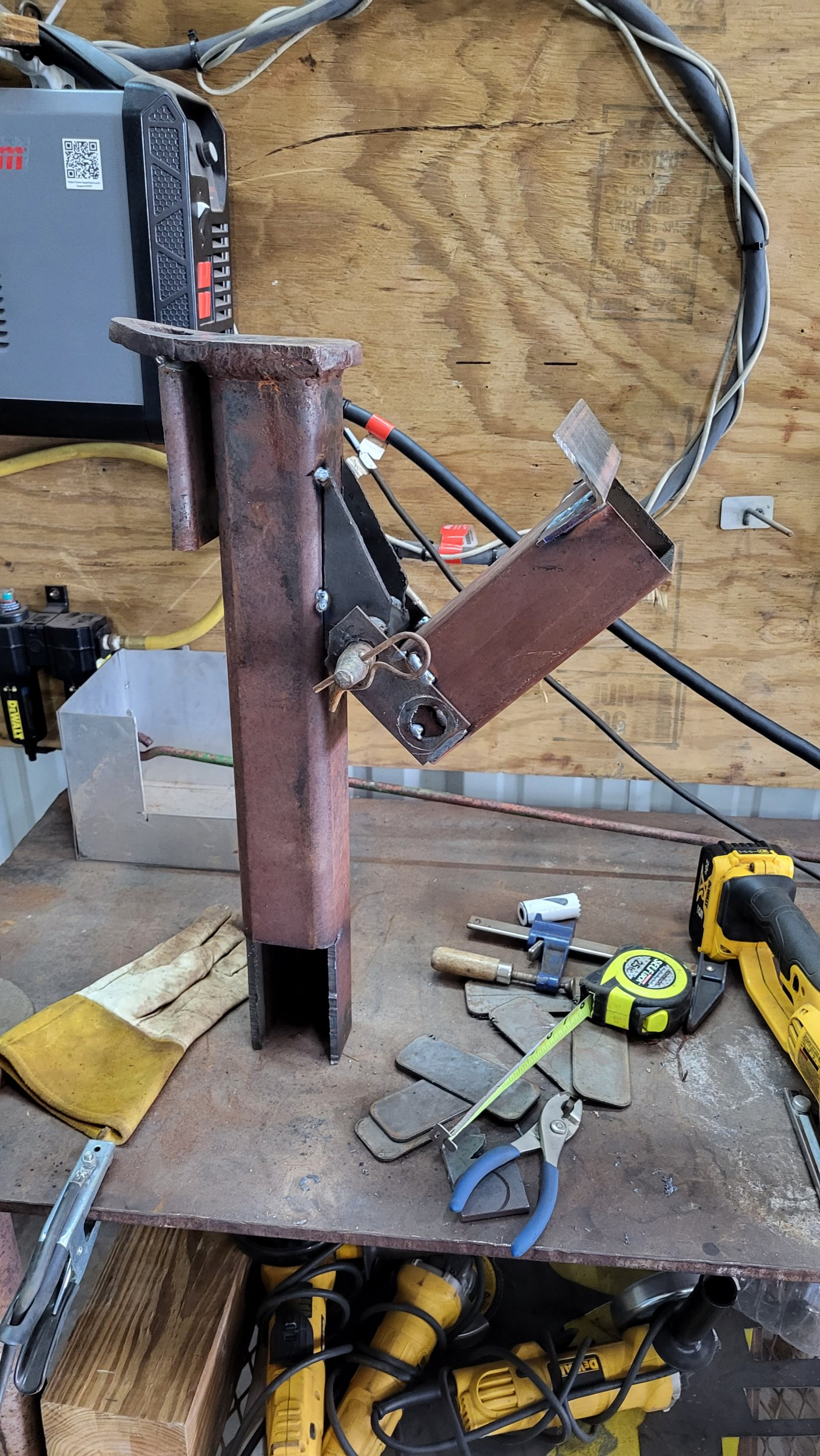

I hope this works!!!
Thus will mount on the side of my grapple, slide it down over t-post, it will lean over and under the little guide pieces, and hopefully wedge in place when I lift up :)

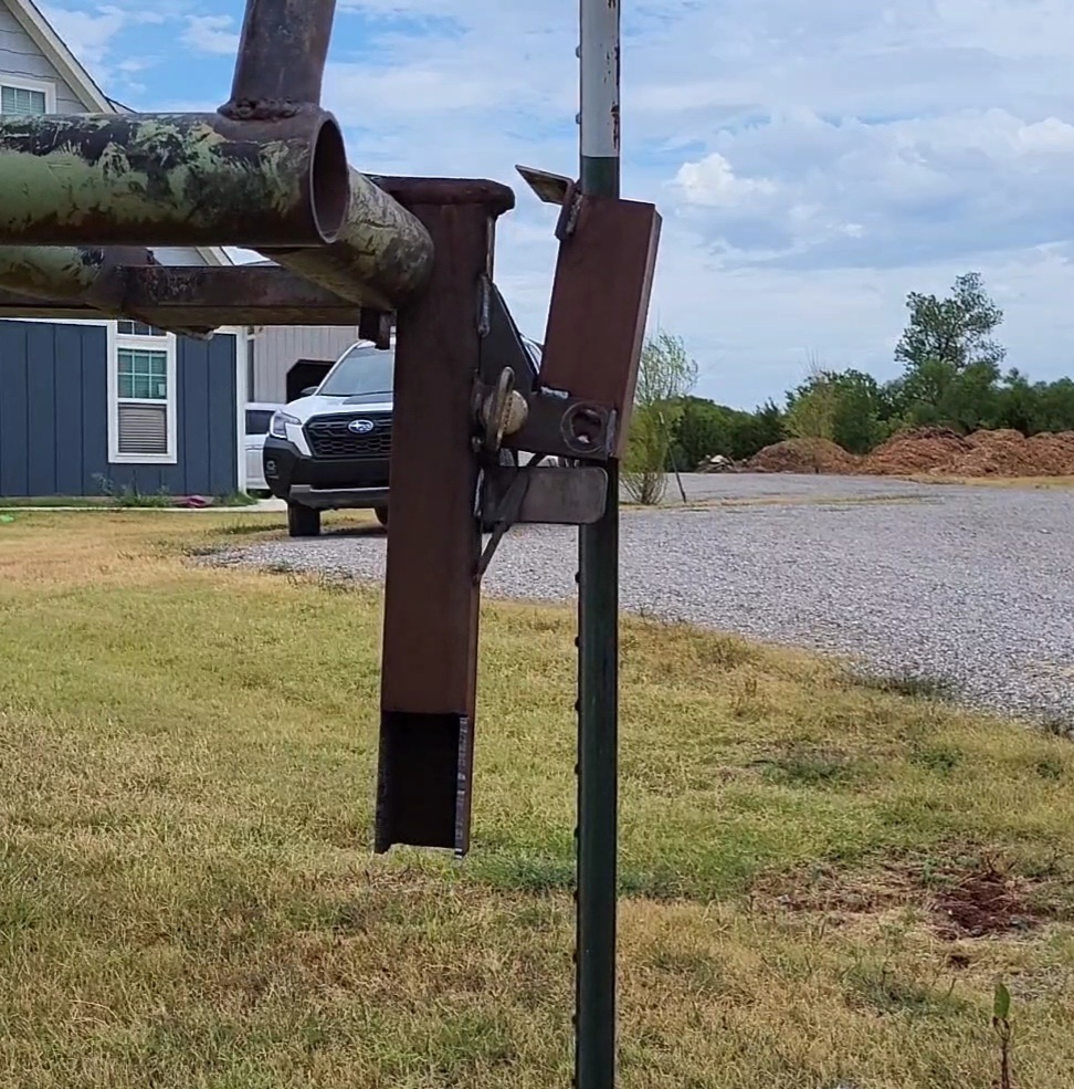

Maybe a pic with a Tpost gripped in it?
/ T-Post Puller for Front End Loader
By golly it worked!
I built this to take up about 2 miles of fence.

Well it worked good on flat ground, out in a rough gopher mound ridden hay field with fence rows that are naturally built up higher than surrounding grade (sandy ground).... my contraption caused more frustration than anything. I pulled about 15 posts with it before I decided to swallow my pride and grab a good ol' chain :)
I've gotten pretty efficient by myself, pulled over 100 is my guess. It is 98 degrees here with 101 heat index and its only 1:15pm.... so I didn't try very hard to get a helper, thank goodness I have a canopy on my tractor, that's a life saver.

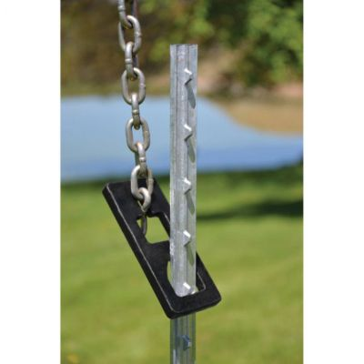

I think the answer is something like in the picture. It would grab the post from two sides after its lowered over the T post. Then it tightens up as it's lifted, wedging onto the T post tight, as it's pulled out. Then it comes loose when you lower the T post, and comes off on it's own.
I'd spend more time trying to figure out how to make it then I would getting off and on the tractor to wrap the chain around the T post, but if I could buy one, that would be really tempting.
/ T-Post Puller for Front End Loader #20
Have some old, 50 years, metal post that are hard to pull up. Some predate the T-post. Flanged angle steel with slots for wires. Red clay seems to react with the steel and pull up like imbedded in concrete. Some snap off at ground level. Pain to dig up as not wanting a future tire puncture. Use chain. Those pulling plates might be useful.
Have used the Danuser Intimdator. The instructions say not to grip metal posts.
