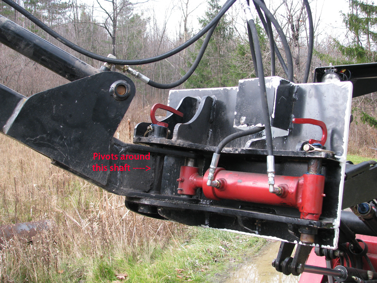

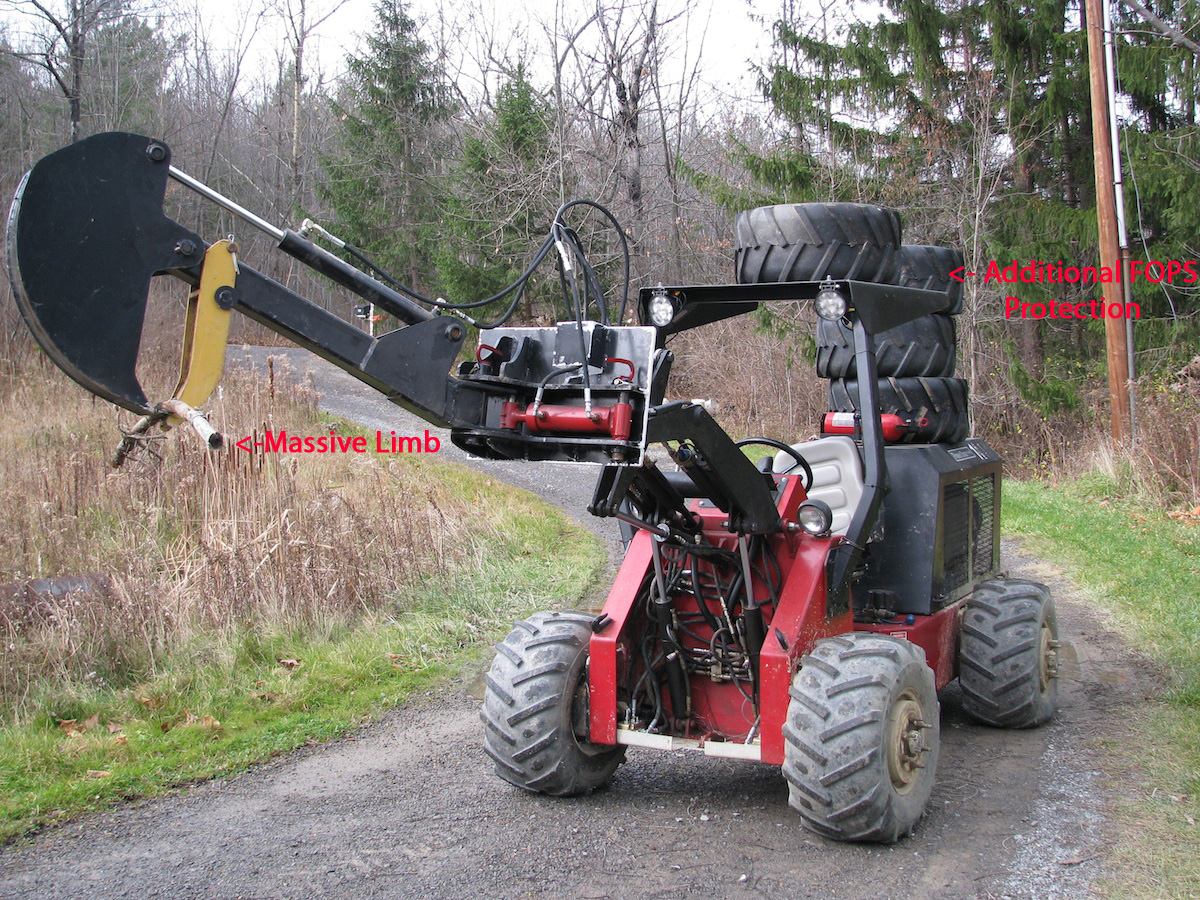

A few weeks ago, I unburied some things in the barn. One was a swinging backhoe that I had bought a while ago and forgot all about because I did not have my welder yet. It was a small prototype that never went into production. I purchased it to use as a grapple for lifting logs. A 6" bucket that I purchased for my other minihoe is currently installed but I will fab up a grapple claw at some point for it.
This should be much nicer than using the lifting boom and chains or a non-swinging minihoe.

Good thing you had those tires for counter-weight for that massive limb. :laughing:
That's something I could never do with the PT425 as the attachment would consume all the lift capacity. :(
/ Swinging Backhoe/Grapple
Those are not spare tires - trees falling on the metal cover and on the FOPS make too much noise. The tires help deaden it.
My shop is rather crowded and I have sandblasted the rims and painted them. That was the only place inside to store the tires while i was doing so.
Why it did not go into production? They said they never got it to work as well as they would like but if I wanted to play around with it, they would sell it to me since it was just collecting dust. Trying to remember which place it was. At that time, I was talking to a bunch of places. Well, when I assembled it, added the bucket, made the hoses and hooked them up, the bucket curl worked on my secondary hydraulics but not the swing. It would only swing about 2 inches. Naturally, I assume I did something wrong but I could see my hoses move when i activated each circuit. I opened up the hydraulic fitting on the side of the cylinder that was not working at all and nothing came out even when the valve was activated. I bypassed their piece of hose and hooked mine up directly and it works fine. At some point, I will try to figure out what is blocking their hose but I just replaced it with one of mine. I do not know if that was the problem they were having or not.
Moss, one reason I want to make a grapple claw is to lessen the weight at the end. When i was lifting this at the end of my lifting boom, the back end of the tractor was getting light. Those tires might have made a difference after all. I actually picked up a used dynamometer so I can see how much it weighs.
And yes, it is nice to no longer have to strain myself picking up logs like that.
Before i put it away, I used it to grab a tree that had fallen across the trail. It worked nice. The tree was about 40' long but not a massive trunk. I was able to pull the tree away from the path and the break off the top and toss both pieces to the side. Certain combinations of angles of the loader and backhoe can make it where you can not see the bucket.

I would be worried about the ability to twist your loader arms is you have it swung all the way to the side and put a massive load on it. That kind of worries me about the boom mower, as well.
I can't tell real well from the pictures, but does it only swing to the right side? I've rented a mini excavator once that only swung to the right. It allowed you to get up next to and dig almost parallel with a foundation wall, but only if you were to the left of the hole.
/ Swinging Backhoe/Grapple #12

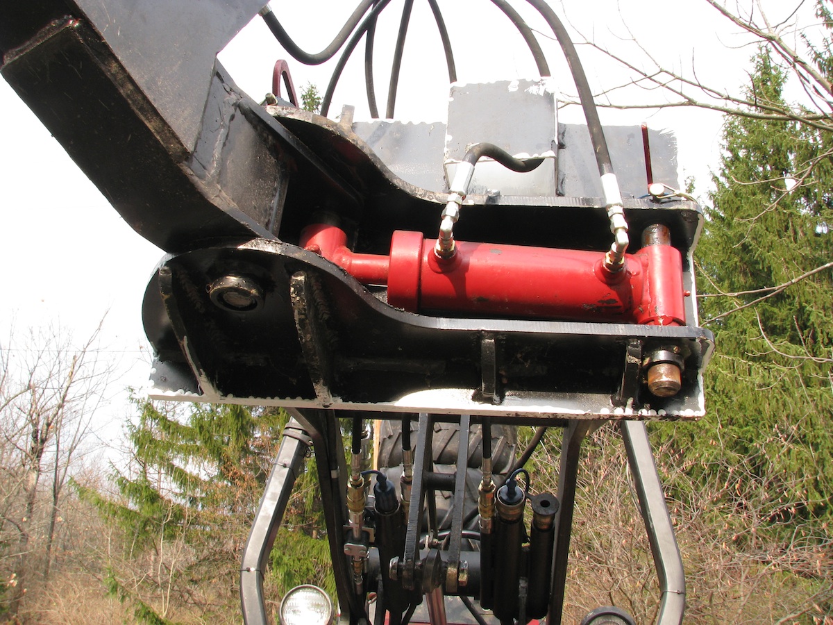

I was curious about that also, as it looks like the cyl is fully retracted with the boom straight out which would only give a left side dump.
Then again, the pictures viewing angle may be hiding the other cyl that would push or pull the other direction.
Ken, could you show a picture from the other side?
/ Swinging Backhoe/Grapple #13
From what I can see, the push pin is toward the back of the pivot pin, and if the cyl pushes behind the pivot, the BH will swing left from the drivers viewpoint , but it may be the viewing angle.
I only see hoses for two cyl's.
I don't see the hose and hose bracket on the other side either.
Only Ken knows.

it swings both ways with one cylinder. The cylinder connects past the pivot point, levering the hoe back and forth. It seems to work well. Half extended is basically centered.

The boom mower has a counter weight which would help balance out the forces.

More pictures - did not have access to them when you asked.
