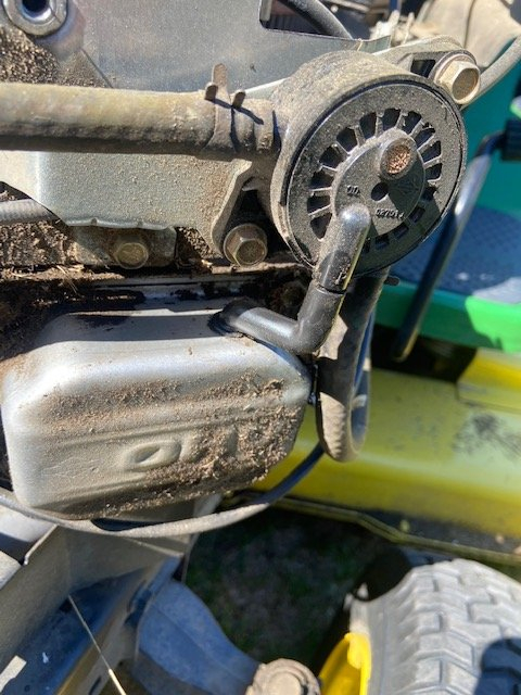

/ Surging on an LA175
#14
Is this what you're referring to?
/ Surging on an LA175 #15
That looks different from mine but that one line with the elbow is the vacuum line.
/ Surging on an LA175 #16
It's not a vacuum line, it is a pulse line.
The pulses from the crankcase cause the diaphragm in the pump to move back and forth and that action combined with a couple of check valves cause the fuel to be pump thru the part.
