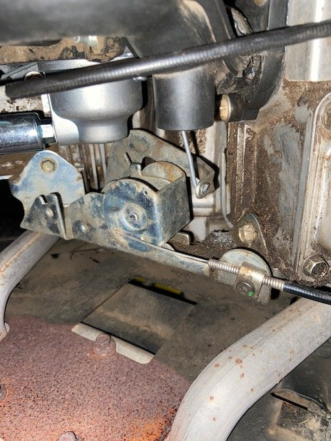

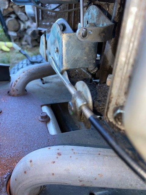

My LA175 has been phenomenal, but was recently surging. I bought a new carb and after installing, it runs smooth as can be! But, the RPMs are a good bit higher than previously. I believe I've found the issue to be a missing spring on the governor linkage with the throttle. When I look on a parts diagram site like jackssmallengines, it says there's 2 governor springs - yet my setup only has one. I believe I'm missing part #691019. I'm about to order one, but have no idea where it goes. Can someone help?
Attached are pictures of my setup right now and you can see the spring in the back.
Thanks for any help.
Jay

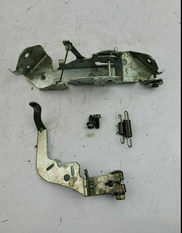

Found this listing on ebay that shows (I believe) my setup. I think it shows the governor & throttle linkage, and the 2 springs. I believe I have the larger spring...

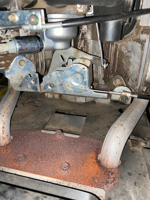

Can you see any holes in any of the linkage that look like they have some wear on them?
   / Governor spring(s) on LA175 with Briggs & Stratton 26 HP twin
I don't. Here's more pics - with it being dark out, maybe it will stand out better where the other spring goes?
