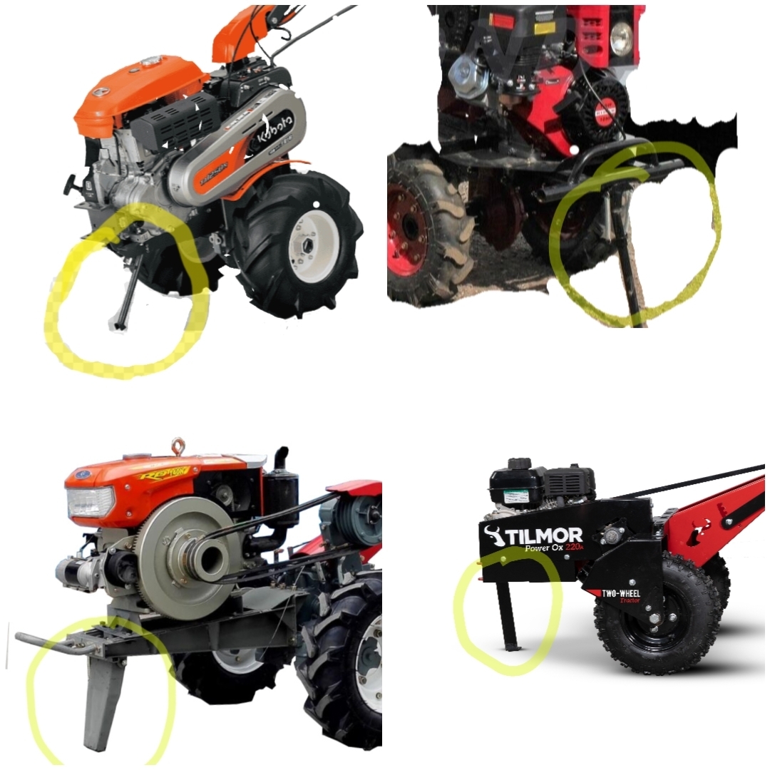

I would like to find a support-stand for my tractor. Anybody who have seen something like this for sale ? ? ?
See picture of this kind of stands on other models as illustration.

What would the purpose be for, and what kind of tractor do you have?

Purpose is to avoid parking the tractor in tilted position when no attachments balance/ support the tractor.
Why I care ? I just do ;-)

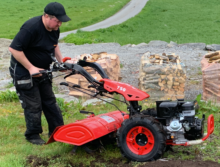

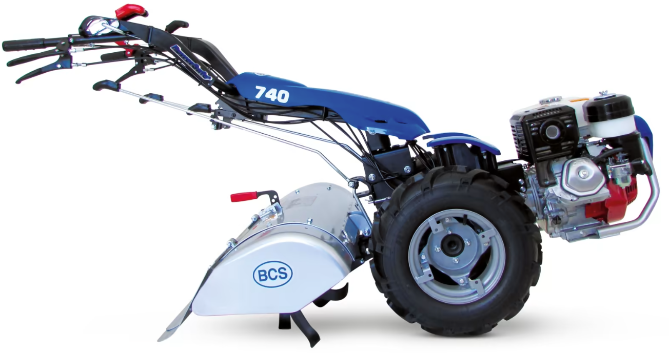

"Agro 750 ps" is in most specs similar to BCS 740. Made at same factory (in China...) with a few other specs.
The Agro-variant got a 13 HP Lifan engine instead of a 11,7 HP Honda-engine. The Agro 750 PS got disk-brakes while the BCS-version, I believe got drum-brakes.
Have a look at these video`s:
