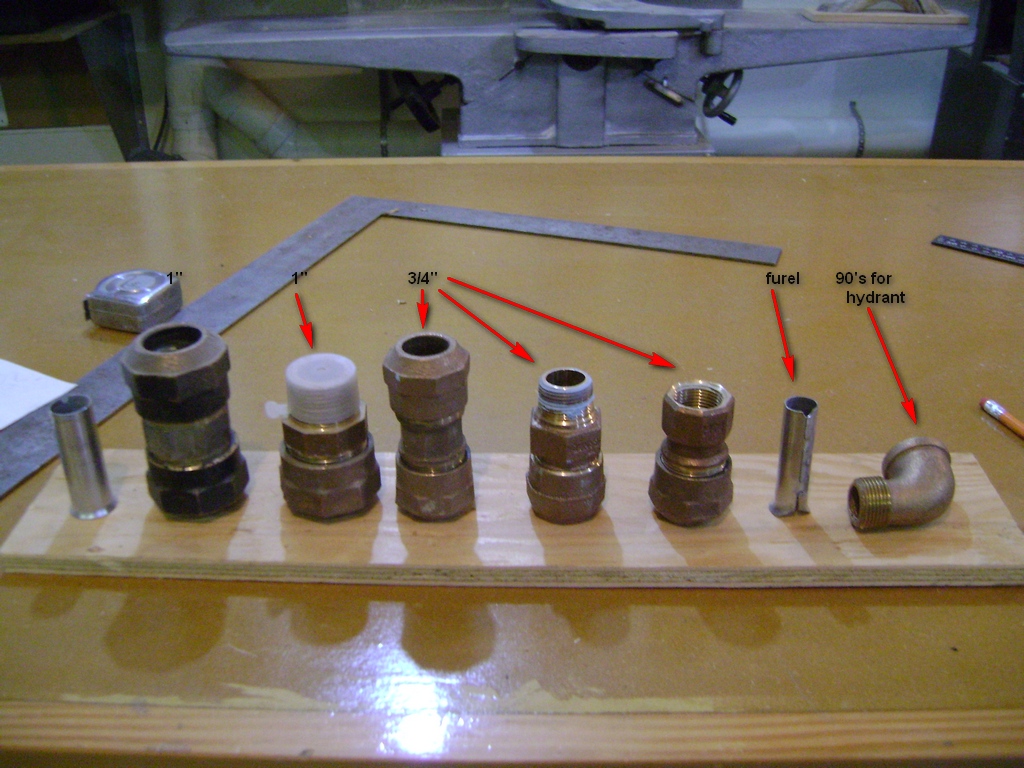

In the last 5 yrs. I've installed over 200 water meters & seen almost every kind of water line imaginable. A short time after meters are installed I get a lot of calls once the bills start coming in for water usage to fix leaks that have been ignored or just not aware ( in sandy or gravel soils). The only pipe or fittings I've never had to repair have been municipal tubing with these fittings. They also fit pex and copper ,pex is good pipe.
