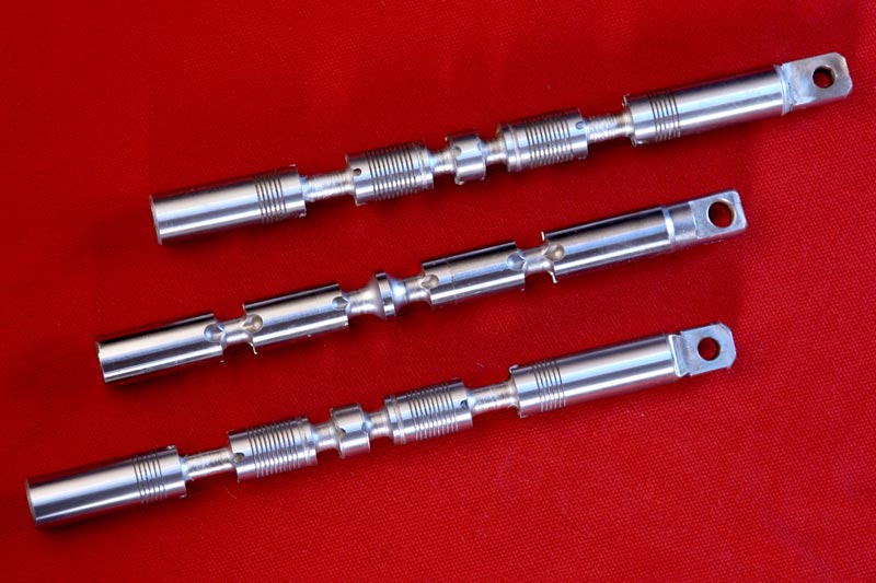

Thanks J_J, but I need to ask what is the spool? Are they the pistons that move in and out when you move the control lever or are they something else? The tractor is 8 years old and has been covered most of it's life with a car cover and the boot on the control valve has been intact until very recently. There is rust on the outer rings of the pistons but other than that they appear to be clean. I plan to replace the boot with a new one after I resolve the leaks. But, as always, solve the real problem first then make it pretty. Cheers
/ Supplier needed #7
The spool is the shiny round spool that moves in and out of the valve to route the fluid to the cyl or hyd motors. .

Great answer, pictures work wonders for preparation. It's supposed to rain most of this week so I'll put the tractor in the garage and take the valve apart and repair it so I can cut grass when the sun is shining instead of fixing the leak. Thanks again.
