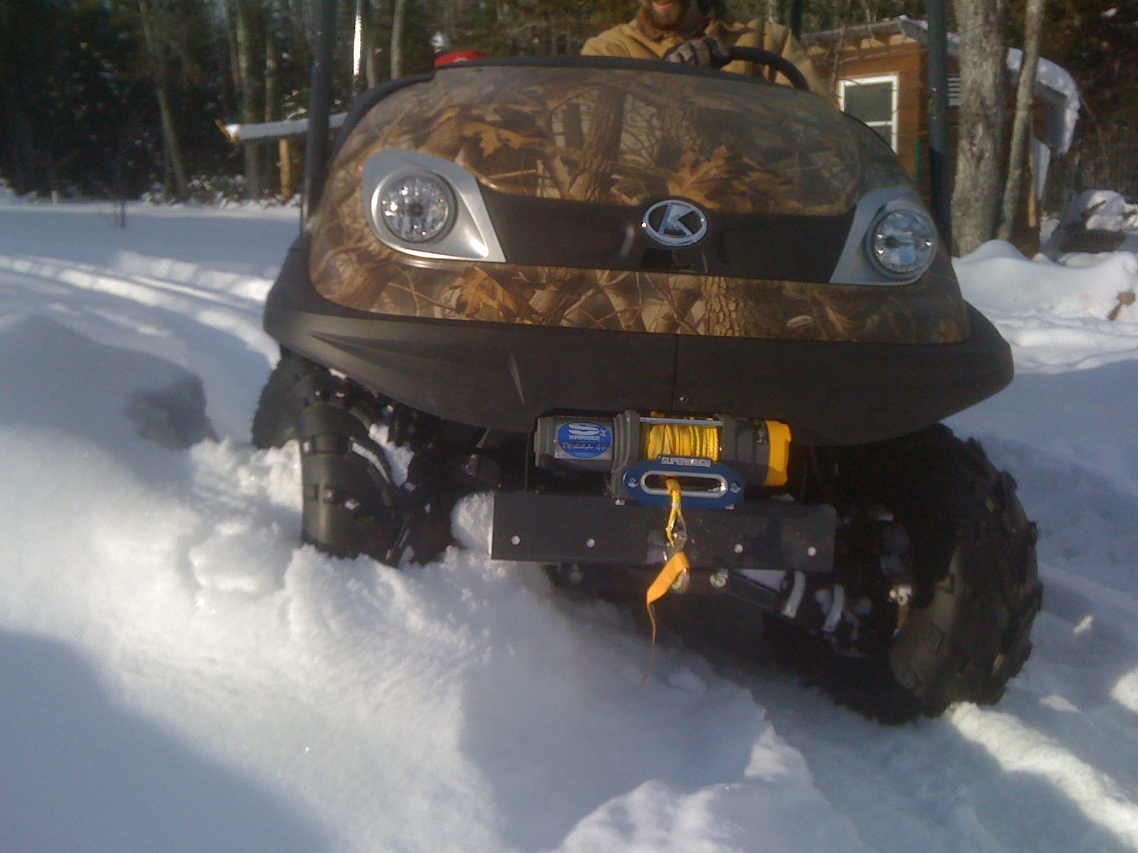

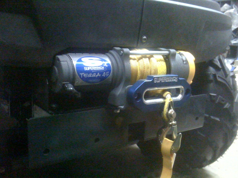

RTV 500 with camoplast 4s utv tracks, Bobcat 773 with filled tires and steel tracks
So, here it is. I just finished and will take it out tomorrow and find somewhere to sink it in the white stuff to try it out. Looks like a really nice winch for the cost. It did require a couple mods but nothing that bad.
4500lbs Super winch terra 45 synthetic rope with KFI mount kit
1. Kit's mounting bolts were too short:mad:. To get ready, go to the store and get four 8mm x 30mm hex bolts, course thread I think (take the ones from the kit with you and get ones 1/4" longer so my advice doesn't screw you up). I got SS with all new washers/lock just for corrosion.
2. If you look closely at the plastic above the winch you can see I scribed an outline around it. The winch did fit behind it but the plastic was pushed out so I customized it with a dremel tool and a razor blade for a nice fit.
3. I have the factory grill guard and noticed that the front mounting bolts are in the way so 10 min with a 4" angle grinder cutting notches and I'm good to go. It's not on in this pic cuz I'm sending it out to get rhino lined next week.

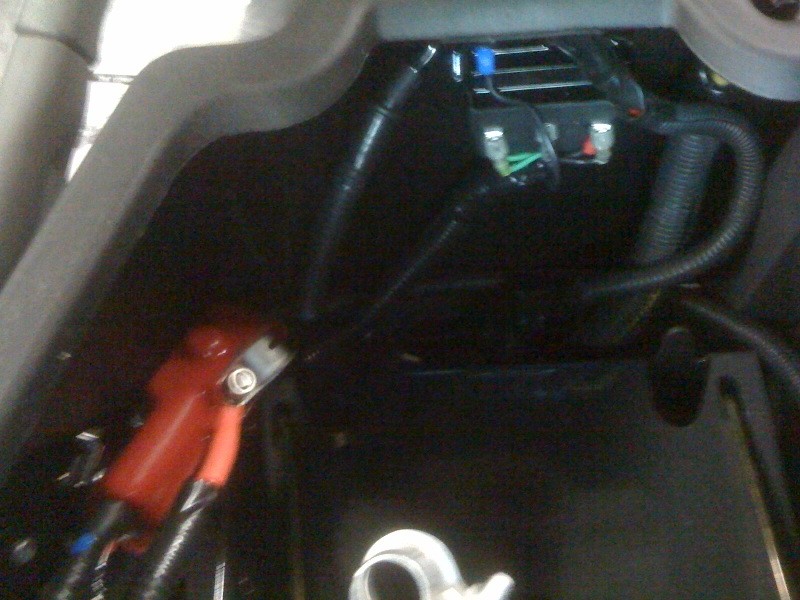

4. Figured the best place to mount the solenoid was in front of the battery, looked nice and dry. I held it high so I could mount a second below as someday I want to put a winch in the rear.

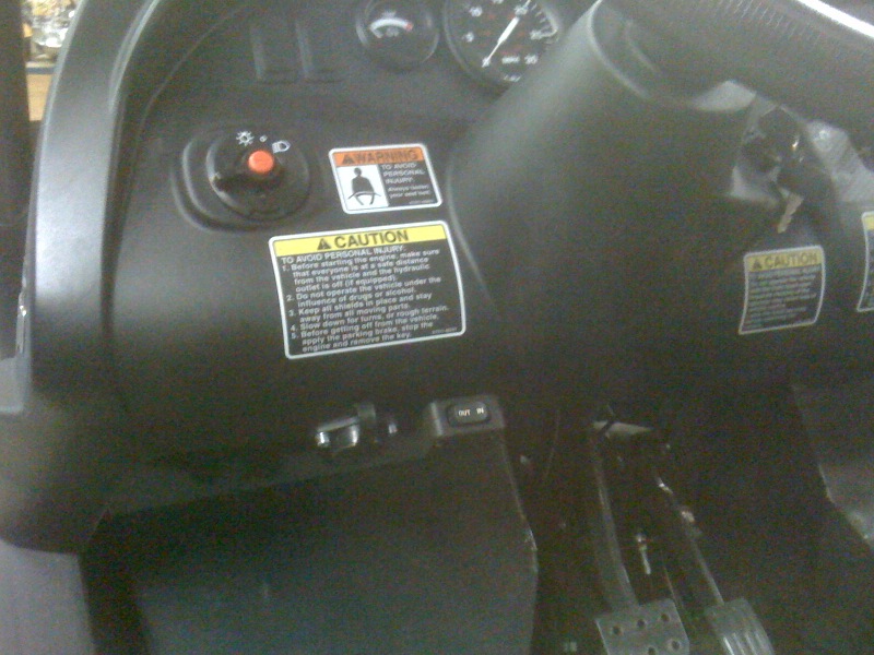

5. Put the switch and socket for the remote left of the steering wheel. Used the replacement screws that came with the KFI mount kit for the switch mounting.
6. Went to the store and bought 1/4", 3/8", 1/2" and 3/4" flex loom to cover every wire. Looks great and protects the wires from rubbing.
7. Ran the winch wires up a new hole near the hood latch and down the passenger side floor channel and the switch wires down the driver's side.
8. **I spliced the two red wires for the switch ("key on") behind the dash but ran the long one with the rest back to the battery. I found a nice little factory "bullet" style connector that tested on with the key. It was red w/green stripe and blue taped to some flex loom below the fuse panel. I'm sure it was meant for some future add on and the best part was that I didn't have to tap into any dash wires. Just crimped a male bullet connector on and plugged it in.
9. Rope was a little tricky to get started in the spool. I ended up stripping the tape and winding new tape on tighter with a pointed end to thread it better.
10. LOVE the remote:thumbsup: Used it to feed to rope on. Otherwise that would have taken two people.

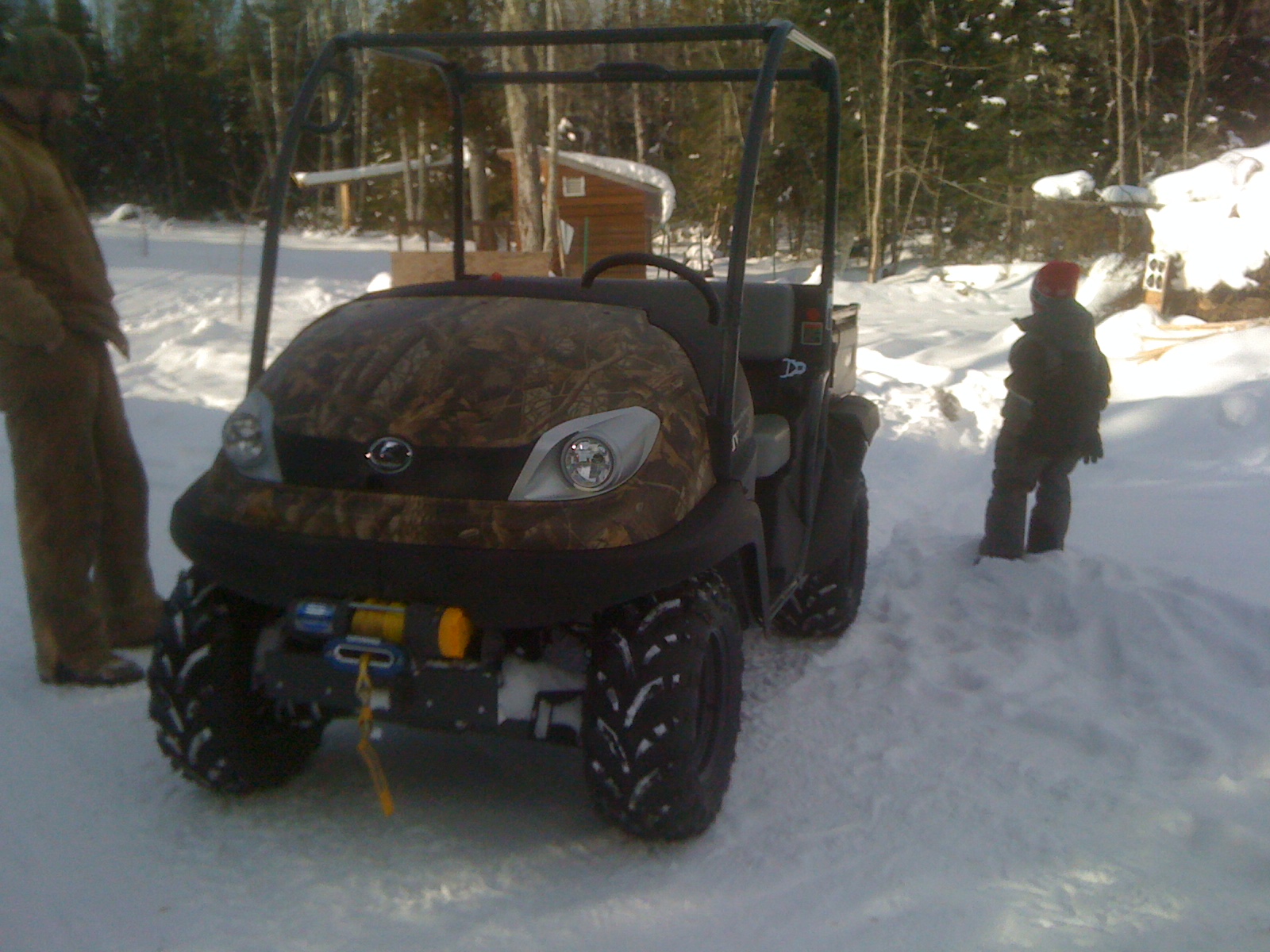

I took some time with this making it look as close to factory as I could Cuz I'm that **** (Hey I'm a trim carpenter, I can't help it :laughing:) That said it probably took me all of four hours to do but I ended up removing the battery, floor mat (only for the rhino lining), seat (easy) and drank some beer with my brother :drink:while contemplating where to mount things/drill holes. All the work itself is really easy, you just have to get to doing it.
Only thing I want to add is one of those rubber winch savers that sits behind the hook. I can see that the hook is going to scratch the Hawse which will eventually destroy my rope if I don't plan ahead here. Until I get that I'm going to leave the hook down/ loose.:thumbsup:

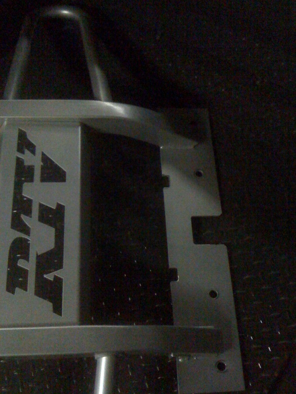

It's the top of the Brush guard flat plate that mounts to the machine (above the 4 mounting holes). If you try turning the bolt heads so one side was parallel to the brush guard it might just work without grinding it as there is some play front to back on the winch mount and I think it may just work. I'm coating mine with bed liner so I needed it to be clear regardless because of the extra thickness and don't mind the bare metal for now, plus I figured making the cuts would allow for turning the winch bolts without removing the mounting plate first. If you grind yours you'll need to paint it so try to do it without first. Unless you do the coating:D My old wheeler racks and brush guards always rusted where scratched so I'm coating ever surface that might get scratched on this machine before the rust starts.:thumbsup:
If I were you I'd mount the winch to the mounting plate on a bench then slide it in and before you mount it to the machine lift it up and slide the brush guard on and play with it to see what you want to do. Regardless, the brush guard needs to be back on before you do the final mount or you won't be able to get the guard back on. And if you wish to cut the plastic (I would recommend it) do it before the brush guard.

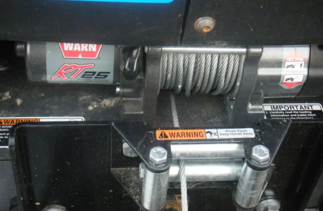

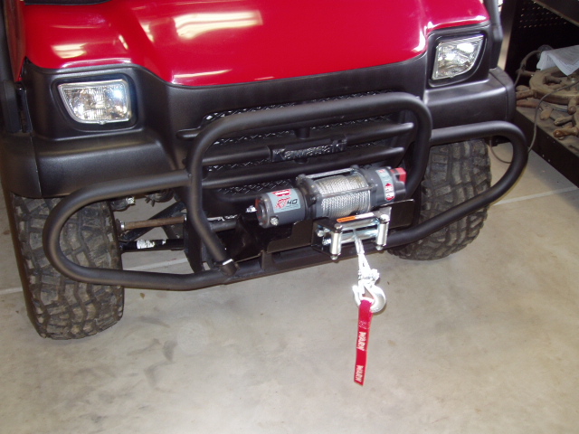

Looks like that'll work pretty well. The factory winch sits entirely in the factory cubby hole for the winch, I'm surprised the Superwinch bolt pattern didn't line up with those 4 holes.
/ Superwinch install on RTV500 #5

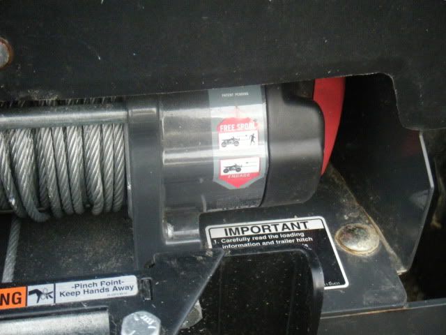

This is how the factory winch sits in
I bought the KFI mount plate because it said it would work with the Super winch as it is longer and taller than the RT25. It's holes are more forward and the winch cubby does slightly taper in towards the back so it gets smaller in there. I could have got it back farther but would have had to drill new holes, I'm fine with it.

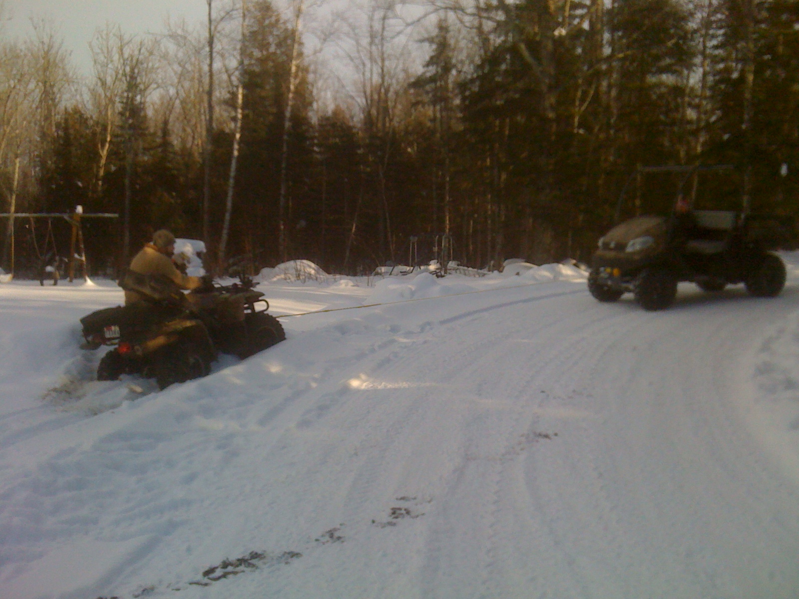

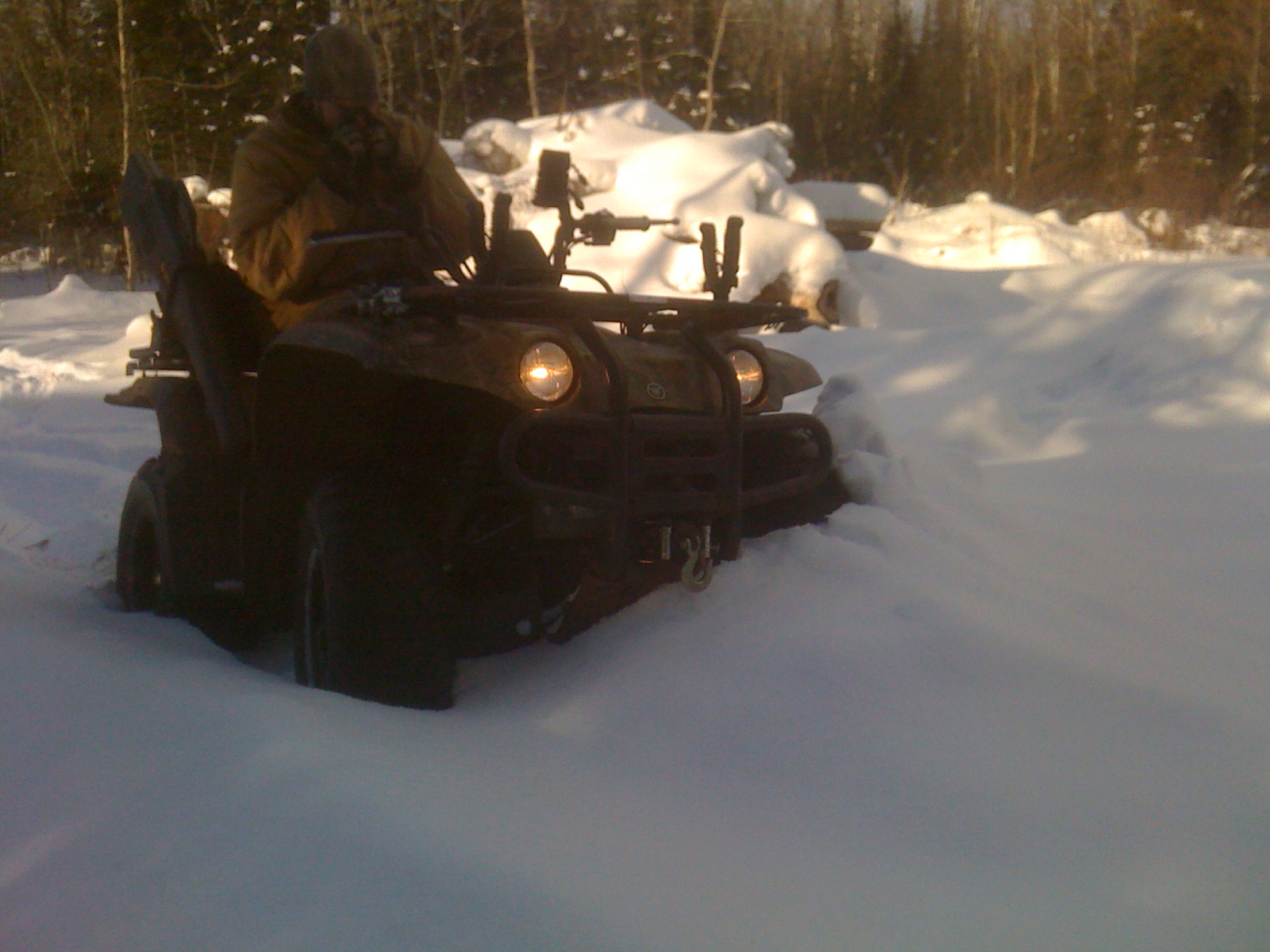

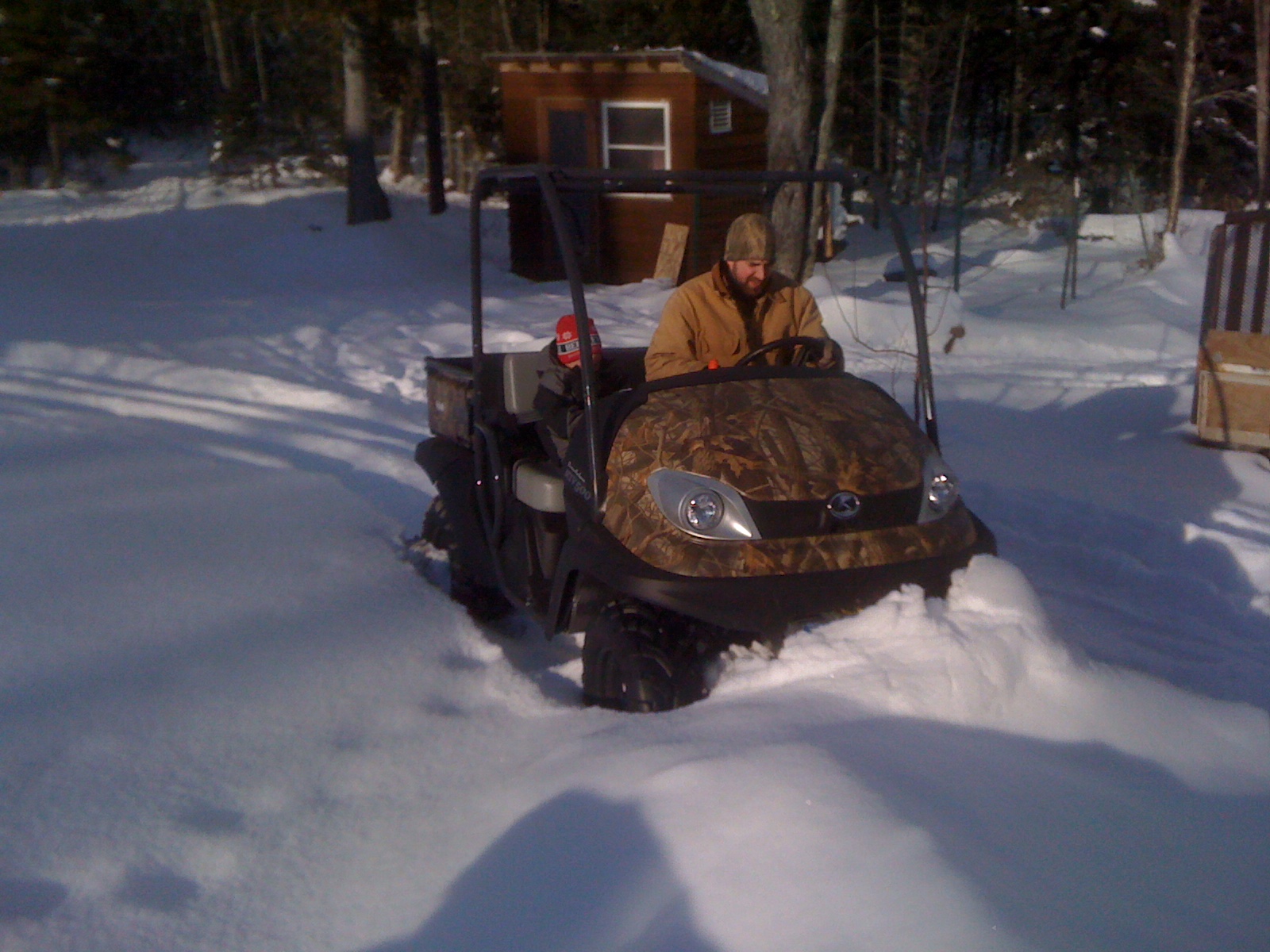

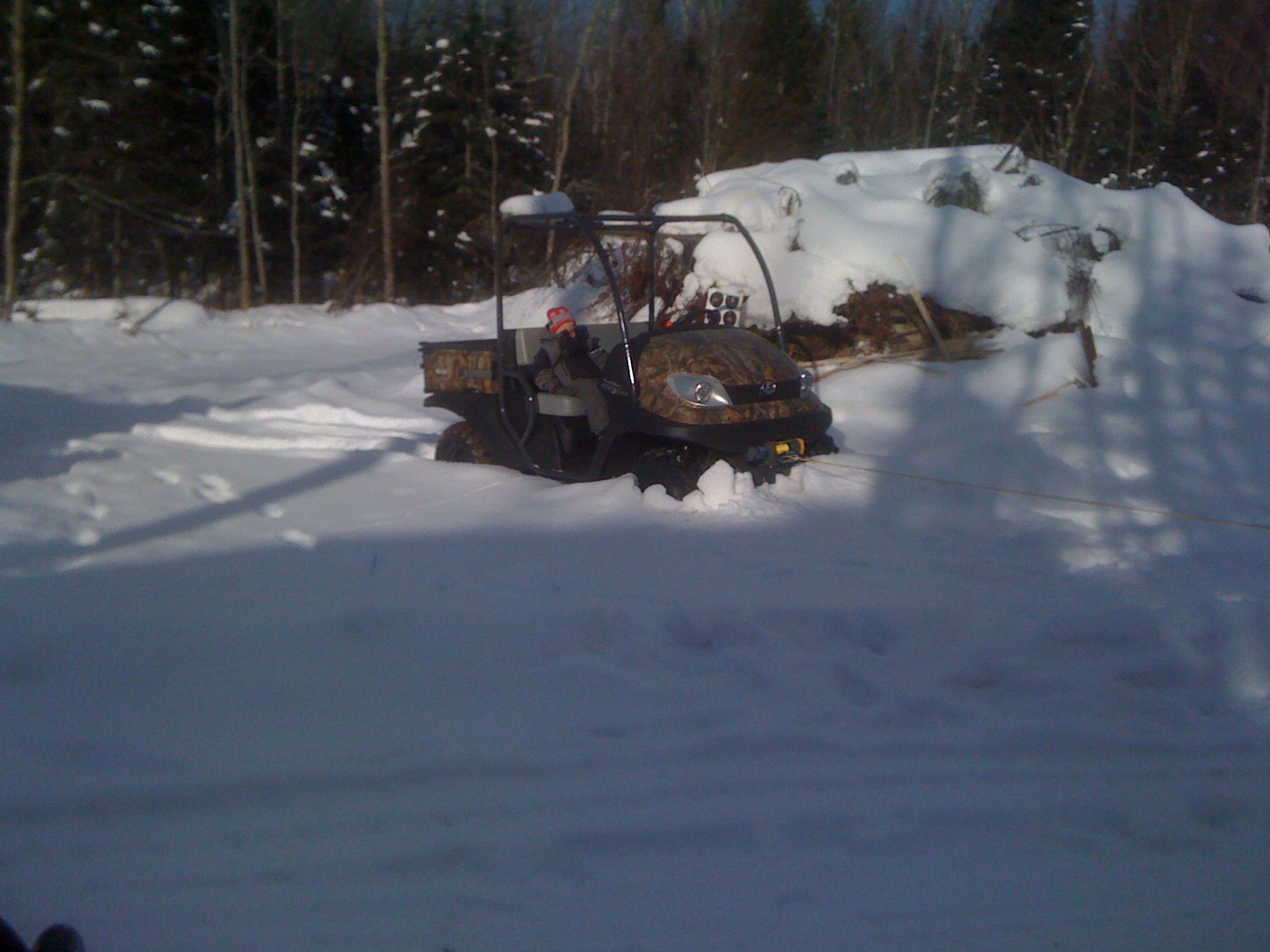

Well, I sure took me a while to get this thing stuck somewhere. I'm impressed, even if I couldn't go forward if I backed up and took a run at it I always got out. When I finally did get stuck I shouted "alright, we're stuck!" to which my little boy replied "we wanted to get stuck daddy?":laughing: some day he'll understand.
winch worked great, little stiffer to free spool out then my warn A2000 was but I love the rope over twisting metal cable. More stretch though but it pulled it out in N. Really low gearing.
Does the hydro in neutral still have pressure on the drive train? I felt like I was winching against some pressure in N. With it in drive the winch was barely needed as an assist, I was just playing with the winch.

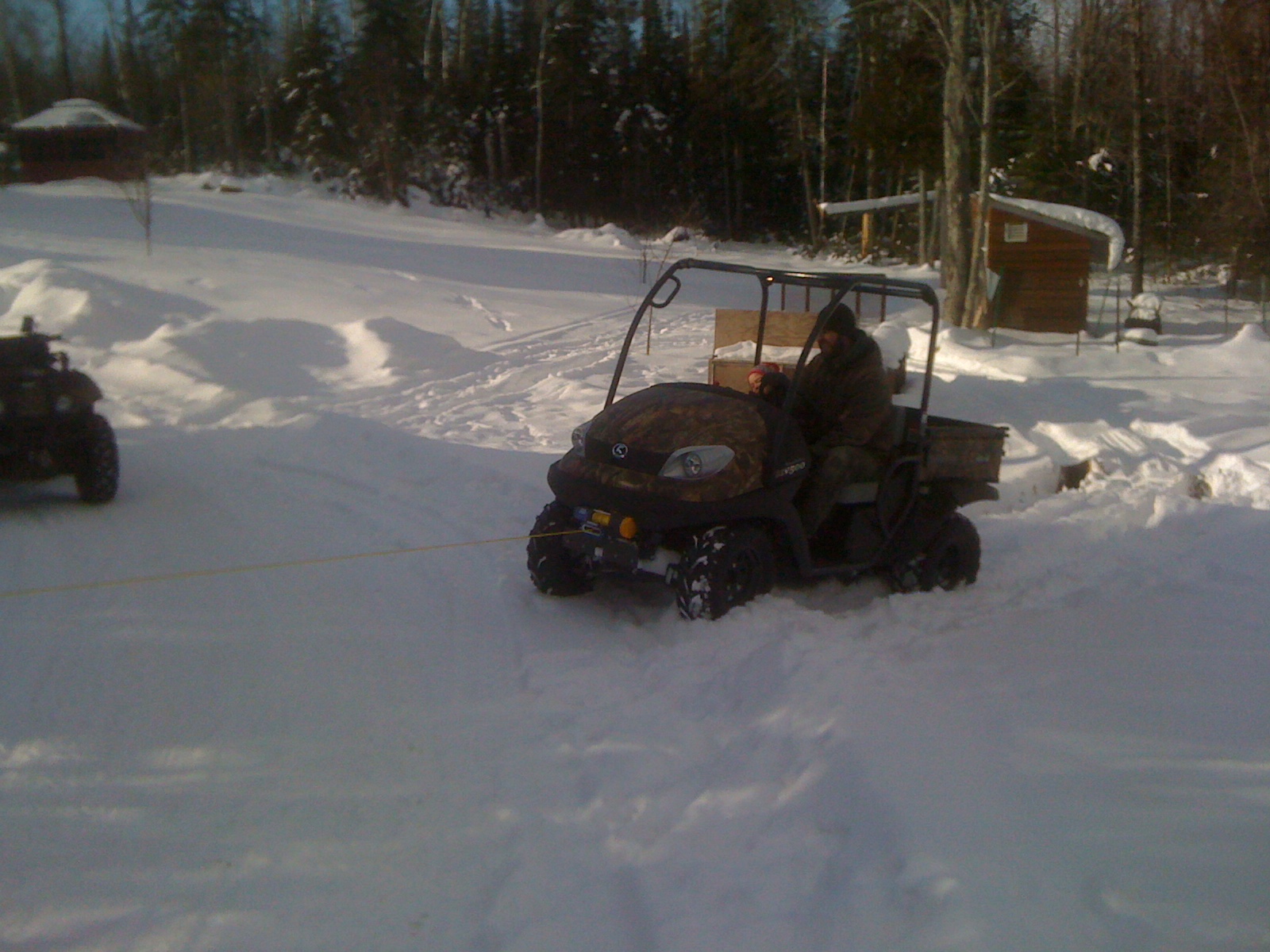

Here I found out first hand how mislead I was about the 4wd and lack of locking front end:mad:
Set the parking brake and Got my brother on the Big Bear in N out of a small ditch with ease
Sorry about the pics, on my computer they are right side up but here they are upside down and I can't rotate them:confused:
**ALL FIXED, found a way to rotate of this site's uploading.
