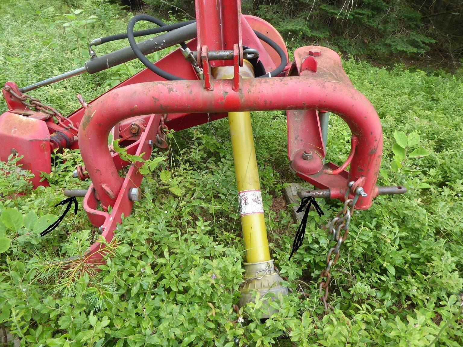

I could not find the manual using that link but I did find one elsewhere. I bought a model 394 but am having an issue with it fitting onto my Kubota 3000 tractor. The bar that interacts with the chains at one end is dangerously close to the right rear tire. Any adjustment to the left causes the sway adjustment link on the left to rub the tire on that side.
Now I need the owners manual so I can properly setup the mower.

I suspect you will be disappointed in the manual because the mower is not easy to mount on the 3ph and the manual is vague at best. here are the pages on mounting ang running the mower.
I run my mower on an L3010 30 hp tractor. The 3ph is narrow for it. My mower has two pins for the left lower lift arm - I use the inside one to avoid the problem you noted. Black arrows are the ones I use
I run it with a small side ways angle on the top link and drive shaft but it has not hurt any thing and keeps the tires safe. The angle is limited by the chain hanger that goes over the top link.
