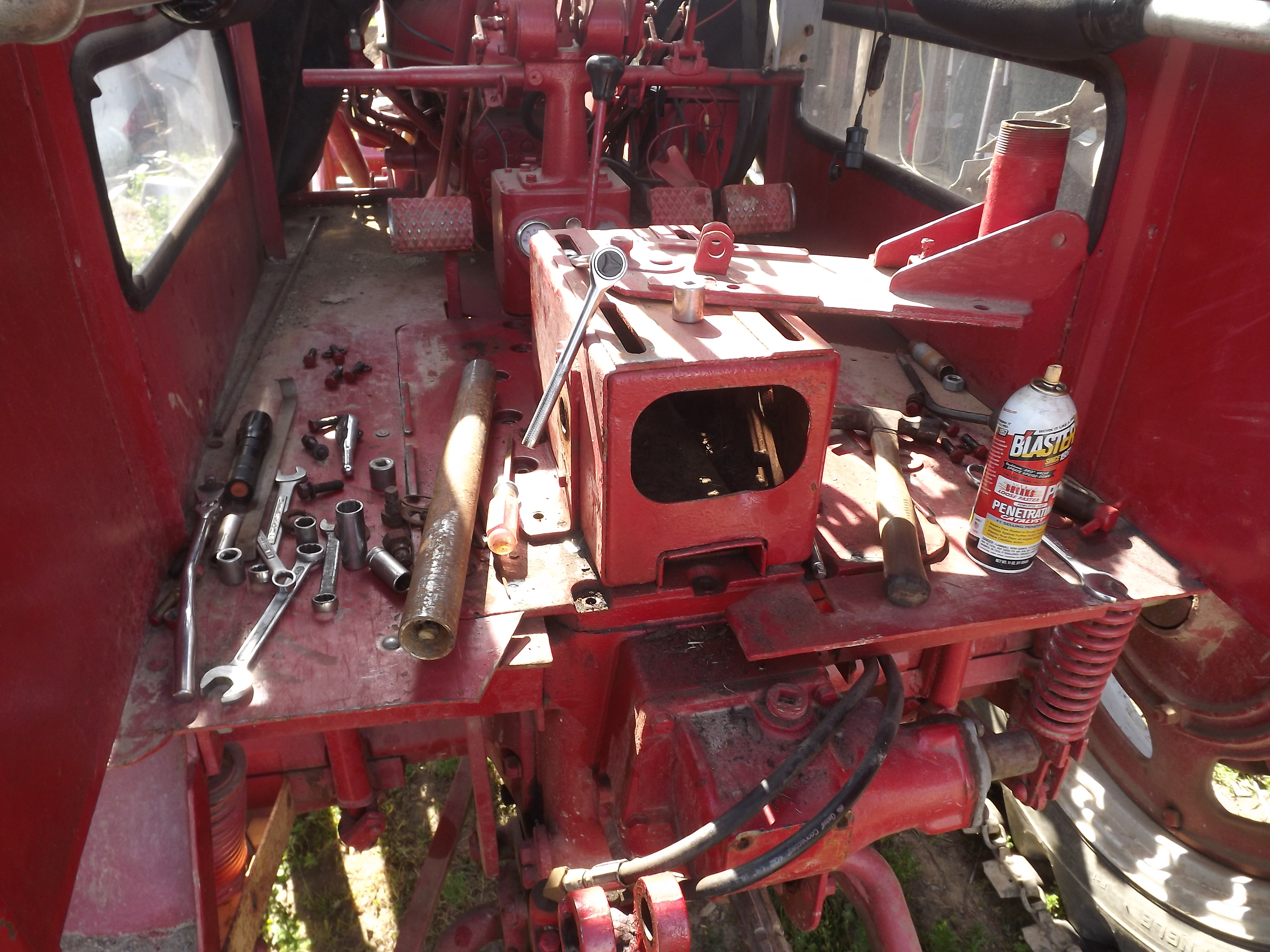

Well it's mid afternoon and i managed to take my truck and pull the tractor back up to the shop and started stripping stuff out of the way and got all of the bolts loose except to two rusted ones in the front of the toolbox inside and started spraying rust buster on them every hour till i'm satisfied they are soaked good, then in the morning i'll try to tighten them slightly then if need be toast them with the torch then try to back the nuts off. Then i'll see what's going on. Hopefully it's just the lock nuts have backed off the gear and it moved out of position.DSCF4638.JPG

just one quick question if there is anybody still out there...is there anything else like the shifter that needs to come off before i can get the transmission cover off? I Have all of the bolts out including the ones inside the steering pedestal. but it is hanging up on something when i pry up slightly in the back. I Don't want to pry up on the cover too much because it might snap in two. That would e my luck. I Could see inside with a flash light and the bull gear is in place and looks o.k. but without getting the cover completely off i can't tell.
/ Super C transmission gone out? #8
I've never had the cover off the Super C's, but have taken one off a H. Pretty sure there are dowel guide pins in either the cover, or diff. case. That's been 35 years ago,so... Anyway, it will have to come pretty well straight up. Not nearly as heavy as one on an H, or M, but probably still a pretty good chunk.

Well i finally was able to get the cover off of the trans. and saw the right bull gear laid over with a sheared off axle chunk clinging on. So now i have a ton of work to do to get the axle housing loose. sheesh. All of the half track equipment has to come off. A ton of work for me. Oh well...gotta do it.

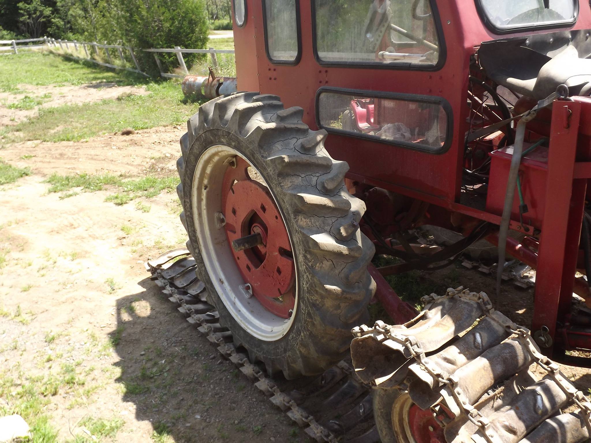

Actually they save the tires a lot of wear and tear. Believe it our not there is no vibration.
/ Super C transmission gone out? #13
I just saw those big cracks between the bars on the tires. Looks like it's pulling the tread, right off the casing.
#14
They are the original tires best i can tell and i don't doubt they are due to fail but they still make new ones and i have two waiting when they decide to "retire" .
