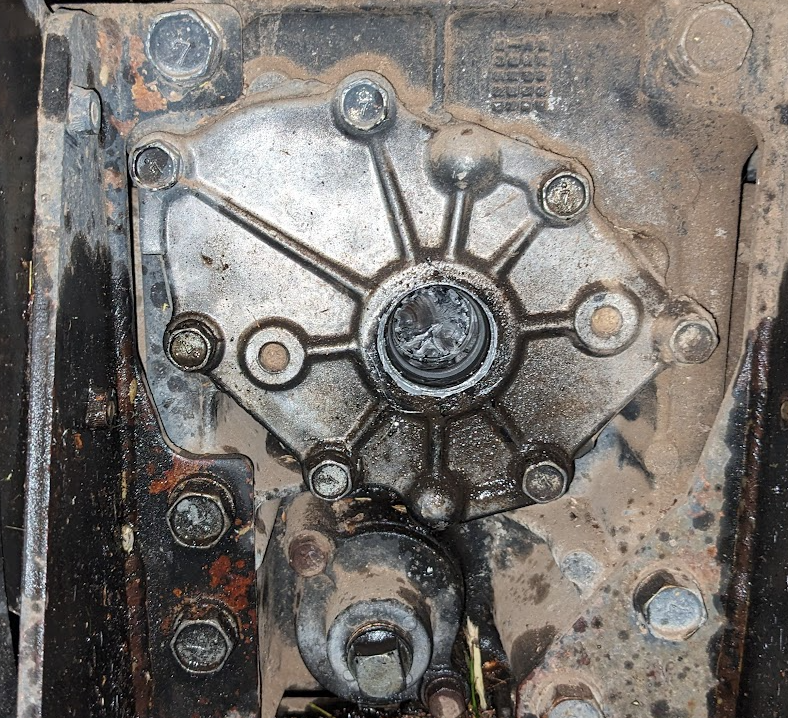

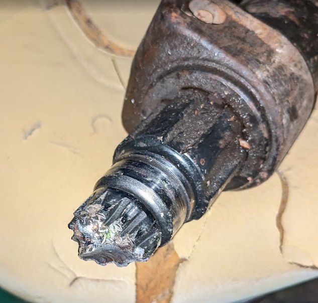

I need a PTO shaft for a deere 4100 cut. It sheared off just inside the case. I haven't opened the case up, so not sure if I just need a shaft and seal, or maybe more.

The JD parts manuals are available online.
The rear pto shaft was M807623 but has been replaced by LVU800637.
It is used on 4100, 4110, 4115 with hst transmissions.
I like to use tractorhouse to see what salvage yards
Why did it break is the first question I would be asking. If it is the tractor with 600 hours in your other thread that would suggest it was not wear and tear.. If it was due to an accident or abuse I would replace the bearings as well. No matter what I would replace the seals.
   / Suggestions on where to get used parts #4
I'm not sure I've seen a sheered PTO output, although the one on my Massey Harris is bent and will need to be dealt with sometime.
Perhaps too short of a PTO shaft and either an side force from turning, or raising and lowering the implement?
