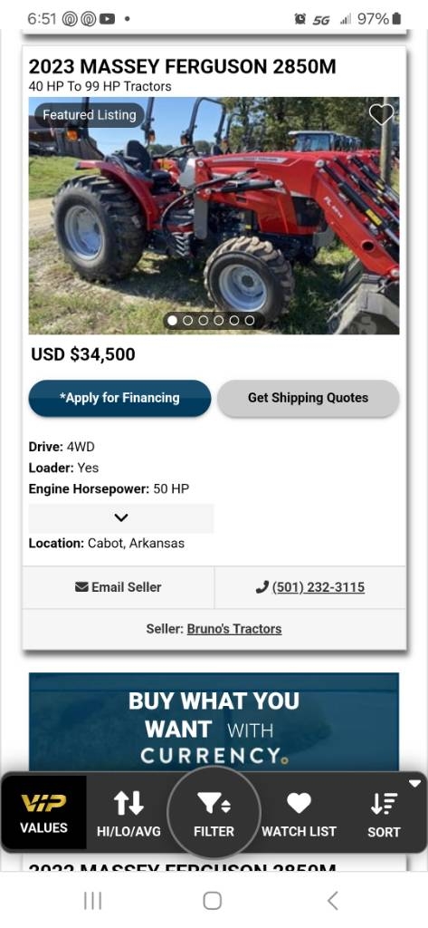

Massey Ferguson 2850/2860M Power Shuttle, if you can afford it. Now, I'll admitbi haven't read every single post, but glanced over the first dozen or so. The $30k budget is pretty limiting, but if you can scrounge another $5k, here is a fantastic, new, power 4 brand machine, with a lot of utility, while also having some of the nicer things.

Some of the newer Massey's are TYM's as well btw although it looks like the 2850/2860M are Agco/iseki (japanese motor anyway). That does look like a really nicely spec'd tractor as well.

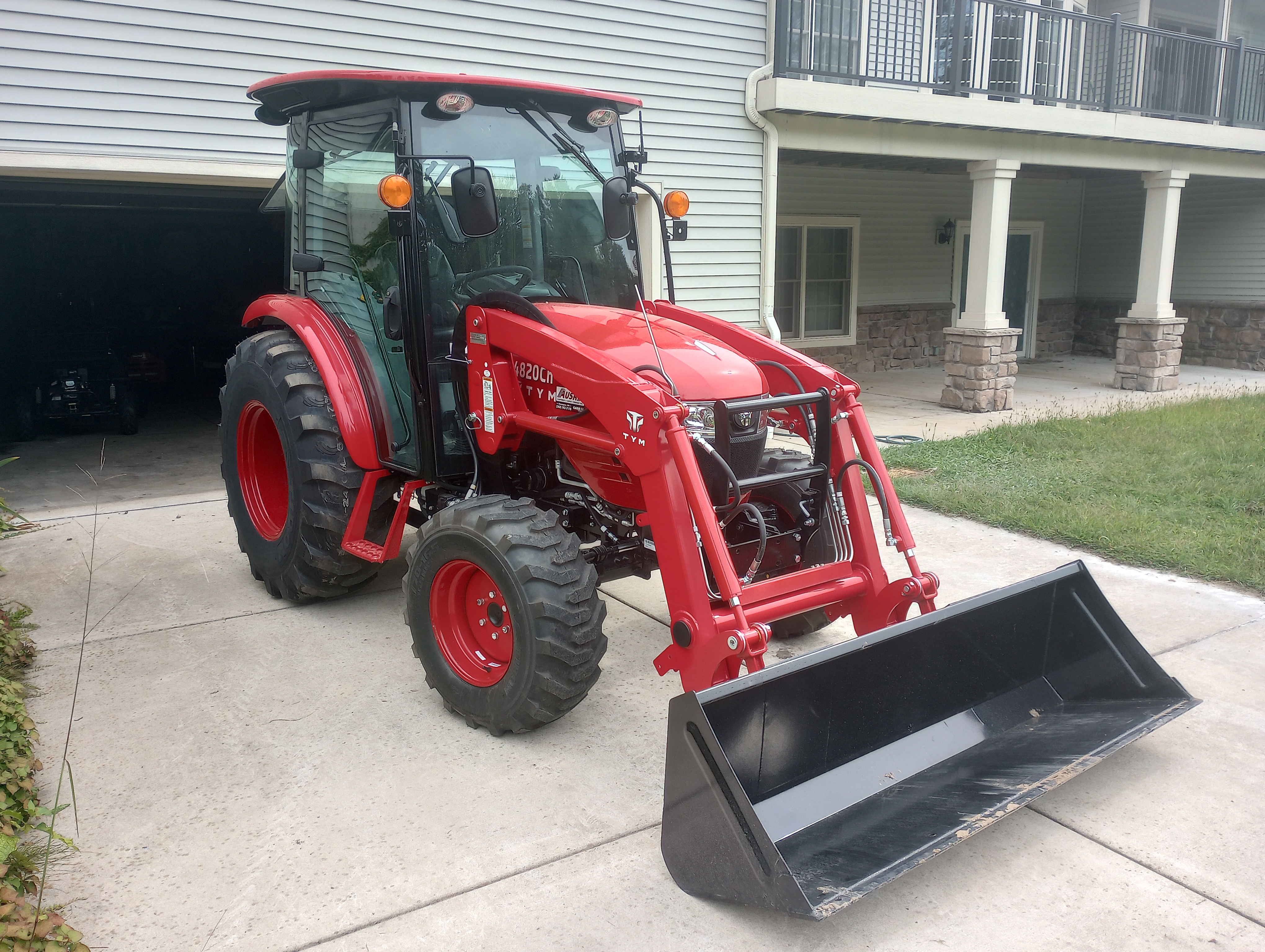

Got this 4820CH in 2023. So far very happy. I paid $29,500 check, but now I think it's a bit more. Same as 5520, just no turbo.
If you want a cab, that is it. Old Branson design, pretty heavy build (over 5,000 lbs). No electronics, no sensors, old school Bosch mechanical pump. If you take off emissions garbage, engine won't notice.
2,700lb loader lift. Heat, a/c, radio, Bluetooth in cab. Only tractor that I know of with 4 speed hydrostatic transmission (everything else is 2 or 3 speed). Two standard rear remotes. Telescopic 3 point is standard. Front and rear wiper, work lights all around, doors on both sides. All standard.

Do you mind me asking where did you purchase your Branson 4820CH Stoyan79? That is a very good buy.
