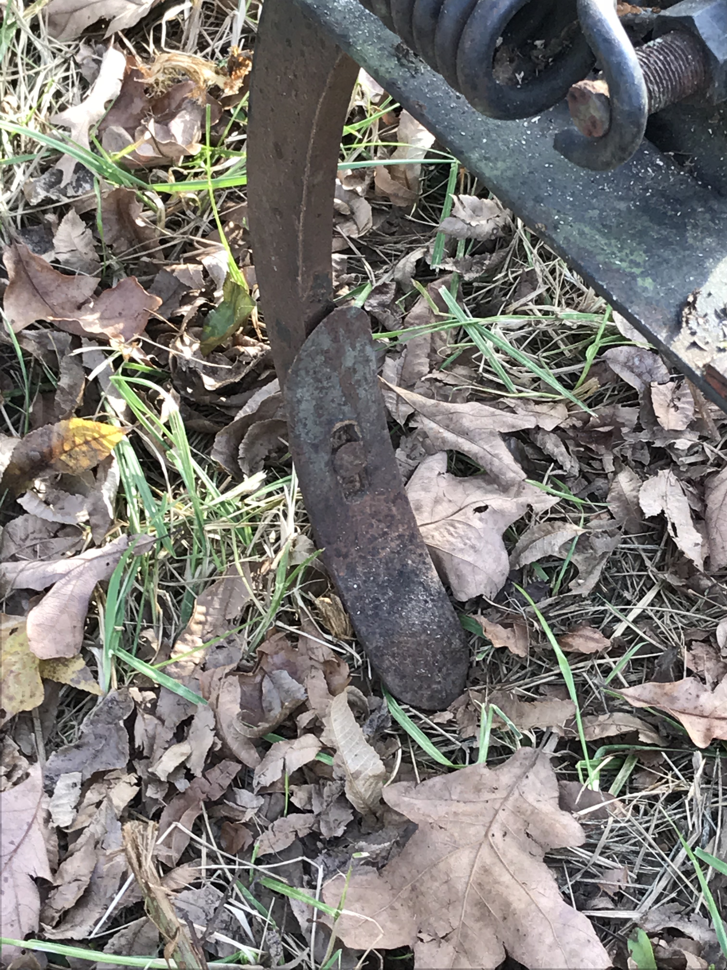

Im not sure what the stock blades are but they do not appear that much wider than the shank.

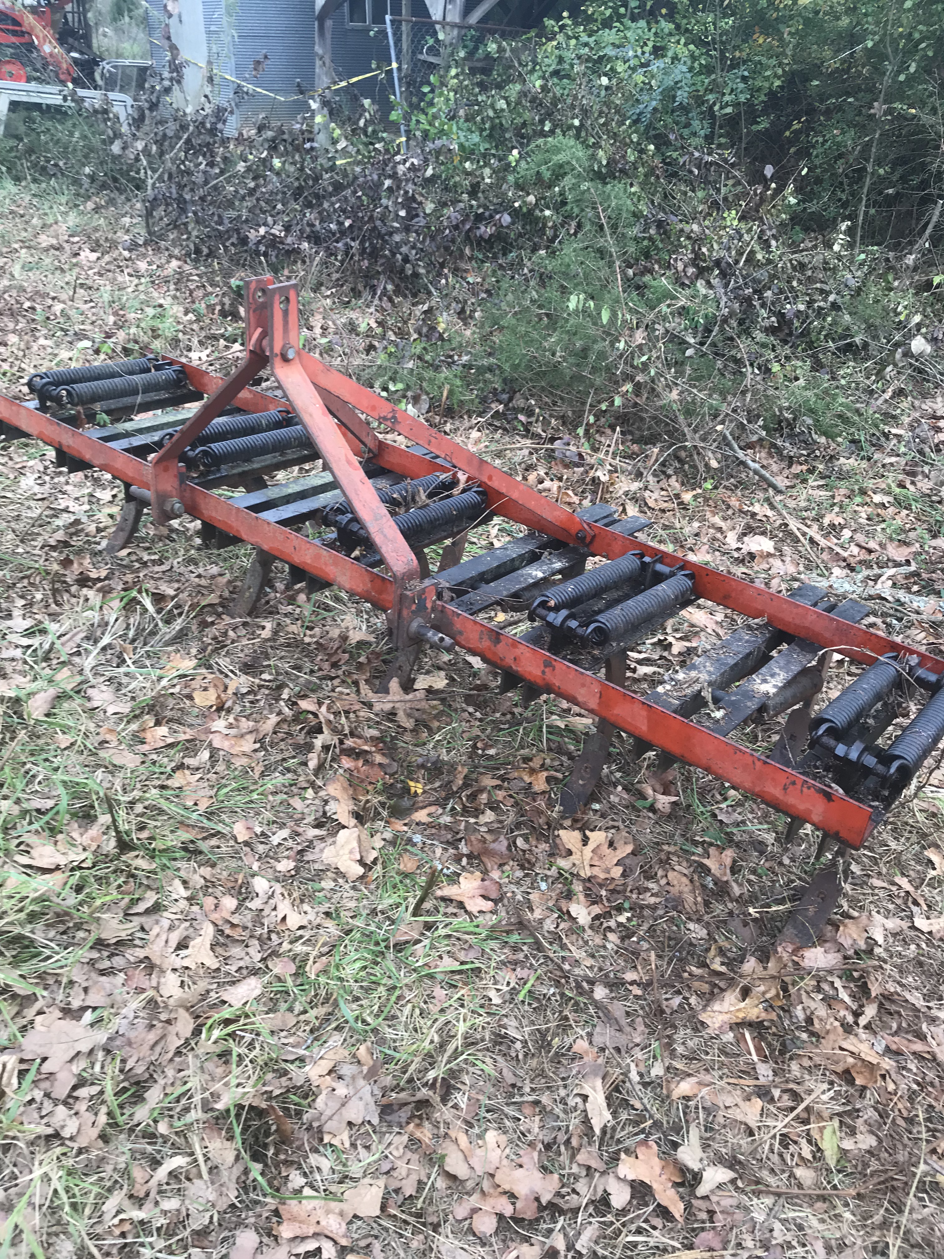

How about this idea... I set it up with only three shanks?
One leading (forward) shank behind each rear wheel at about 5 foot wide. And then one center trailing shank in the middle.
If that does not pull very well then I abandon the whole idea of using it and resort to just selling it and buying a single shank Sub Soiler. There would be no point in keeping it if it did not work with at least 3 shanks. The advantages of a single certainly take over at that point.

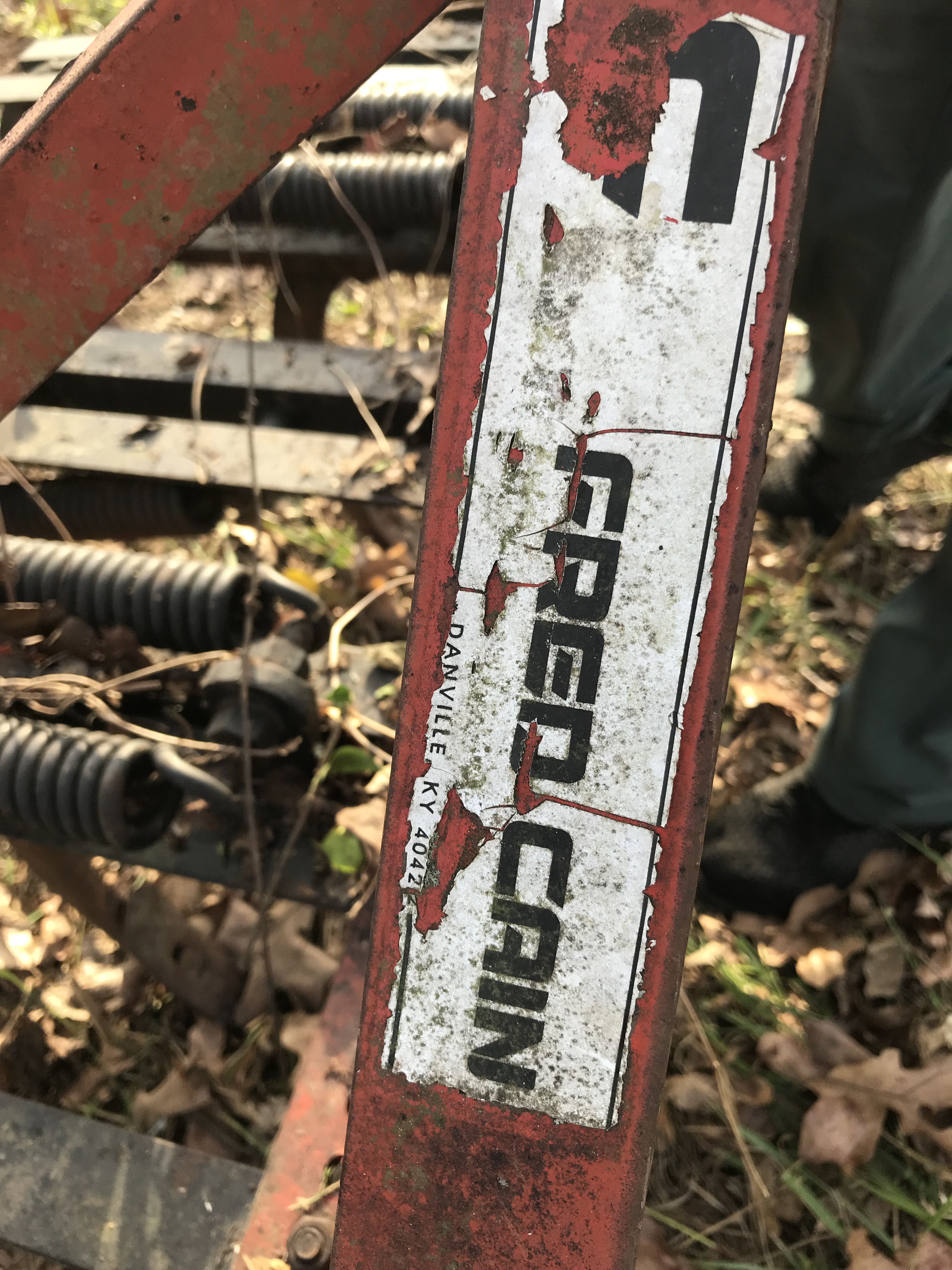

Here are some pictures of what I am dealing with.

In heavy clay I think three shanks is all you will be able to pull 8" to 12" deep.
I own a Field Cultivator and a Subsoiler. Pulling three (3) Field Cultivator tines requires about same power and traction as a single Subsoiler shank. Field Cultivators pull easier than Subsoilers due to horizontal orientation of points, which slip through soil easier than a blunt Subsoiler shank at 45 degrees. If you have considerable rocks, a blunt Subsoiler is ultimately the tougher of the two implements. I use my Dirt Dog Field Cultivator more often and far more hours, than my Subsoiler.

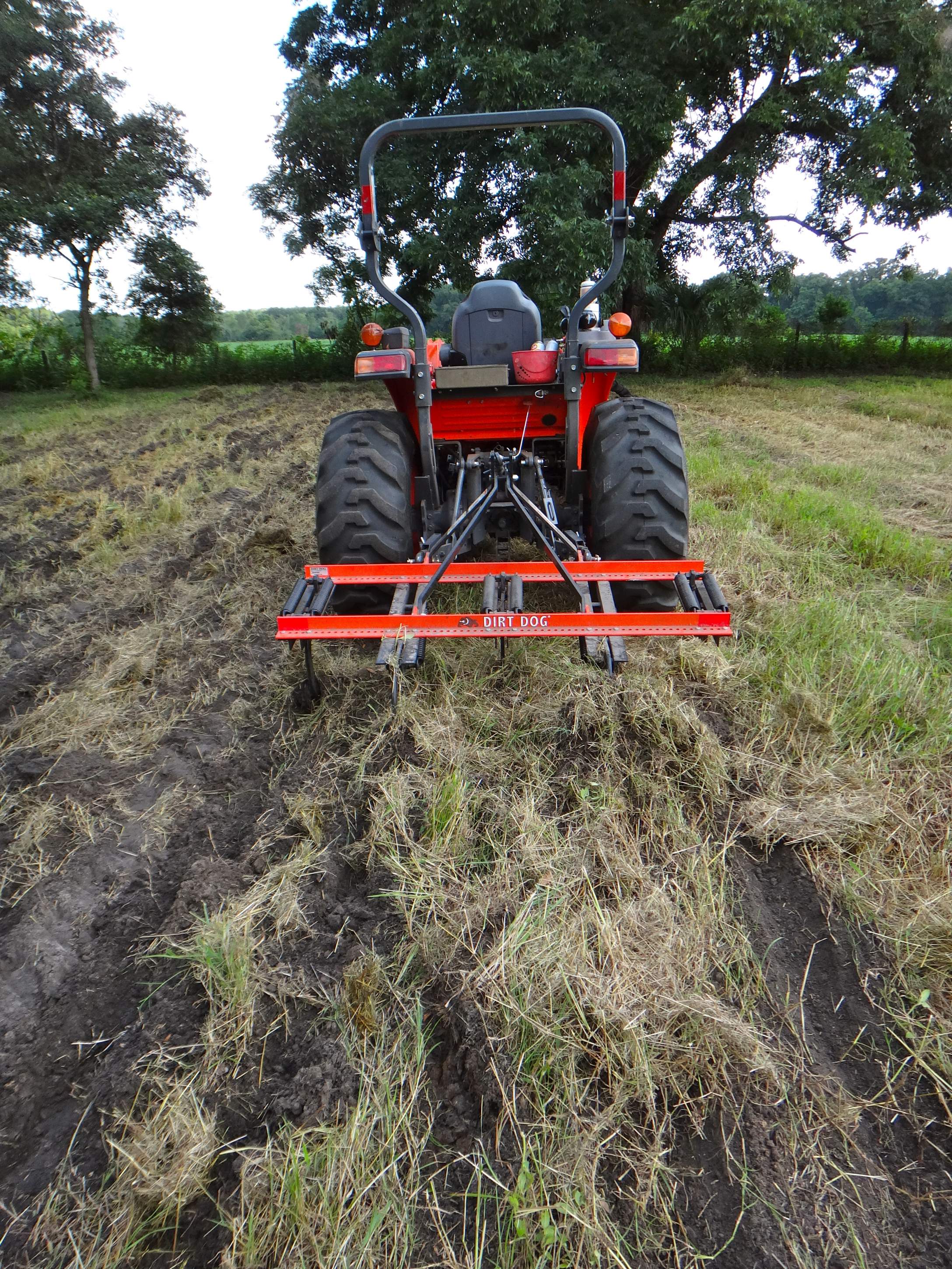

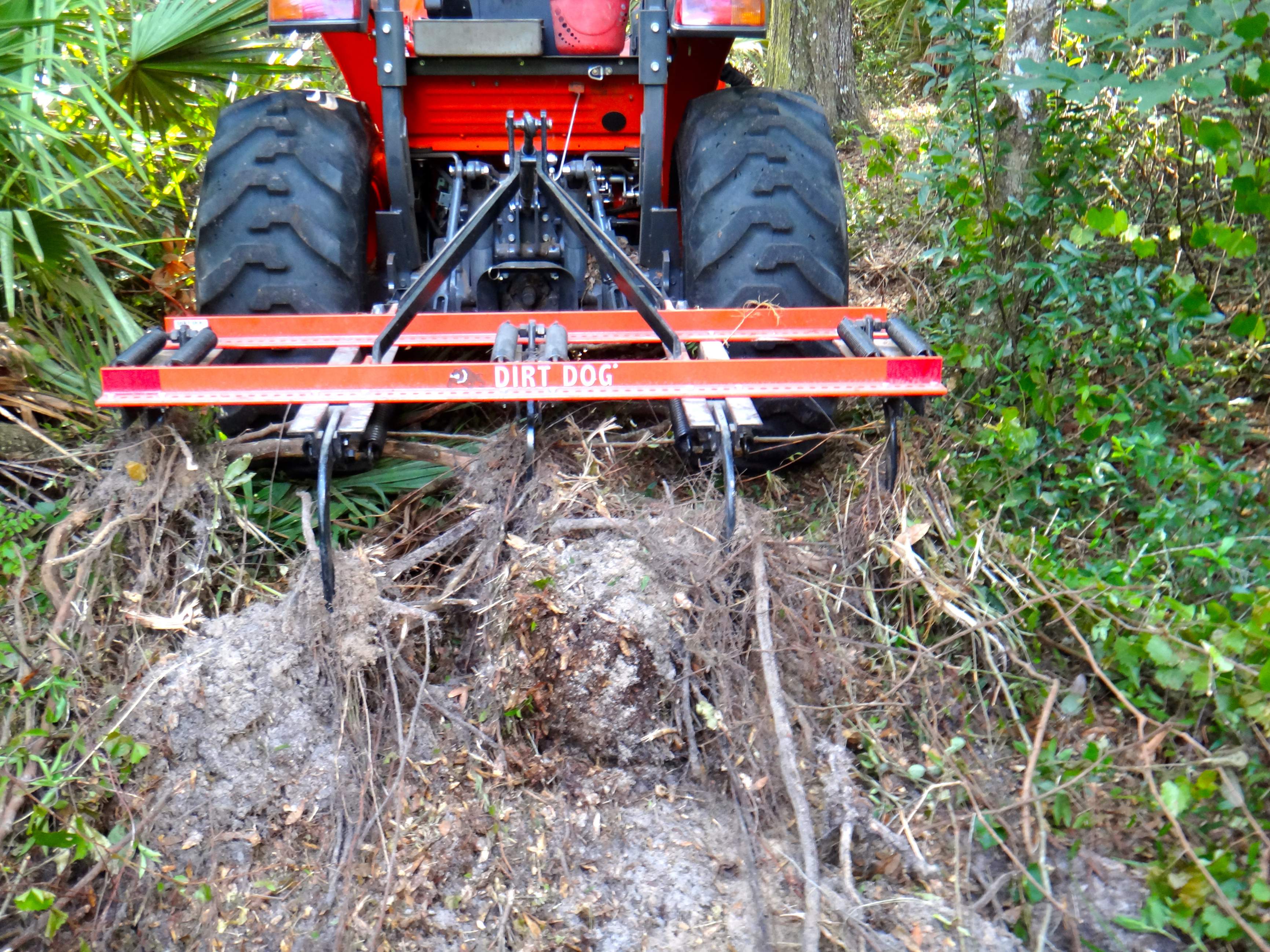

I use Dirt Dog's (brand) iteration of a Field Cultivatortor regularly. The Fred Cain Field Cultivators are built a tad heavier than the Dirt Dog. My neighbor has a Fred Cain nine shank which he pulls behind a 45-horsepower, 4-WD John Deere. Sandy loam here in Florida.

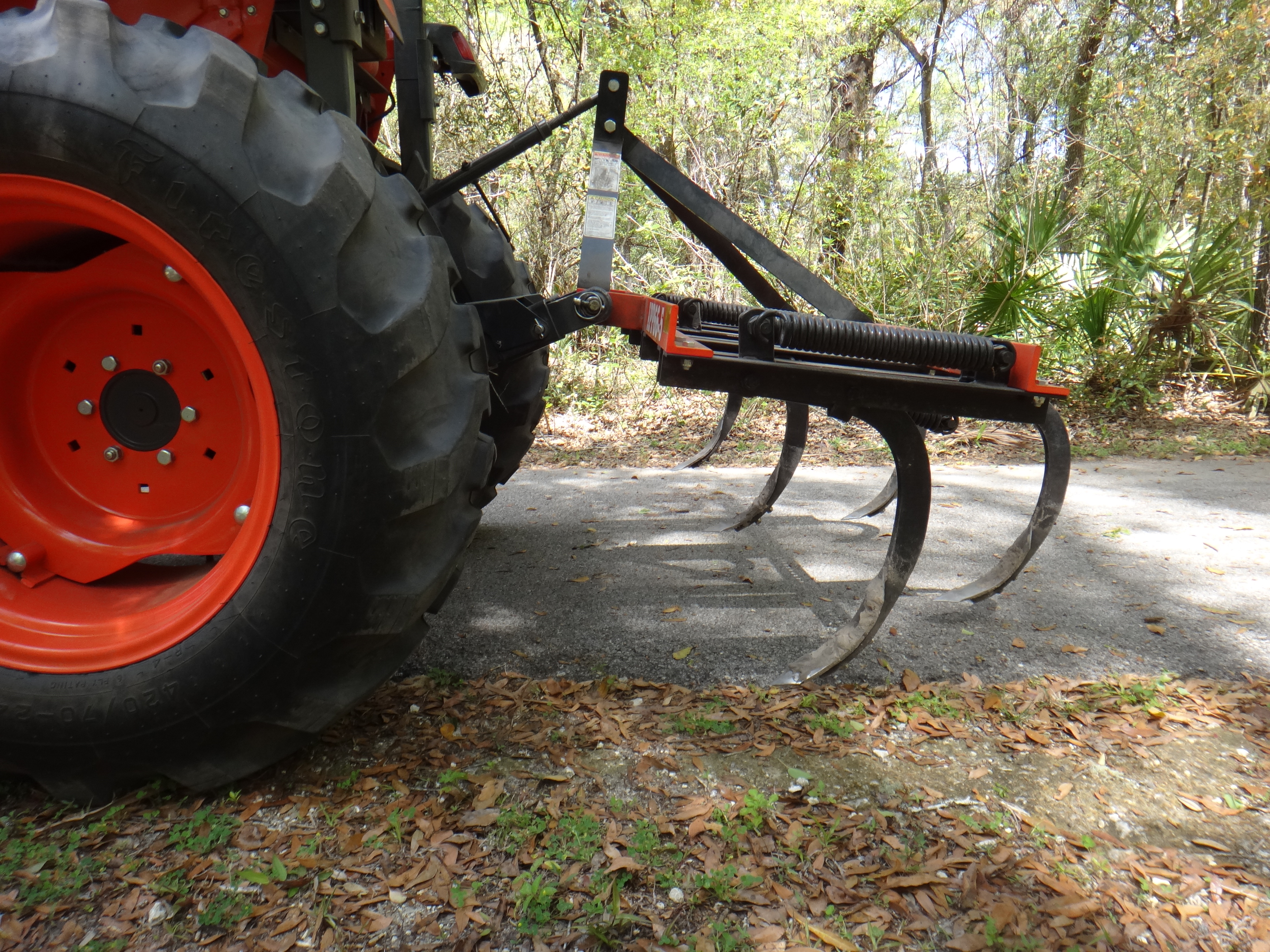

My neighbor paid $475 for his Fred Cain Field Cultivator, used, in about the condition of yours, after we watched it on Craig's List for two months. I like this tough, versatile implement but they are a mystery to most.
http://www.tractorbynet.com/forums/attachments/374012-field-cultivator-7-wide-craigs.html?highlight=
My Dirt Dog sinks into everything except packed pasture if the soil is MOIST. It works fine for food plots, which require three passes for initial seed preparation.
LINK: http://www.tractorbynet.com/forums/attachments/339095-dirt-dog-all-purpose-plow.html?highlight=

3 to start with is a great idea and figure on multiple passes in compacted soil. The price 400-500 price range sounds fair if the springs, anchor pins and points are all good. Ken Sweet

Trial was a success! I reduced it to 3 tines. I can't hardly tell its back there even in very hard ground. Doesn't miss a beat or even grunt. You'll see the springs really working in these pictures. So you know is grabbing some hard stuff. Pasture thats not been disturbed in over 30 years. But their isn't much effect on the tractor at all. Im running at about 2000- 2100 rpm here in 1st gear.
I ended up with one center forward tine and two trailing tines at about 5 feet apart because thats simply how they worked out by removing the other 6.
I have a video but not sure I can find a way to load it up.
For now here are some still photos.
