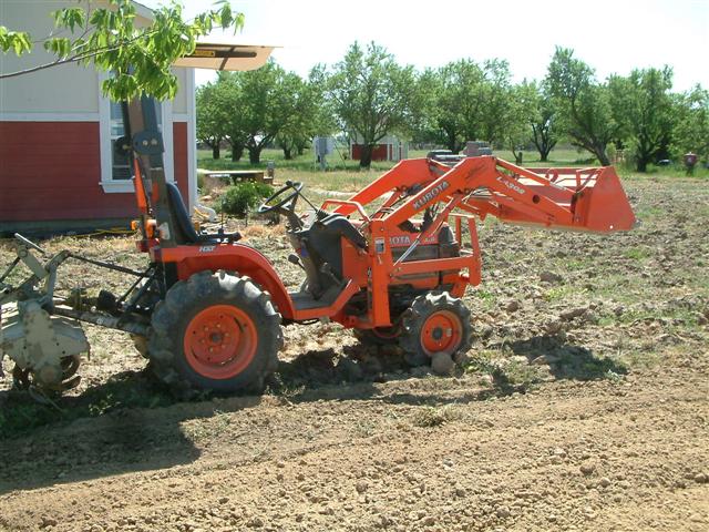

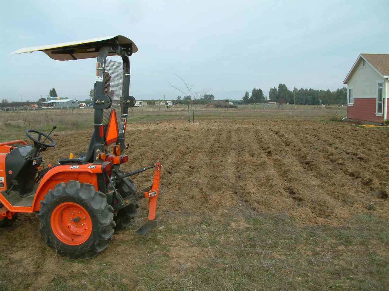

Before rototilling the hard soil in my backyard a few years ago, I plowed the ground with a middle buster and my Kubota B7510HST. That made the rototilling go a lot faster and lessened the wear and tear on the tiller.
The middle buster is a combo MB and subsoiler from Tractor Supply ($150 or so). Something like this might work for your project.
