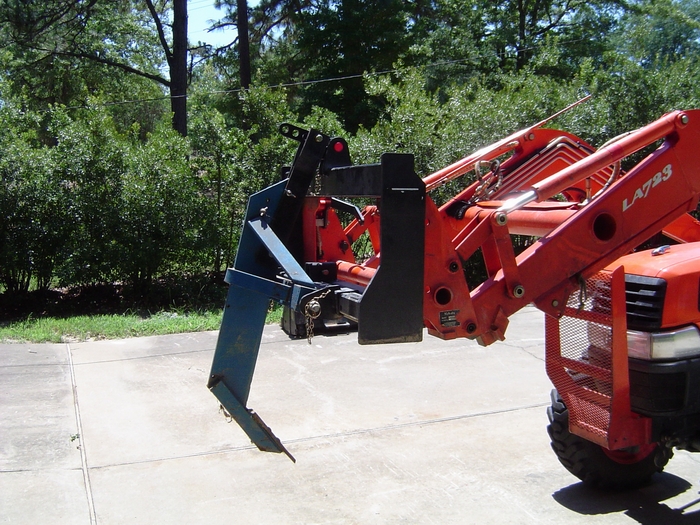

I have used mine with the 3 point attachment up front and loosened stumps up. I think it would work pretty good on back if you go slow and maybe have a little dirt in the bucket up front for ballast.
