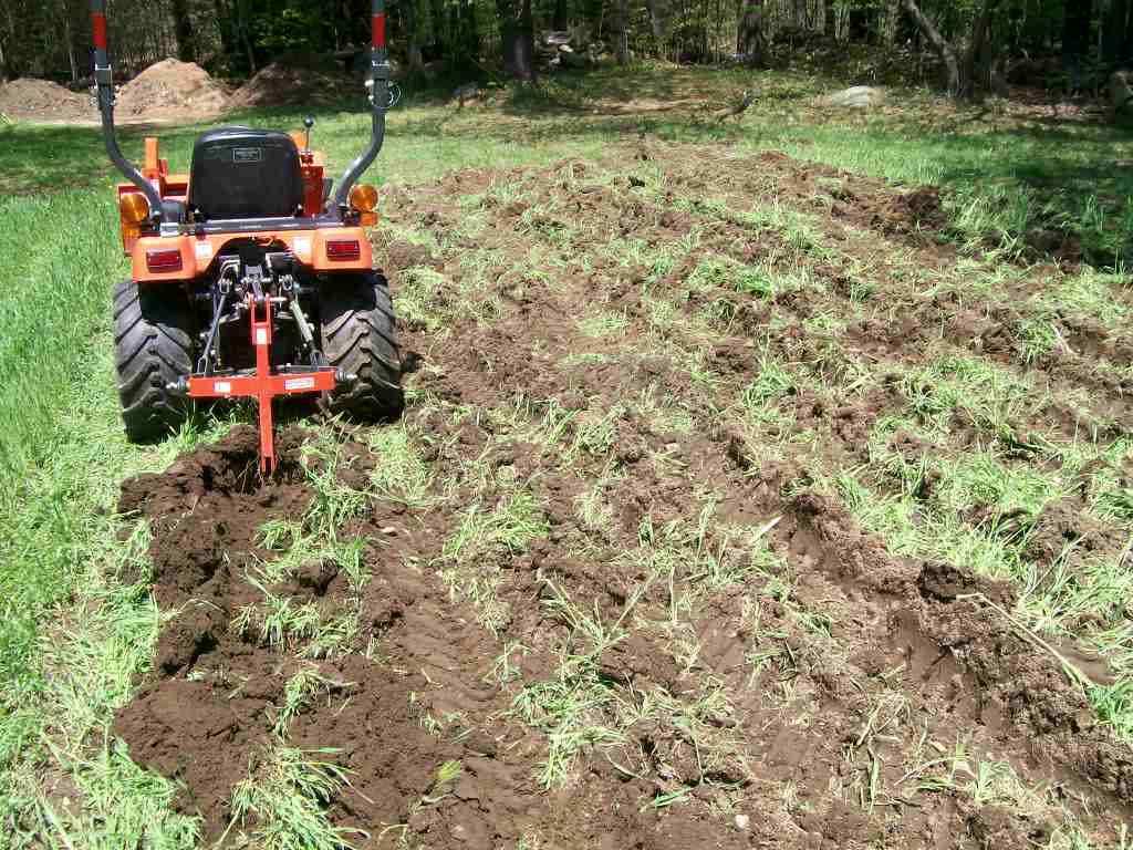

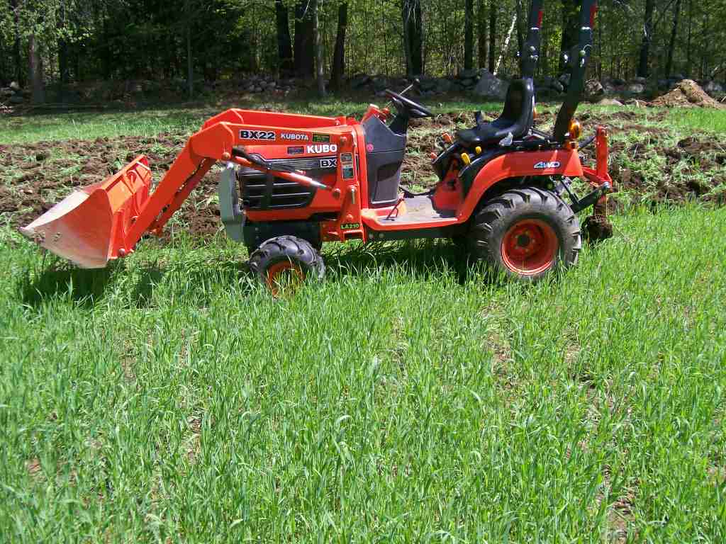

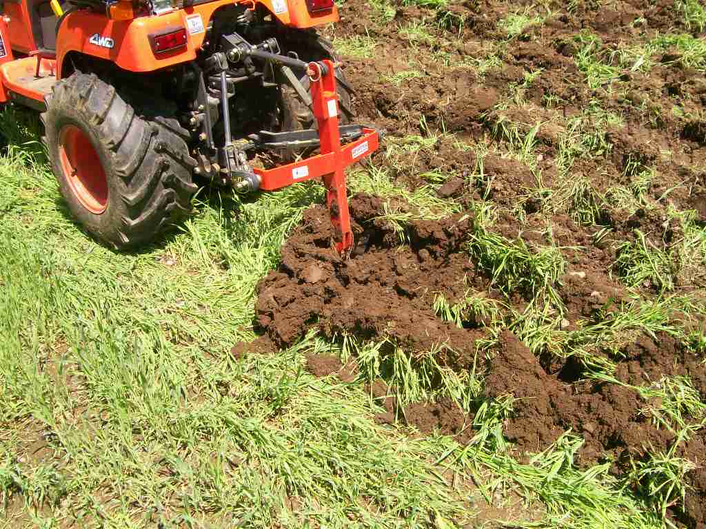

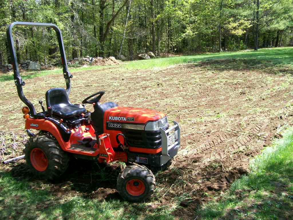

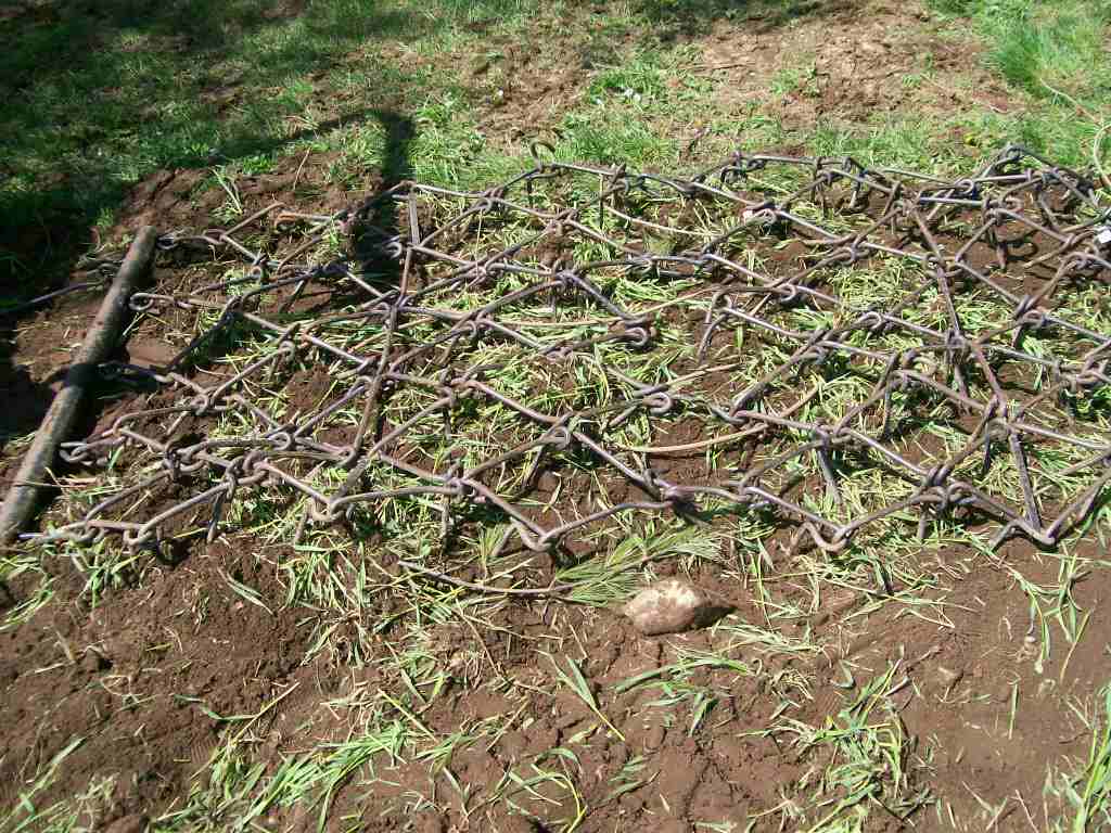

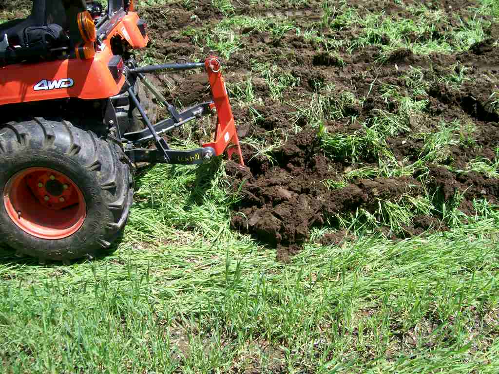

TSC has two sizes of middlebusters, and subsoilers. The XB, or subcut size is perfect for your 2210, and comes with both middlebuster, and subsoiler shanks. I'm not sure you can get down 8" but you might depending on how low your 3 pt arms go. You might have to take two passes. The full size subsoiler that TSC sells is too big to put on your JD, and I'm not sure I can get any ground clearance with my B2620 for transport. I have used the "XB" size on a BX22, and have attached some photos of it being used so you can judge how well it works. I also have the Countryline full sized middlebuster, and have used that both in my gardens, and to "hook" rocks out of my NH yard. I have rolled some rocks out that were perhaps 3' long with it though they were tapered, and not too thick. It worked very well for that, and I am going to either make a subsoiler type shank for it, or buy the full size subsoiler to give that a try. In the yard the subsoiler will make less mess, in the garden it doesn't much matter.

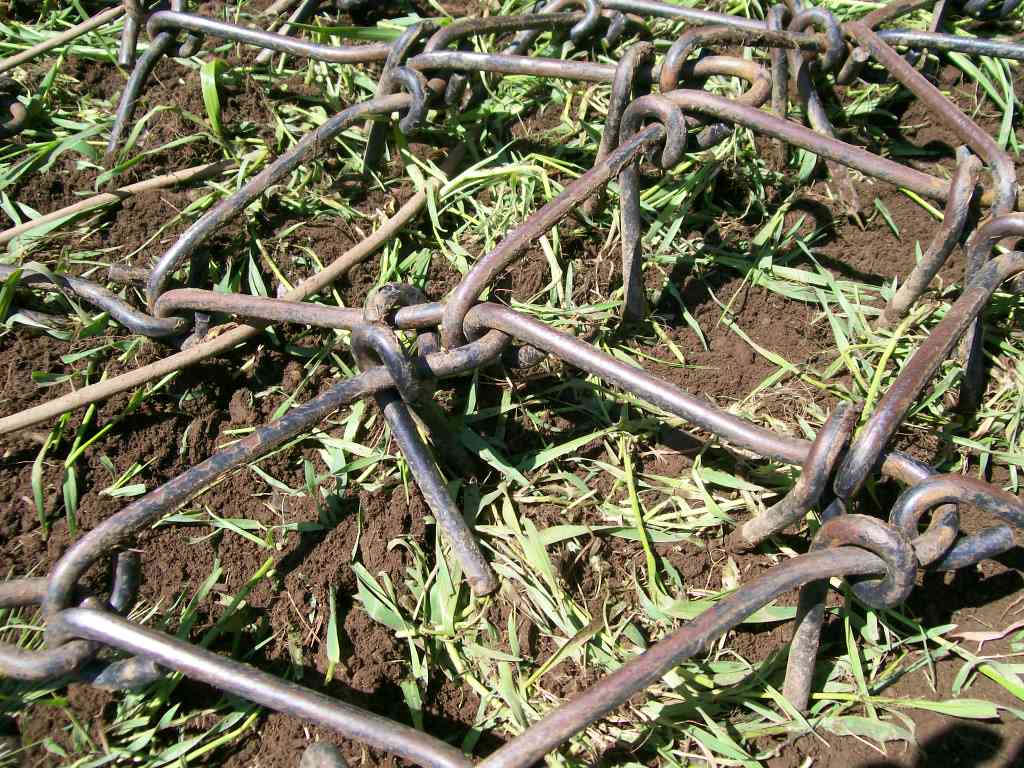

As you can see, playing with the top link length does affect how deeply the middlebuster goes into the soil. I was able to stop the tractor when I hooked large roots from surrounding trees, and rocks too big (read feet across) to move, but it did pull up, or move where I could get at them several pretty good sized rocks. It went deep enough to penetrate the "tiller hardpan" that was there when set right. As rough as the ground looks afterwards, I was surprised that it smoothed out pretty easily with my chain harrrow.
