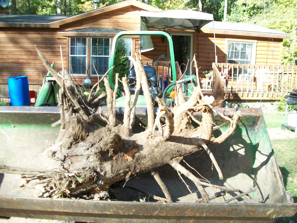

Has anyone used a subsoiler to remove small sapling ( up to 3 - 4" dia) stumps?
I have many small saplings surrounding the house that I'd like to remove. Using
the grapple has not worked well, as they tend to break off instead of uprooting
the tree in one piece. Trying to dig up the root system with the grapple just results
in my tires spinning. The tractor is a Bobcat CT335 with loaded rear tires and a
475 lb. boxblade for additional weight in the rear.
Consequently, I've been thinging about just cutting them down with a chain saw,
and removing the stumps by breaking up the roots with a subsoiler and then use
the grapple to remove the stump.
Any comments (pro or con) will be appreciated!

Yes sir. They work pretty well. I have removed a score of small stumps with mine. It works great on piss elms, which I am plagued with.
/ Subsoiler for small stump removal??? #4
I have removed quite a few with one on my little Super C Farmall. Cut the roots out a ways, then hooked them out. Mine is an IH built, Fast Hitch model, and has a tempered shank, and replaceable foot.
If you buy a subsoiler, buy a decent one. My buddy bought one at TSC, and put it on his 5400 Deere, and promptly bent it. More than likely why you don't see them at rental yards. If you do find one to rent, believe I'd get the insurance, just in case...

Have you tried a brush grubber? It works well if you leave a high stump to grab onto for leverage.
For that matter, for a 3-4" sapling, I imagine you could push it over with the front bucket hydraulics.
/ Subsoiler for small stump removal??? #8
I have used my home made sub soil tool as said to cut roots all around stumps to aid removal...
Also, like said, leave the stump 6 - 10" tall so you can get over the stump with the sub soil tool..
And have enough to hook a chain, cable, or other gripping tool to aid pulling out...
Good luck
/ Subsoiler for small stump removal??? #9
I've had good luck with a TSC subsoiler (the yellow one) pulling up to 6" stumps as long as they don't have big tap roots.
As DJ54 describes, cut the roots around the stump, then pull them out.
Cutting the stump almost to ground level helps, as a tall stump always seems to be in the way of either the subsoiler or one of the rear tires.

I noticed a cracked link in one of my chains last time I used it. I suppose it is good to inspect chains once in a while when grubbing stumps. I use my home made subsoiler to grub at roots. Little stumps of 6" or less I can get out easily enough. Last stump I grubbed out was probably 24-30 inches. That took a lot of time and a fair bit of axe swinging and hand digging. Actually the stump was too heavy for my loader but it cracked in two which was slightly more manageable.

I have an old fred cain and it it don't stop the tractor it will cut through. The ones that do stop it, I just move out farther and work my way back in. Seems to always get the job done with my 37 horse that is really only probably 30 horse after you figure in the HST.
/ Subsoiler for small stump removal??? #15
Subsoilers don't work well on trees with big vertical tap roots. But they can work on threes with shallow, horizontally spreading roots. So study your tree root patterns.
