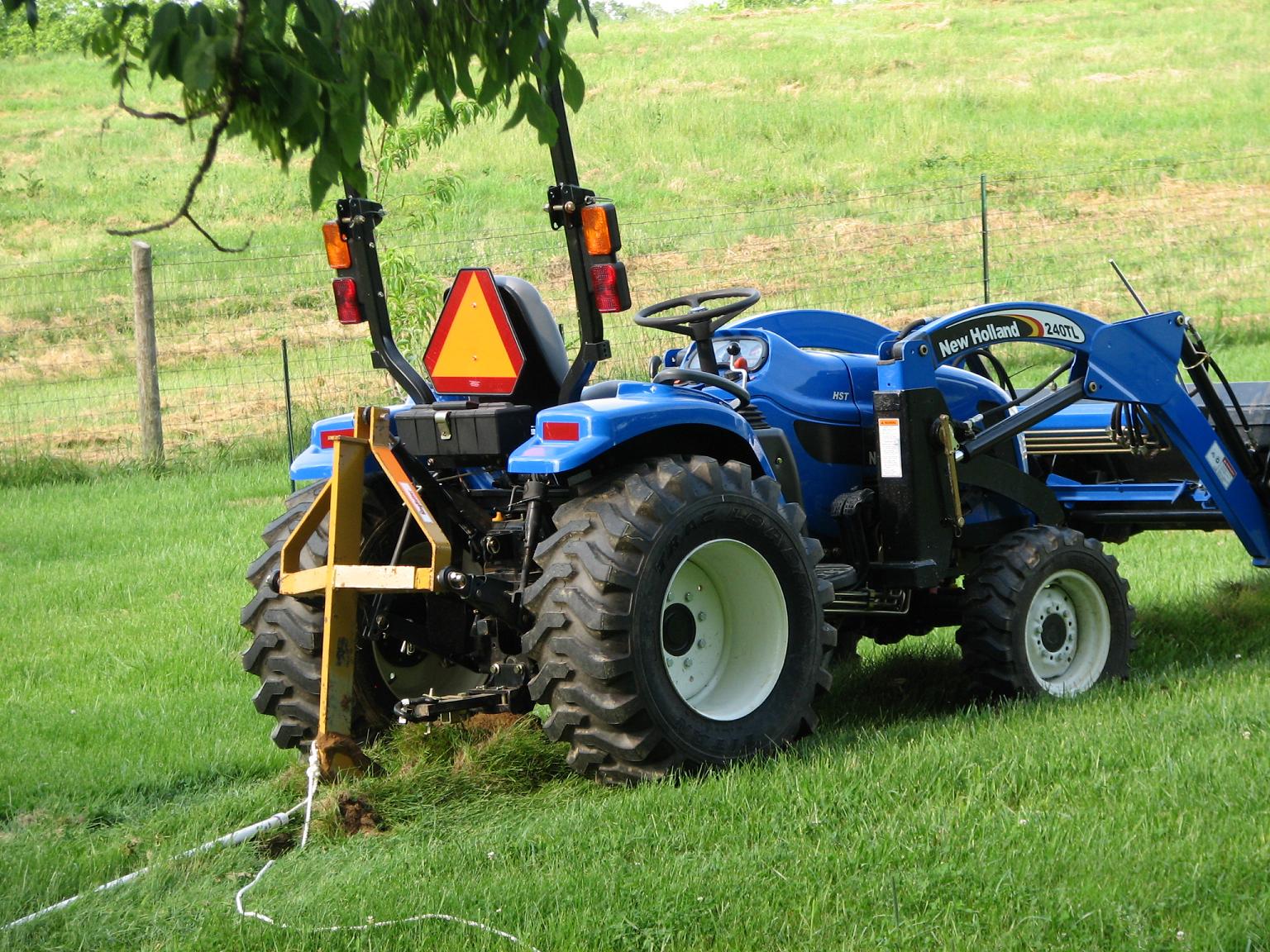

I have the same subsoiler on my TC31. With my three point all the way up I have about 1 inch of ground clearance. I tear up a little grass but for pulling pipe it has been wonderful.

I can not get a picture on here, but, yours looks just like mine, I measured from the lower pin holes on the 3 point hitch it is 24" to the ground and the subsoiler is around 27", It won't be easy but I was thinking of cutting the subsoiler half way down and drilling holes to make the height ajustable. what does anyone think of that ?
