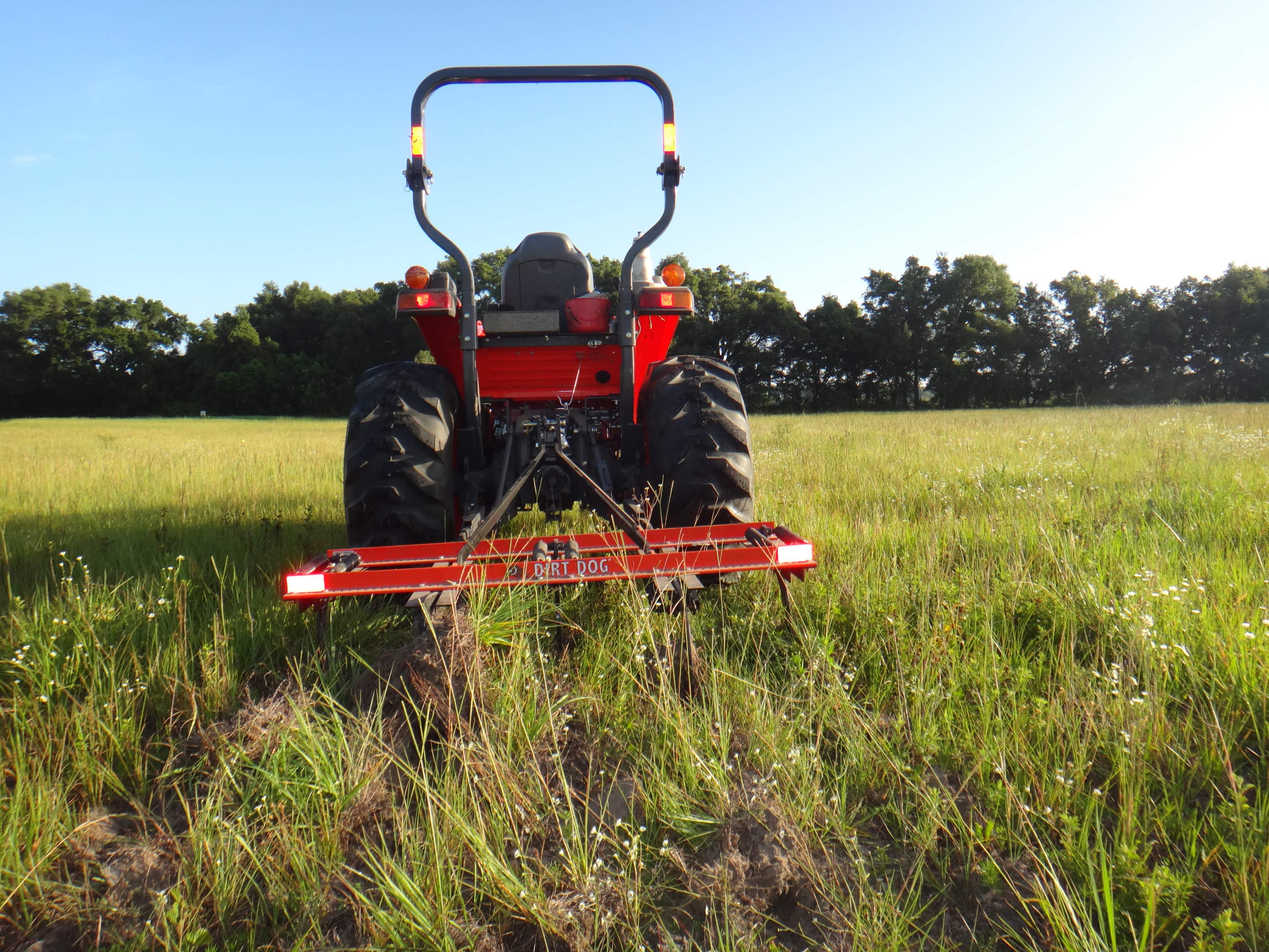

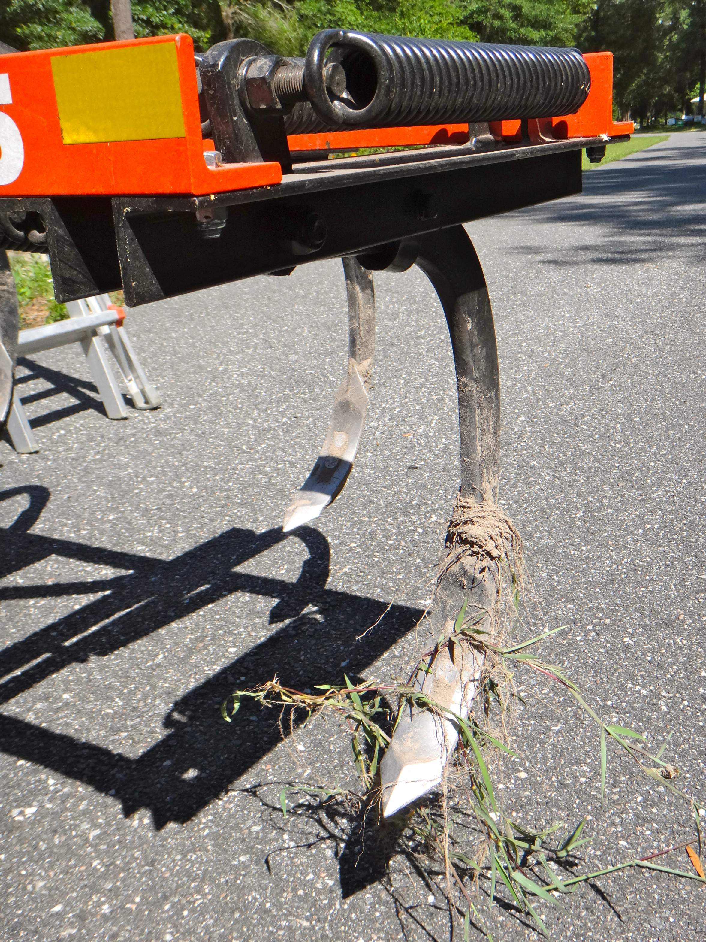

I have a five shank Dirt Dog (brand) Field Cultivator. Most Subsoilers are single shank. I can work ground five times faster with a five shank Field Cultivator.
You can do some row crop cultivating with a Field Cultivator. The chisel points are only 2" wide; pretty limiting. At present there are no cultivator sweeps available than will fit 1/2" shanks on Field Cultivators. (I have searched the US and Britain.)
Dedicated 3-Pt Cultivators generally have interchangeable sweeps/shovels either 4" or 6" in width, available to 9" in width. Cultivators are NOT built for the work you have specified.
I use my Field Cultivator hard. Spring protection of shanks is effective.
I have posted two Field Cultivator threads which may answer your questions. I pondered and researched two years before ordering a Field Cultivator.
The Field Cultivator was developed 1932/3 by Harry Ferguson, inventor of the Three Point Hitch. Is is one of the first four implements designed by Ferguson for the Three Point Hitch.
If you go with a Subsoiler you may weary of replacing shear bolts in your conditions.

   / Sub Soiler, Field Cultivator, or what? #3
As you can see from Jeff's pics, those things are pretty good at pulling up roots. I run on on sod before tilling new garden areas. Not sure I'd want to use it as my primary tool to pull up soccer ball-sized rocks. They're common as dirt at auctions around here. I picked mine up for $75. Jeff, for a while I used mine double duty as a garden cultivator. I walked into the local Rural King with one of the points, found some 4" sweeps with the same hole spacing, bolted them on, and it worked fine. Online, most vendors don't specify hole spacing. I now use a garden cultivator with a little more vibration in the shanks for that.
