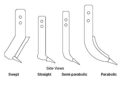

I got a 1x6" chunk of AR400 today for my sub soiler shank and now the question is whether or not to bevel the leading edge above the tooth or leave it flat?
Does it make any difference?

I don't believe it would make much difference other than weakening the cross section slightly. The soil is going to be fractured anyway when it reaches up that high on the shank. The soil, if damp enough, will build up and actually form a v-shape on the front. Even in dry sandy soil I would think it would take a lot of acres to see any wear on the leading surface of the shank.
The greatest force will be down on the very bottom of the tip where even an inch or two of depth change will make a big difference in draft. I'm sure most of you folks are probably aware of some of this stuff.

To cut through trash, the sharpened, swept-back shanks are often recommended, if not using a coulter to cut through.

We sell the Fred Cain and Dirt Dog subsoilers and both come with the leading edge beveled. They will pull a little easier this way. Ken Sweet
