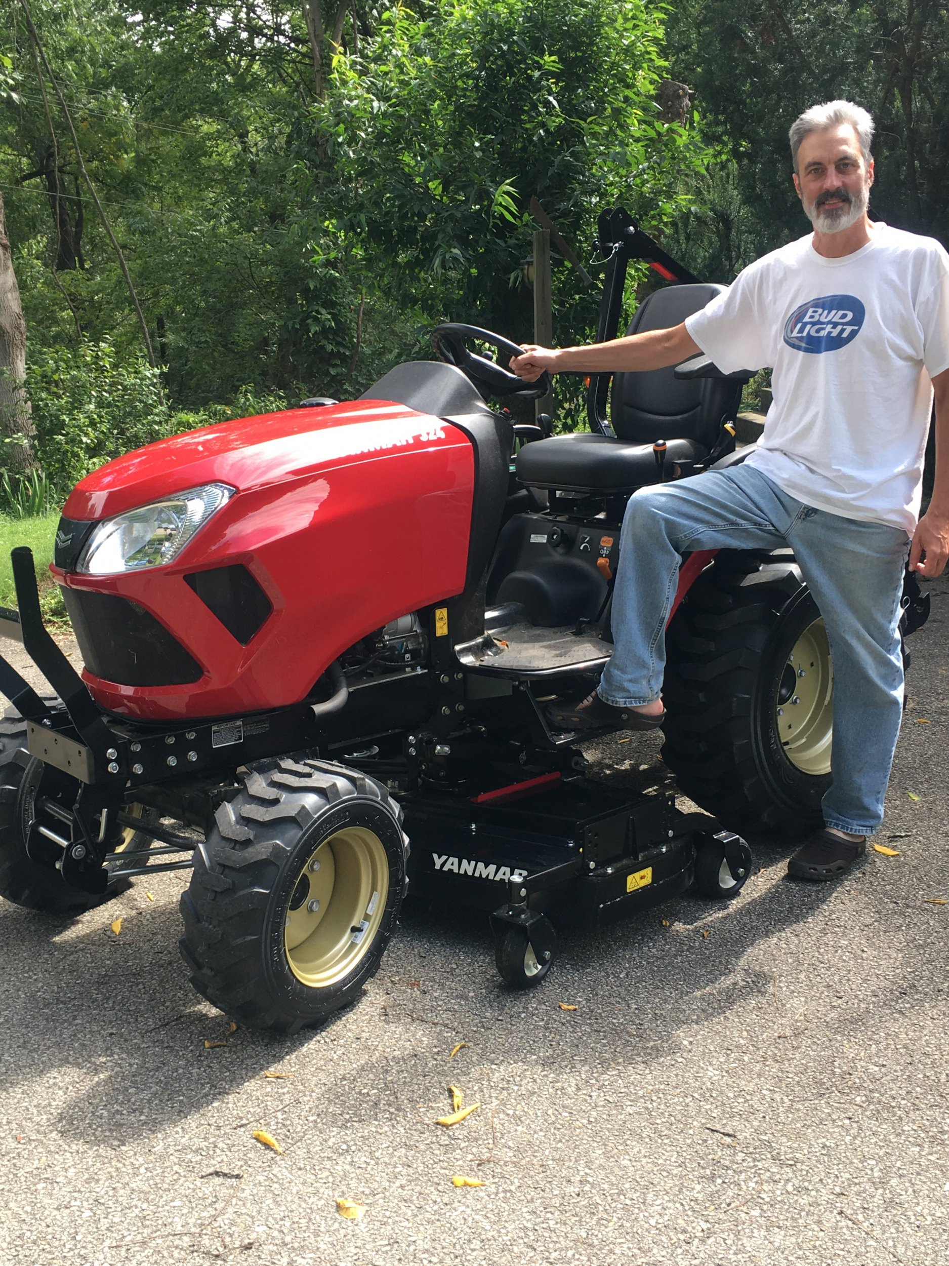

Talk to me about the SSQA on the SA series Yanmars. I heard they finally discovered them back in September, are they being shipped now? Have they arrived yet?
And, most importantly, are they Universal SSQA or, as I read on their site, some of kind of haff-arsed nonsense?
Still haven't figured that one out.
