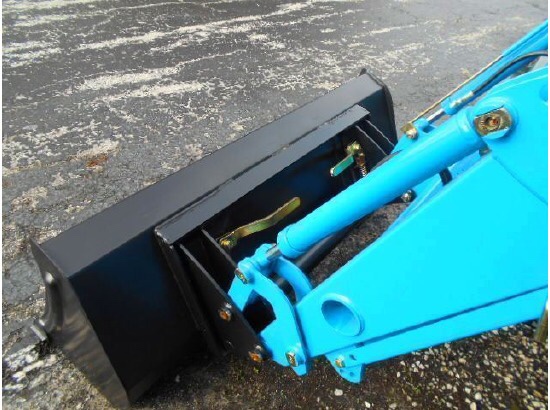

Well, I got lucky. My dealer is the one who is handling my recall and they will be here Sunday to pick up the tractor. A bit of a relief as they seem like good people and I'd prefer to keep dealing with the same people instead of a new dealer. We'll see what they figure out. I'll still try to get some fluid film before tomorrow and give it a try.

fwiw, I have the XJ2025 and I have noticed that one side of the bucket always makes contact first.
In addition to the above positioning suggestions it would seem that it might help to lower the bucket until one side made contact, then put something such as a 2x4 under the other side to shim it so that when the weight was on the bucket there would be no twisting stress on the arms.

Received my tractor back from the recall work. They said when they received it the bucket was very hard to get off. He had to hit the pins from underneath to pop them loose. After that he didn't have trouble with them. Of course I never had trouble getting the bucket off right after I put it on, but yesterday and I did some work with the ratchet rake on the bucket and when I got done I decided why not try and get the pins up. I pulled and it took some effort but I was able to do it by hand. He did grease the pins and bent the handles back closer to where they should have been. Gives me optimism about fluid film working for me. Hope to try this weekend when i get rid of this stomach bug. Thanks for all the feedback! I'll update how the fluid film does.
