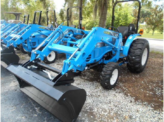

Internet shots of same loader. Note that end of the lock arms are parallel with back of bucket.
If OP’s arms have always been this way, a visit to Dealer is in order.
