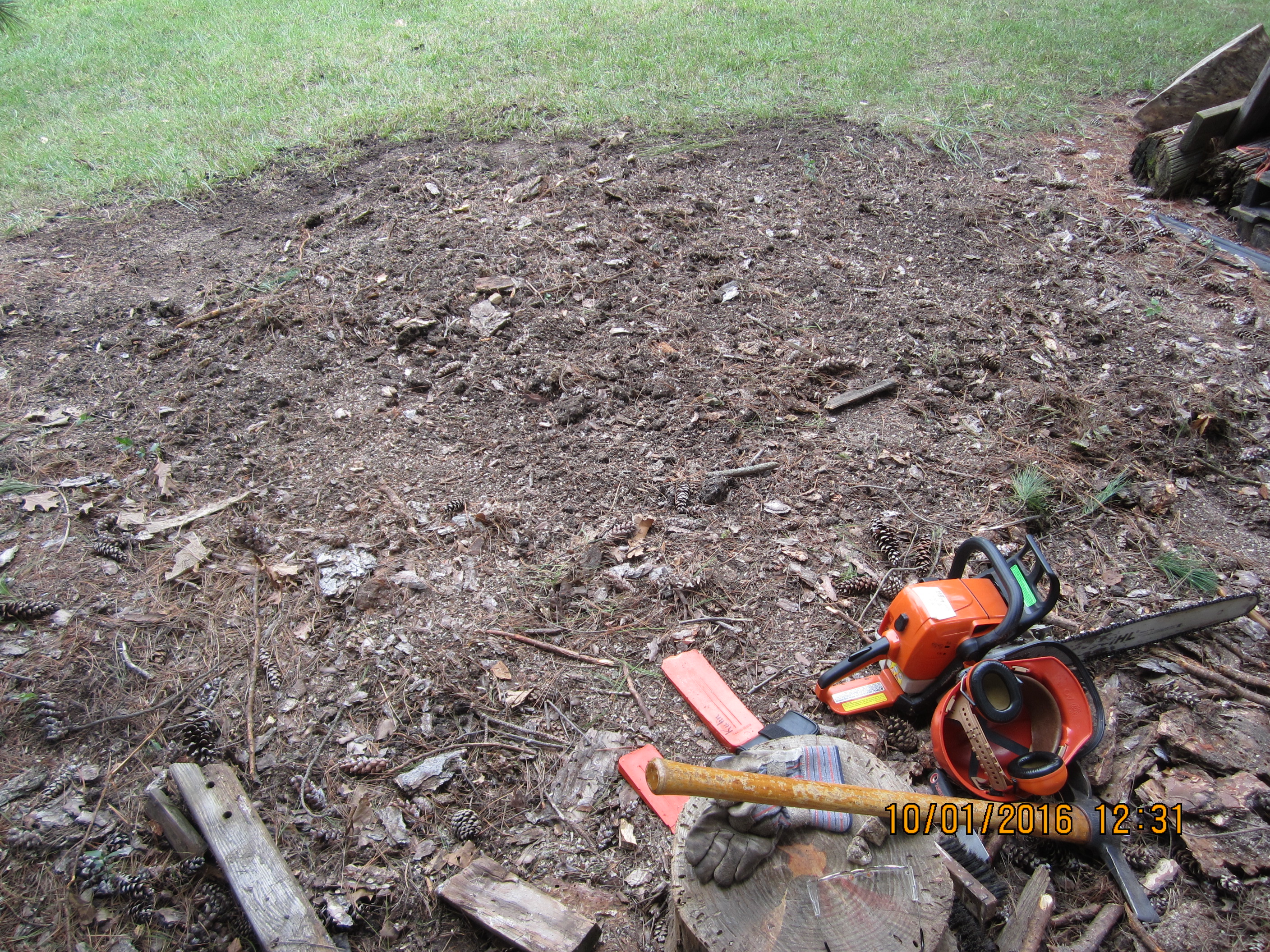

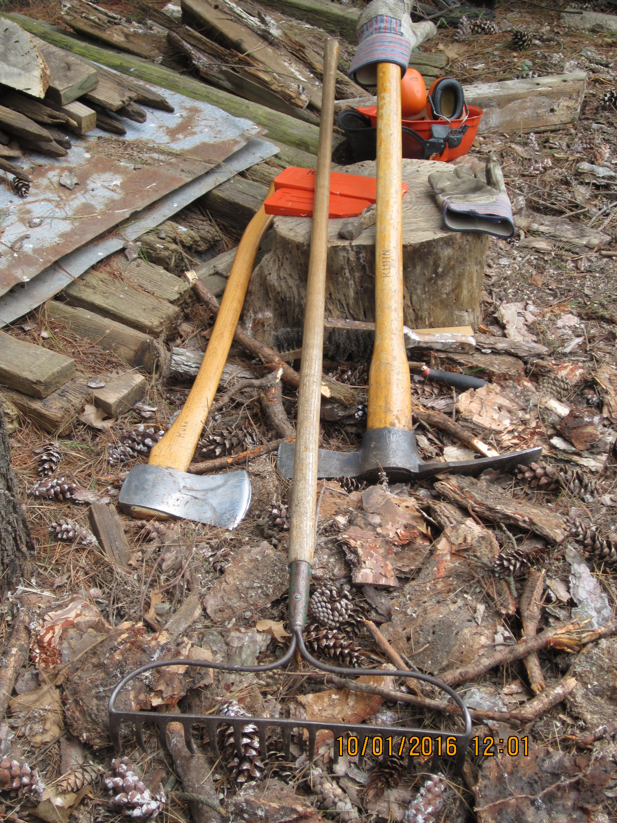

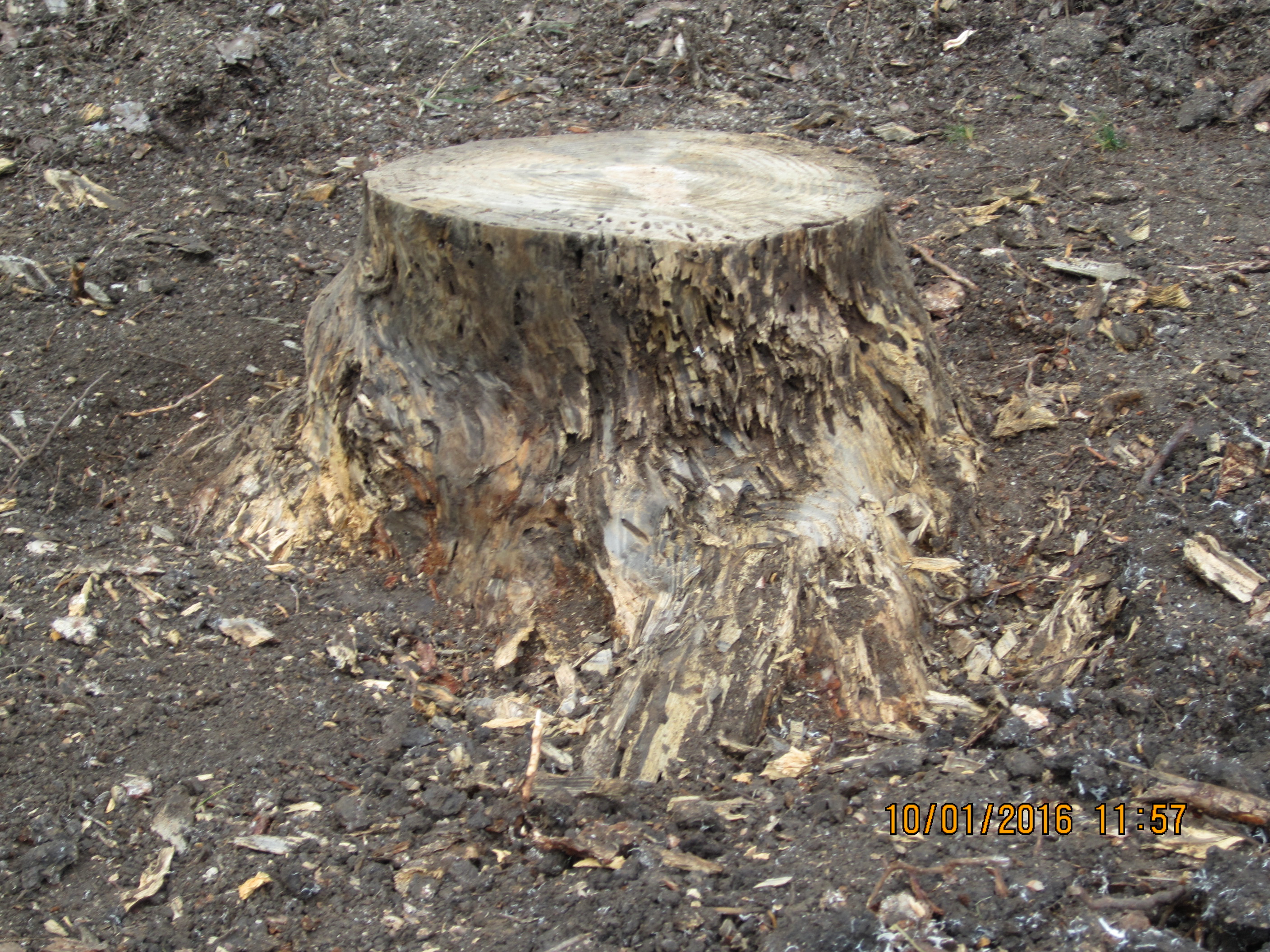

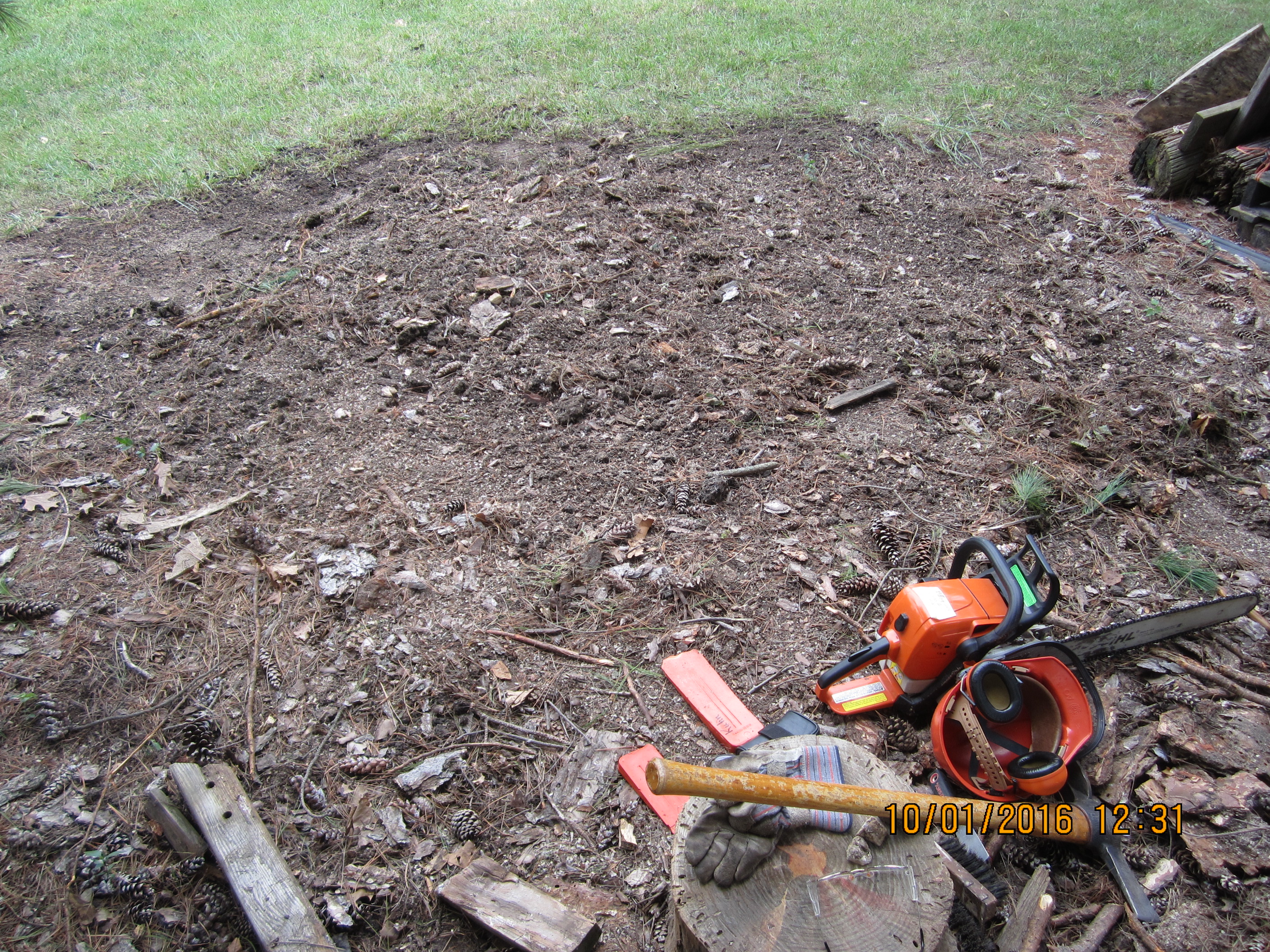

I don't know about two acres worth of stumps, but if a stump is in my way, I dig out around it,....chainsaw/axe it off about 6 inches below grade then cover it up with dirt. It'll rot in time and leave a depression that needs more dirt after awhile. It's good exercise Murph.:D031.JPG034.JPG039.JPG
That's two stumps that were close together. .... then one was covered up.
