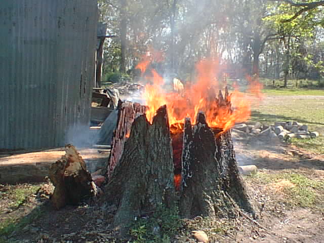

If the stump was partially hollow it would be very easy to burn. (see photo)
I burned many stumps after Katrina knocked over a lot of our trees. I found that the best and easiest way to burn the stumps was to pile a lot of wood on top of them and burn the wood. I used pecan wood because I had so much of it and pecan burns very hot and very well. Tallow, hackberry, willow, etc, do not burn very well. Oak, pecan, hickory and others burn great. Burn enough big branches on top of the stump and the hot coals will keep it burning for days. I have had stumps slowly burning underground for 2 weeks until all large roots were gone and all I had to do was throw a little dirt in the hole. Do not stir the ashes until you are ready to put it out because the ashes insulate the slowly burning stump and keep it hot. No expensive diesel or gas is needed.;)
