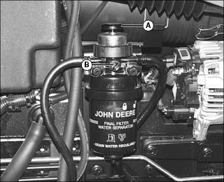

Filled tank and bled 6 times still won't turn over. Is this normal? How many times should I do this ? Everytime I bleed it gas is coming out along with bubbles. I'm afraid of flooding engine. Anything else it could b or should I keep bleeding it?
/ Stuck Tractor on Large Stump #23
The OP said When I turn the key the engine wants to turn over but it won't (all the electrical works). If it a steep angle could you be getting oil into the cylinders and creating hydro lock? If that is possible, pull the injectors and check it. Or check for a loose ground. I've had things shift and loosen the neg cable at the battery.
/ Stuck Tractor on Large Stump #24
Just so we are all sure on what you mean by "turn over" You do mean dont you that the engine will crank over when you turn the key, and it will crank at a normal rate but the engine will not run right? Because if you mean the engine will not crank or "turn over" then that is a whole different problem. Please be specific, as it really helps to diagnose the problem. Remember we are thousands of miles away, and it is very difficult to see and hear what you are seeing and hearing. I dont think you could "flood" the engine by the bleed procedure. the idea is to remove the air in the lines. remember it has no carb or float bowl just an injector pump to inject high pressure diesel fuel directly into the combustion chambers and usually a "lift" pump to take fuel from the tank to the high pressure injector pump. I am no diesel mechanic by a long shot, but there are diesel mechanics on this board, and if we can give them the best information we can then the chances of getting this fixed by "remote control" are very good. Thanks

Correct it cranks but engine won't start. When bleed line have done 20 times air coming out w fuel does that mean still need to bleed or is it normal to bubble when line is bled.
/ Stuck Tractor on Large Stump #26
If you've done this 20 times and air is still coming out... I wonder if the fuel line as a hole in it?
/ Stuck Tractor on Large Stump #27
I'd do a thorough inspection of the fuel line runs. I've had a stick come up from the ground and break or crimp a line before.
/ Stuck Tractor on Large Stump #28
Bottom line, You should not have any air in the line... just fuel coming out.

Tried about 100 times to pump and bleed the line but I kept getting diesel fuel with air bubbles coming out. Must be a hole in the line somewhere. I'm going to try to have JD come out and service it. Thanks for all the help, I'll let you know what they find.
When I filled the tank full this morning before bleeding the line, right below the "final filter water separator (where you pump and release the fuel to bleed the line of air), there's a 1 inch diameter line that was leaking dripping fuel. I'm not sure if fuel dripped from the final filter water separator onto this line and appeared to be dripping fuel, but it did appear the line was slightly bubbling (only when the fuel tank was filled all the way).
So right now I'm guess there's still air in the line or possibly a break in one of the fuel lines somewhere. I was hoping it'd be an easy fix as I'm not capable of doing much anyway, but it looks like it's going to get serviced. Just hope they can do it in the field as it's in the woods and I don't think it will be able to be removed otherwise;)
#32
Thanks fir everyones help. Service dept came out today and found the problem: there was a very very small crack in the end of the fuel line . He cut about an inch off and bled the line which produced zero air bubbles. Then he had to jump the battery. After a few series of bleeding line we were able to get her started. I was very close to fixing myself...maybe next time!!!
