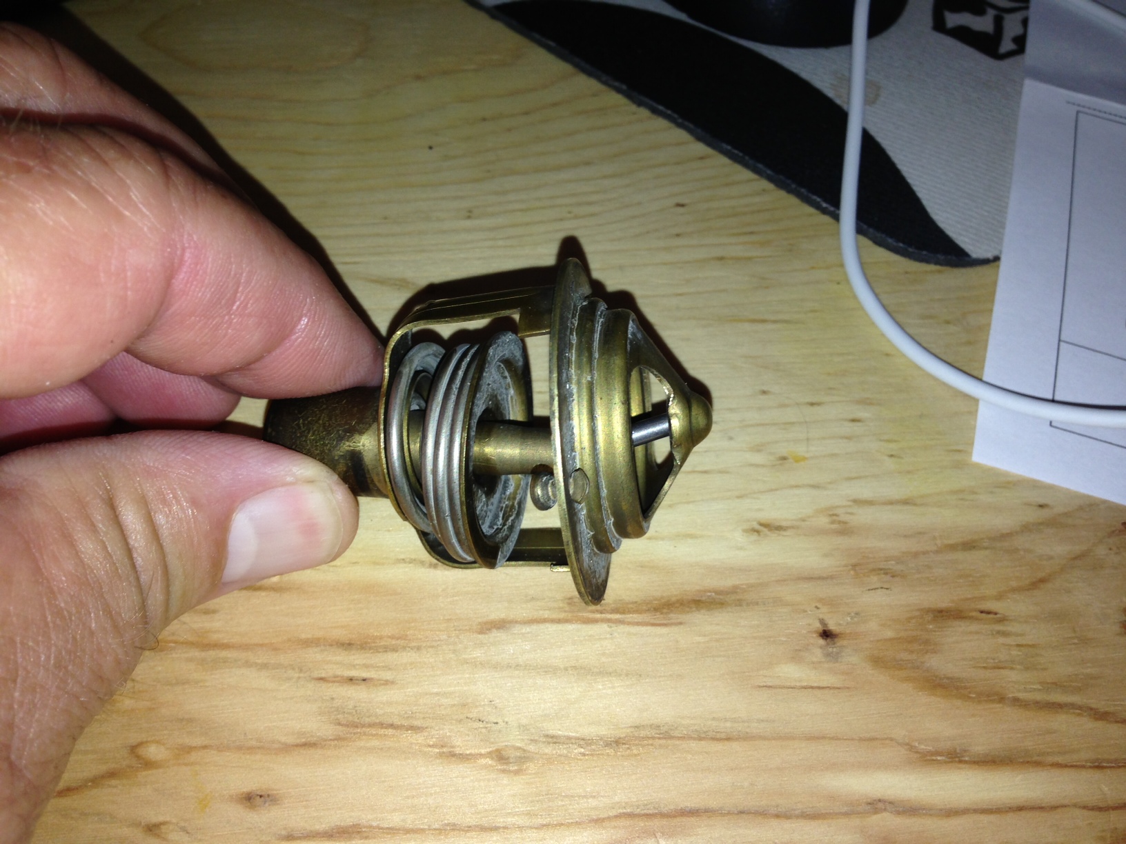

In my less than 12 posts, this is the first that I have attempted to attach a photo.
If you see the photo, it is a thermostat from my JD950, which has been overheating. I replaced the water pump and thermostat last year, but it is again overheating this year. The thermostat that I replaced last year... appeared just as this one does, with the rod extended out and to a ~120 degree angle.
It seems to be stuck, but I don't know enough to know if this is normal, if it is stuck open or stuck mostly closed.
Finally, what are the cons for running my tractor without the thermostat until a new one arrives. I need to do cut a pasture soon.

You have the right thermostat? There appears to be some kind of damage to the stat and I can only think that its because its the wrong one.. Or installed wrong.
You can run all you want in the warm months without a thermostat.. just let it warm up a few extra minutes before running hard.

It is definitely stuck open. Just because it was a year ago that you replaced it doesn't mean it can't be at fault. It is either a bad design or poorly made.
The thermostat acts by trapping hot water in the radiator long enough to let it expel excessive heat. Meantime, cooler water warms up to pre-determined temperature of thermostat until hot enough to open. Without the thermostat, the water continuously heats up until the system overheats.
Go to an auto parts store and try to match up with an import model thermostat if a direct cross reference is not available. It will get you going for now.

It is a genuine JD part from the JD retailer. It can only be installed one direction.
I'm going to see how long it runs without overheating now.

That thermostat is not only (stuck WIDE OPEN) it looks to be hyper extended or damaged, throw it away and install a new one...
The spring side always goes toward the cylinder block / or head... Good luck.

That thermostat is definitely bent. I can't even figure out how it could get bent like that??? I'm curious to hear the answer for this problem.
