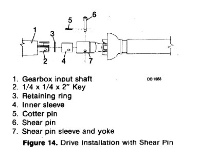

The sleeve has a snap ring on the inside toward the gear box. I didn't think about it being a shear pin model.
Edit: looks like it took me to long to get a picture loaded.

Jerry, It is exactly how is shown in your pic. The problem I had was the type of spring loaded concentric snap ring they used. I could not use any snap ring compression hand tool, had to bend the tip on a small screwdriver to kind of gouge it out of there. Not very convinient at all but quite stout. it appears all the early pulling and pushing and beating did not phase it at all and the ring looks in good shape. Thanks for your inpuut.

Glad it helped. That type of ring is always a real pain. One thing for sure, the way things are designed on this model of Woods mower, nothing is going to come off by it's self. I have the same mower but with a slip clutch and have put it through heck and never tore up anything on it.
