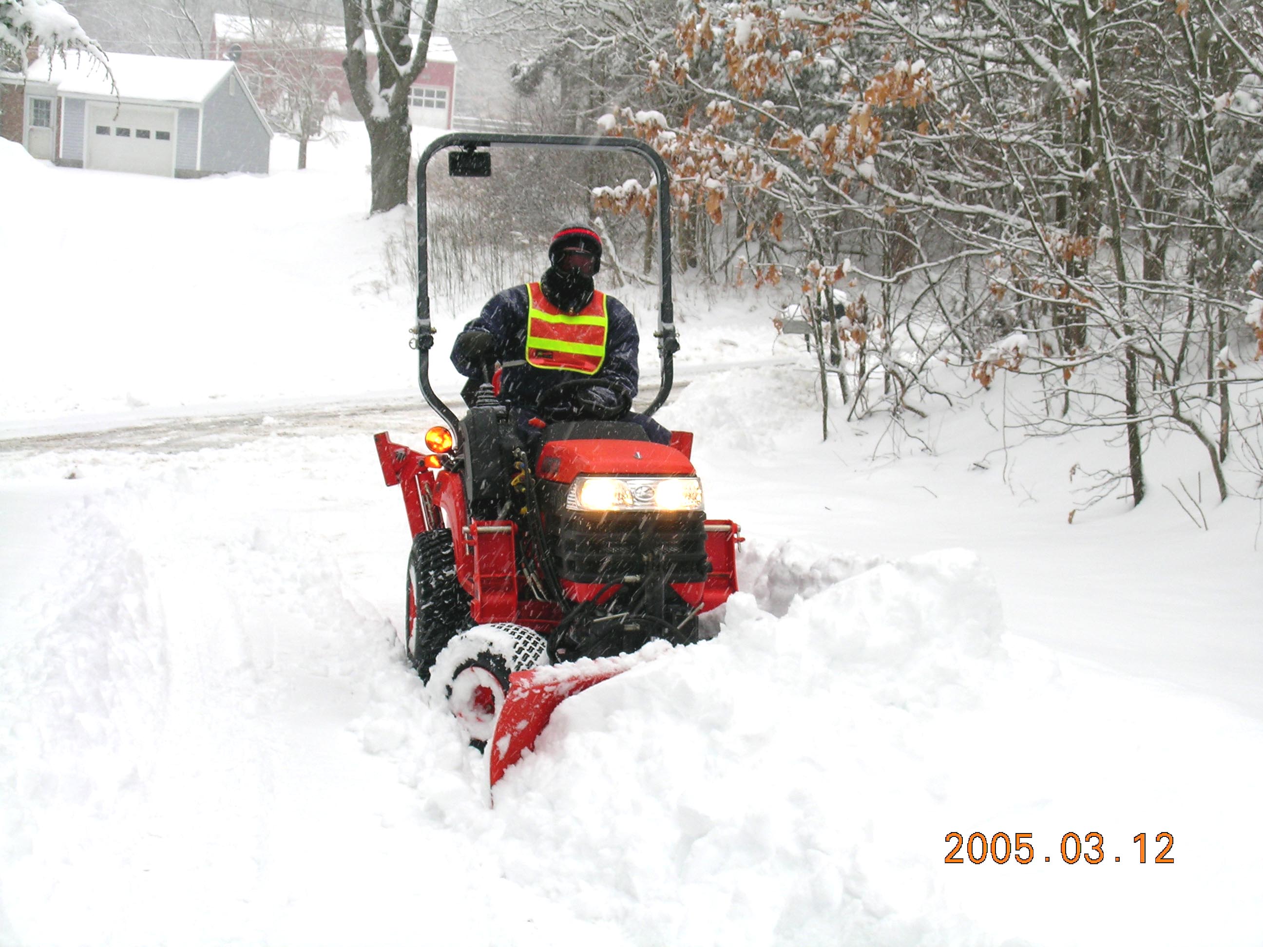

BX23 with turf tires, no chains, NOT stuck while plowing.

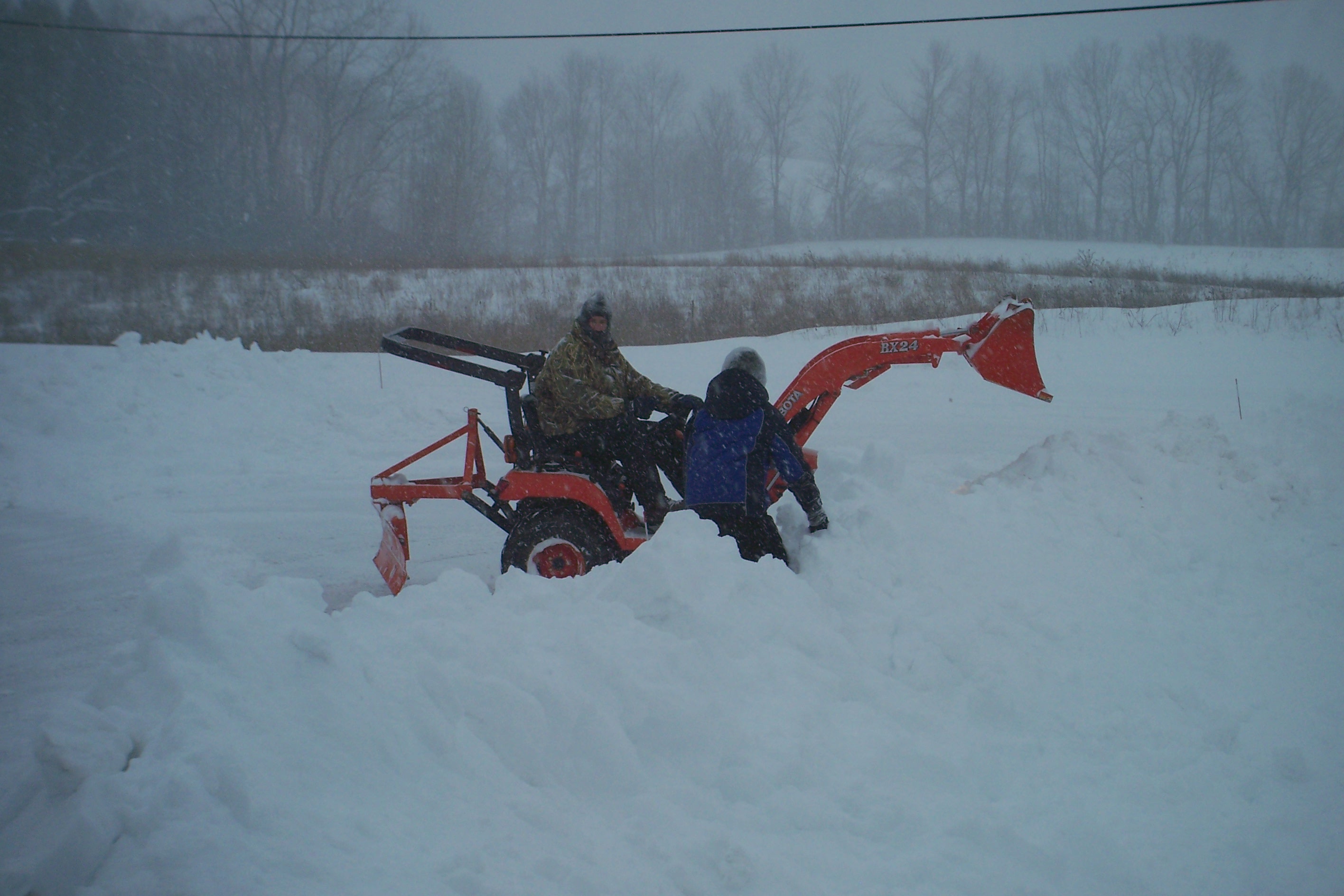

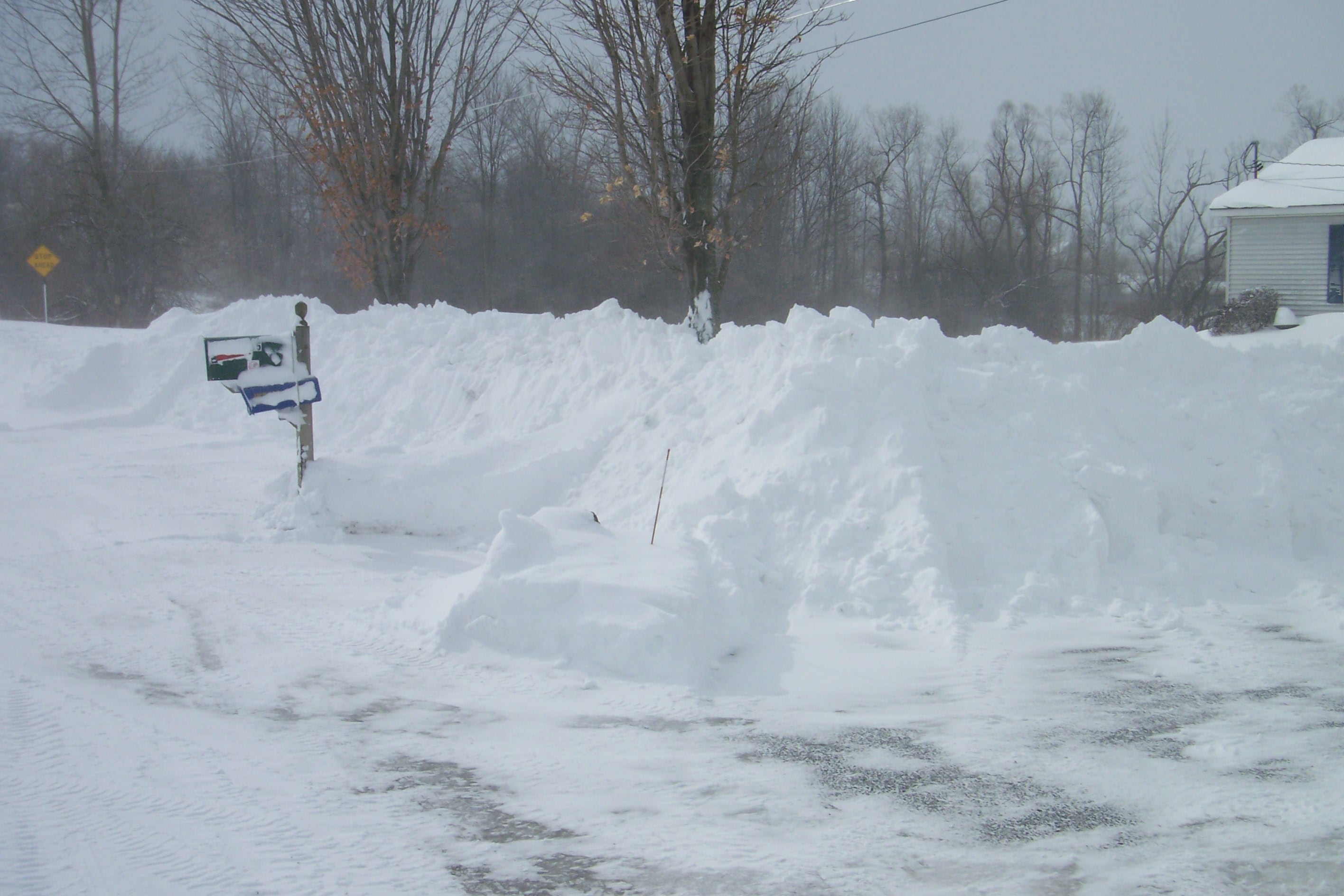

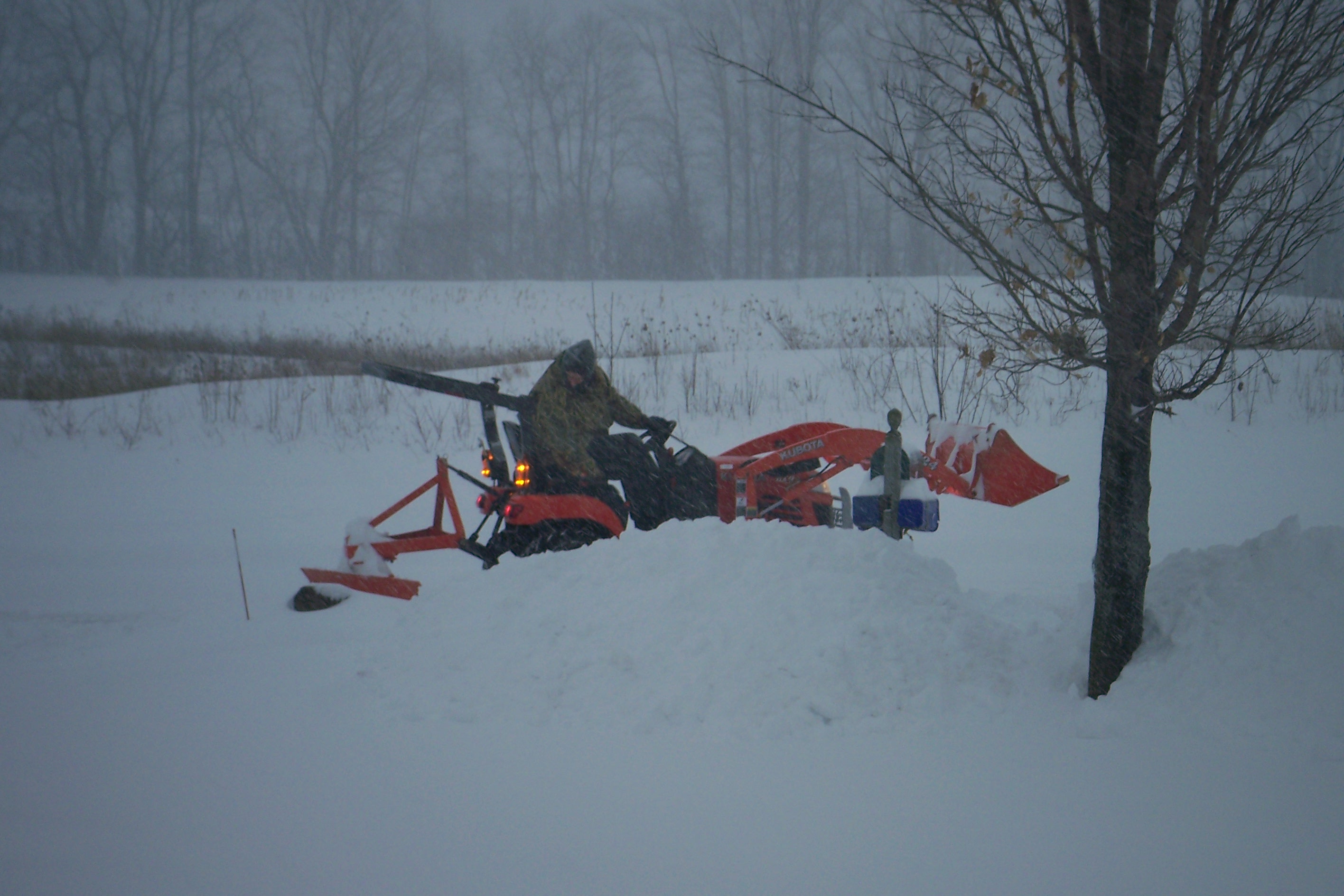

Sorry, never been stuck in the snow. Mud, yes, but not snow. Here are a few pics of a BX with no chains in an Upstate NY snowfall.
I suppose now I'm doomed to get stuck this winter for shooting off my big mouth!

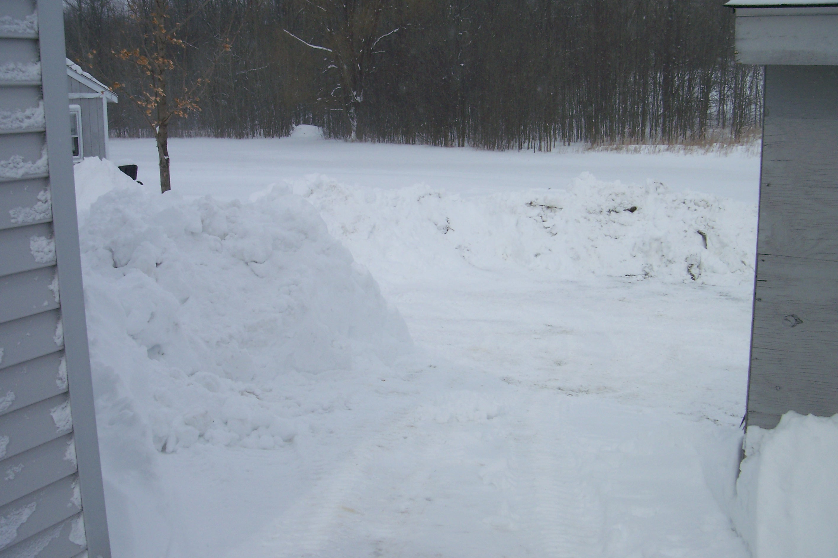

I used to operate without chains, but after last years big storm I got a set of chains and what a huge difference they make. Now here's a big chunk of snow
