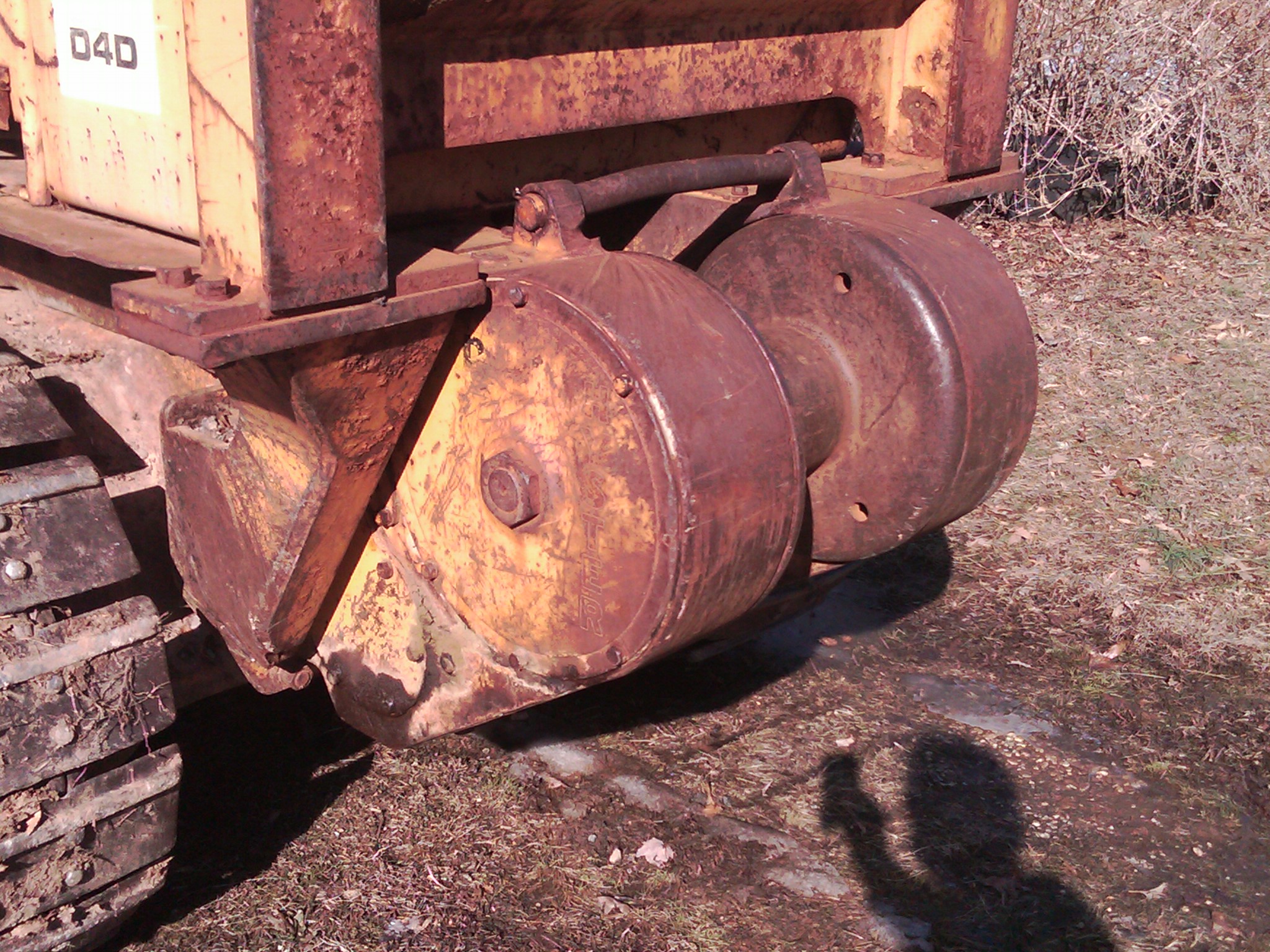

That's the nice thing about having a winch rated at 66,700lbs attached to the back of your dozer. Never had to use it to pull out my JD, but I'm betting it would work...:drink: In fact, at a weight of 1,980lbs, I'm wondering if the winch itself weighs more than my 790...
What would you tie it to that would not be pulled out of the ground at 66,700 pounds. WOW!
