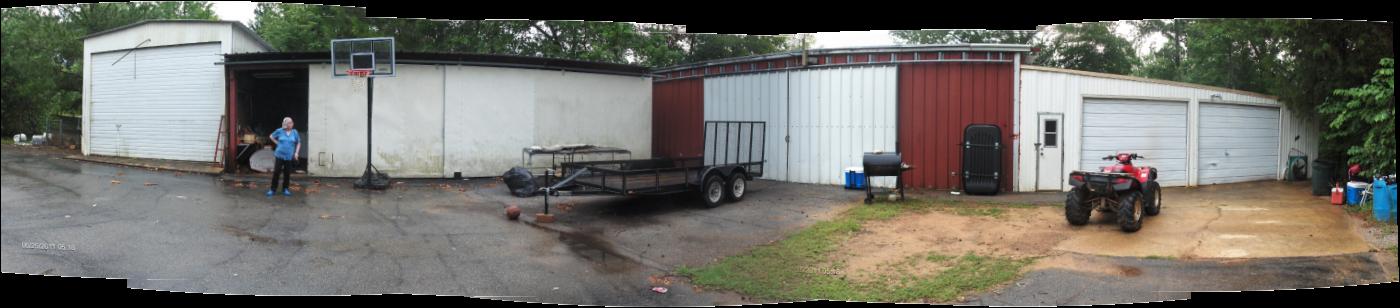

Just a bump because it solved my problem with my M4700
My range gear shift lever got stuck with the tractor in forward low.
Luckily it was in my parking lot on front of my shops.
Gave up on trying to jam it, came back, did [ "stuck in gear" site:www.tractorbynet.com] google search,
found this thread. Went back to tractor, wiggled the lever underneath that's in the OP's pic. Fixed!!!
