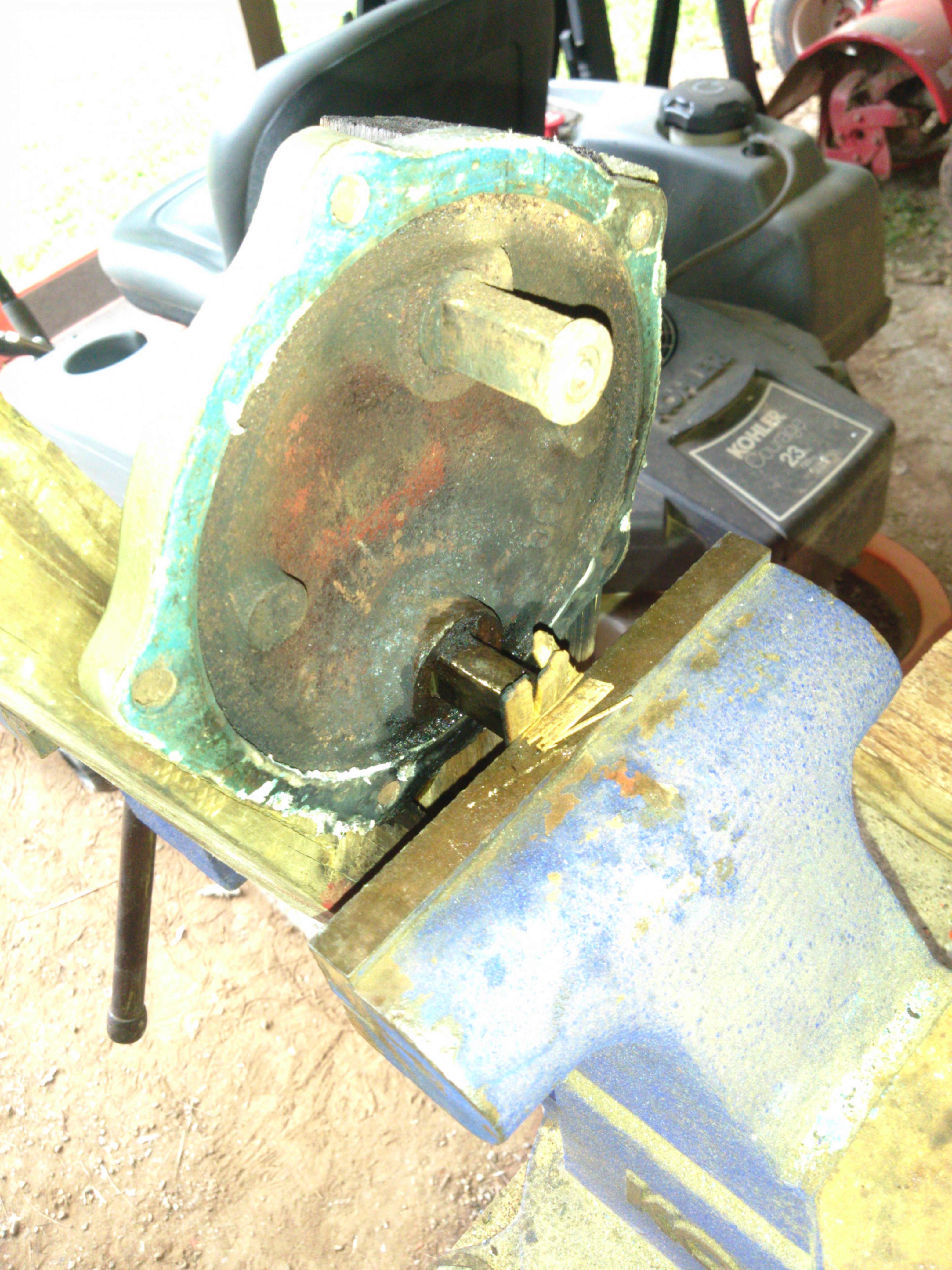

I finally got it. Used heat. And a 4 foot cheater bar on the vise to really tighten it down and took a hammer and started hitting the outside of the cam lever repeatedly and after a dozen pretty good socks with about a 8oz ball peen on it it filially popped. I had to keep useing the cheater pipe to press it out. It was popping as it went along till it filally got past the shoulder.
/ Stuck Brake cam on YM2000
Here are some pics, i still cant see how to add them from my phone so i have to email them and open them on a computer. What a pain the mobile site and app has become on this site.
Here are a few pics i took in the vise so that if someone in the future needs to do this they can see how i supported it. I am going to need to wire wheel the cover and respray the paint as the heat bubbeld it all up as you can see.

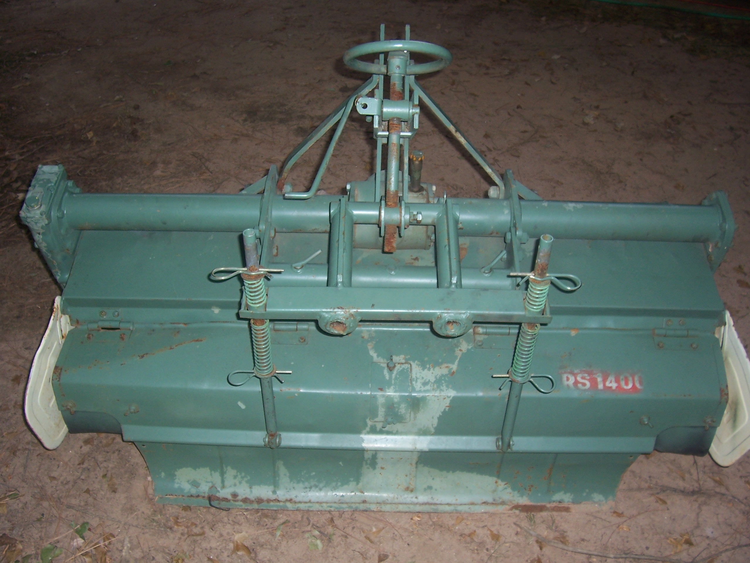

I bet this may be really close. If you look at the Tiller this is it. Looks close to your refurbished Grn. I picked this paint and the Tiller up at Fredricks. I touched up A few spots and painted the seat arms with it. The Dark Grn. if you look at the 3pt. lift handle is Org. that is closer to what Winston posted IMO.. I'm going to have to pickup a can of that and see just how close.
