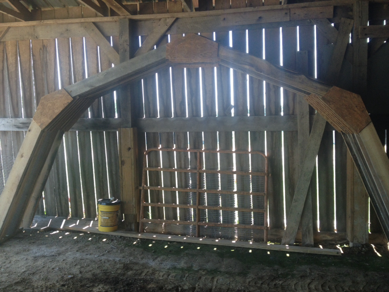

Hard to tell from your photo, but it looks like your joists are on hangers on a single 2x12 that's spanning your posts. What is your post spacing? I'd consider this inadequate.
   / Stroage Building #42
<snip> Found a web site that you can print the plans for the gambrel truss from. I am in an area that other than new service for power company or septic doesn't require an inspection. But it will be built right.

Thought I'd give an update. Half the trusses are built. I really wish I had endless days to spend on this but I just get a day here and there. I wasn't planning on it taking so long.
A little description of trusses. Each side of the gambrel truss is 6'61/2" long side with a 22.5* miter. This will allow for them to be notched for installation. 12 x 24 gussets at each joint.

Another minor update. All trusses are built. Have been for about 3 weeks. Was hoping for them to be installed by now.
