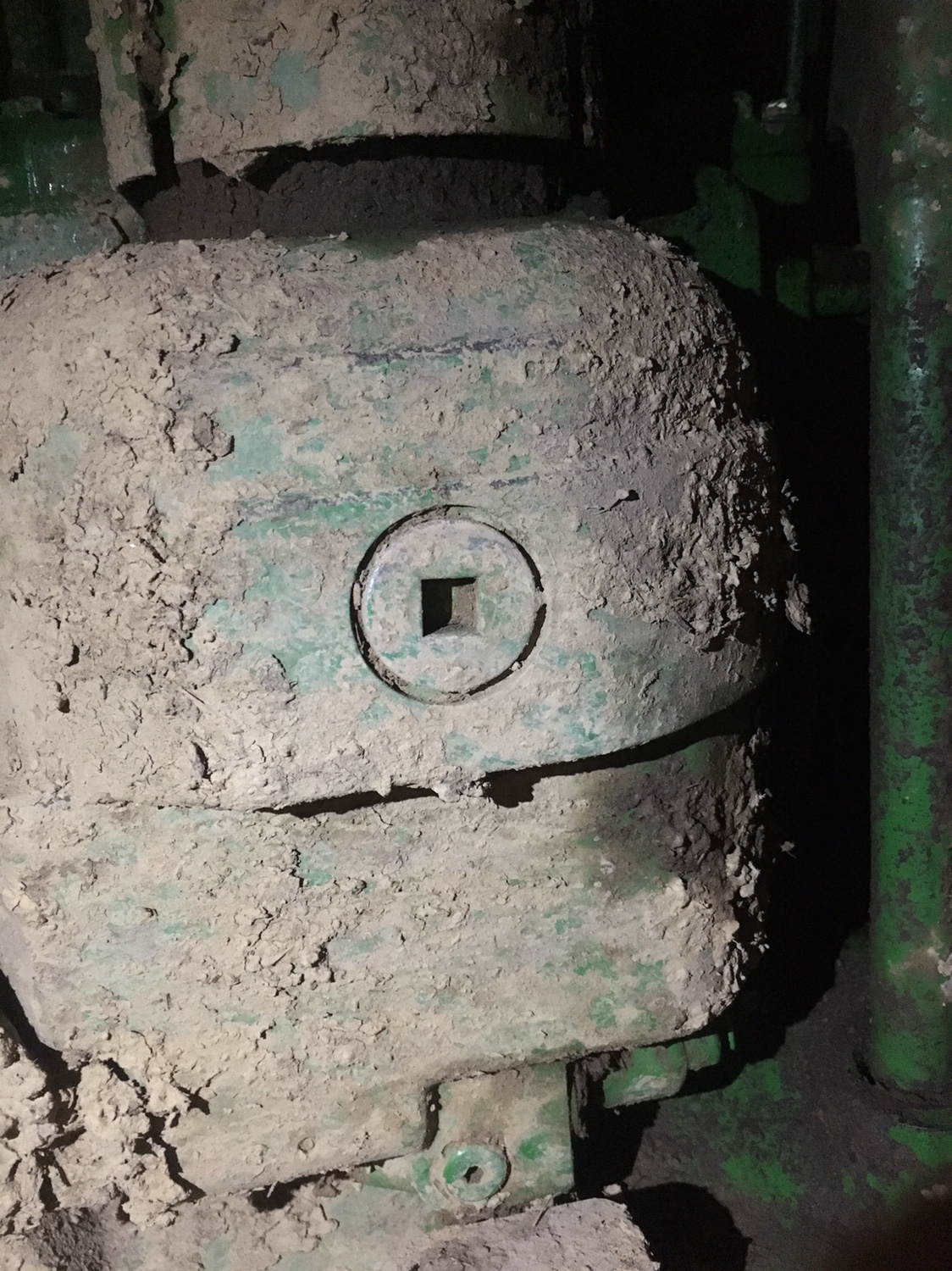

I bought an 80's Ford 4100 diesel a couple of years ago and I need to change the transmission fluid. However the plug is stripped, so I can't get it out. It's the type with an inverted 1/2 inch square which was almost completely rounded. I couldn't get any bite with my 1/2 breaker bar so I ordered some extractors. The plug seems to be soft metal as the extractors seem to get a little bit of a bite and then just start eating away material.
I'm not sure what else to try, I was going to try and collapse in the sides so that the threads would be loose but it sits almost flush with the transmission housing so I can't really get much forse from the outside.
Any suggestions?

Thanks for that link... I think. I had to go back a good number of pages to even find anything related to actually getting the plug out. I had no idea drain plugs could cause so much conversation. Sounds like his was more of a standard plug with a hex head. Mine is more like the picture:
That being said I think I'll have to end up doing something similar and drill it out. I don't have a bit nearly as big as the plug, I'm guessing it's close to an inch in diameter. I was thinking about using a small bit and drilling holes in a v - pattern to make a pie shaped section that I can knock out and then try collapsing the rest. My fear is damaging threads or cracking the housing.

You mean yours is SUPPOSED to look like that, right?
Yeah, that was a concern over there too.
Yes, mine is supposed to look similar to that but the square hole is almost round.

If you post a photo of YOUR drain plug we might be better able to make suggestions.
When I search for a drain plug for a Ford 4100 they all come up showing straight threads and a external hex. I hope someone didn't replace a straight thread drain plug with a pipe plug.
/ Stripped transmission drain plug - Ford 4100 #14
A pipe plug explains a lot, the biggie is dissimilar metals and thus corrosion. A big possibility of galvanized if it is a pipe plug, be careful welding as galvanized metal can and does give off toxic fumes.
You may have some luck with a hammer and chisel, the jarring action may loosen the the corrosion as well as turn the plug. I would go to a NH dealer and get the correct plug before going very much further.

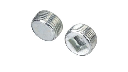

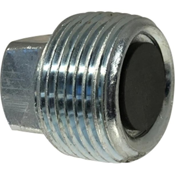

The old one looks like this drain_plug_old.jpg just found it on a parts site for the ford 4100. I'd already bought a new one last year and then put off changing it when I found the old one stripped. Just went out to the shop to dig it out and it's almost the opposite of what's in there. drain_plug_new.jpeg
Don't remember where I purchased it from, one of the online tractor parts places. Both are listed as 3/4 - 14 NPT.
I guess the good thing is if it's the correct plug it's probably not galvinized and therefore might be able to weld a rod or old lug wrench to it. I don't think the welding would hurt the cast housing as long as I just weld a little at a time so that I don't heat it too much.

The old one looks like this View attachment 671658 just found it on a parts site for the ford 4100. I'd already bought a new one last year and then put off changing it when I found the old one stripped. Just went out to the shop to dig it out and it's almost the opposite of what's in there. View attachment 671657
You can try the weld trick, might try sacrificial socket wrench extension...But get a wrench on it while steel is hot and metal is relaxed....
