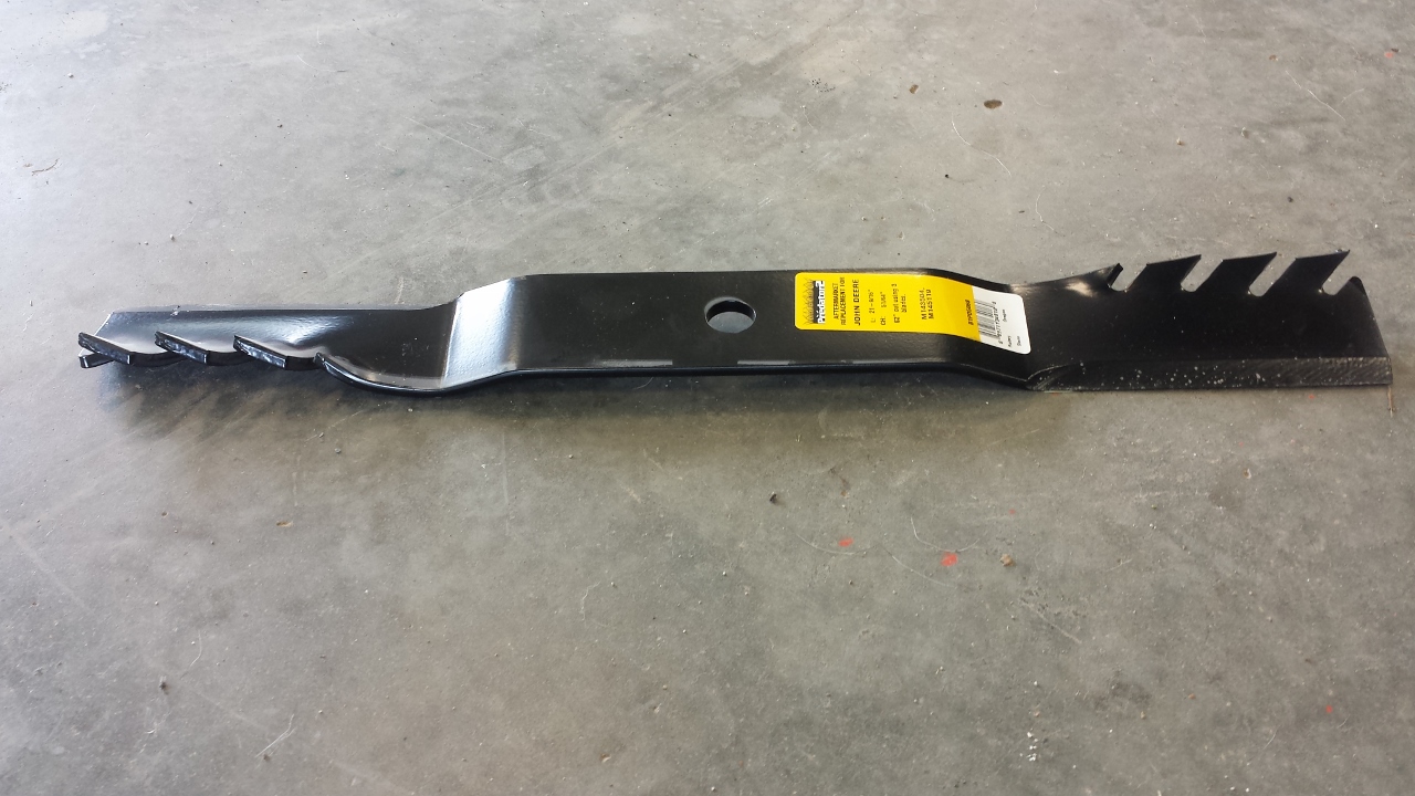

I truly can't remember the last time I sharpened my mower blades. I use these predator blades I get thru JD. They are extremely hard. Replace them when they actually wear thru the serrated lifts and they become ineffective.
Sharpening, if needed, should always be done with something mild like a flapper wheel. A grinding wheel will heat the cutting edge and remove it's temper. Then you get the joyful experience of frequent sharpening. :)

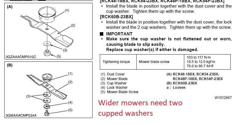

There should be two stacked spring washers on the wider BX mowers.
The proper term for these washers is "BELLEVILLE WASHERS."
The bolt torque is up to 86 lb ft
Dave M7040
Mine came with one cupped washers and one none slip washer.good point though... I should replace the cupped washers.. And thanks for proper torque specs. I'm pretty sure that's why I'm having problems last summer. Weak cupped washers plus over tightening. Time to hit online ordering....

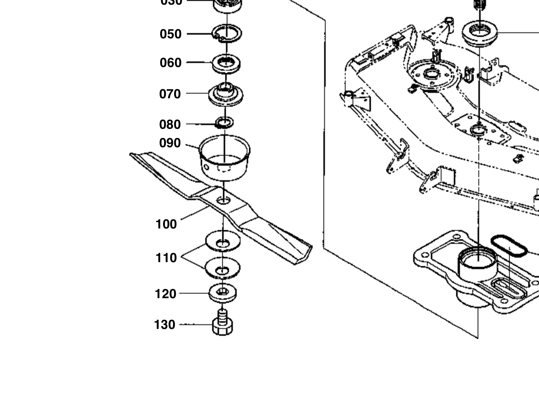

Are we talking about the same mower? I am out of town so I cannot check mine, but do have this screen shot from a parts manual I downloaded.
Looks like the dust cover is the only thing between the spindle end and the blade surface. On the other side of the blade are the two cup washers, a lock washer, and the bolt goes through the whole works and pulls everything tight against the spindle end.
I see no anti-spin washer. Am I missing the obvious? Would not be the first time. :)
Looking at this drawing it seems to me the important consideration is the state of the cup washers. Height of the washers would define whether they are satisfactory or need replacement I suppose. But this value is not given...:mad:

Part # 120 is what I am calling the anti spin washer. - - By its internal hex it "keys" to the spindle tip. Since the bolt screws into the spindle, any slip of the blade must be isolated from the bolt lest the slip force spin the bolt tighter and tighter. That washer provides this isolation.
The cup/spring/belleville washers spread the clamp force nicely on the blade but they operate totally flat. Older, well used cup washers dont spread the clamp force quite as well, but its the flat thickness of them in their position that is most important. Their spring force is trivial compared to the force applied by the bolt. That force must come directly to bear as a pinch on the blade before the anti spin washer and bolt bottom against the spindle nose.​
