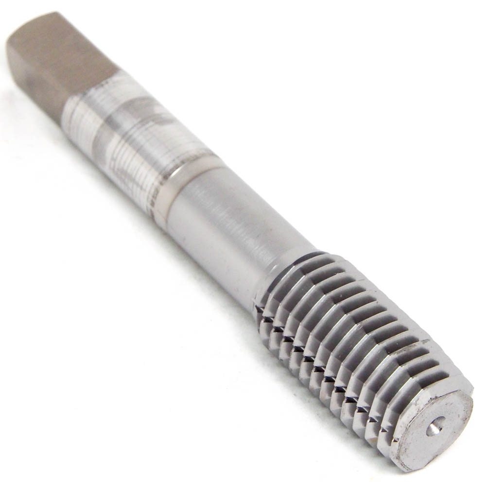

DO NOT use a standard cutting tap! Instead use a thread-forming plug tap with an appropriate lubricant. It does not cut, but instead reforms the threads to original. These taps have 4-6 rounded corners instead of being exactly round.

I've always wanted a set of thread forming taps - SAE and metric. Not necessarily for new threads but for chasing.
   / Strip spark plug #17
There are several designs, be sure to buy a set like the picture. You can feel the "corners" on them. Some have a straight cut in them, which can cut misshapen threads away.

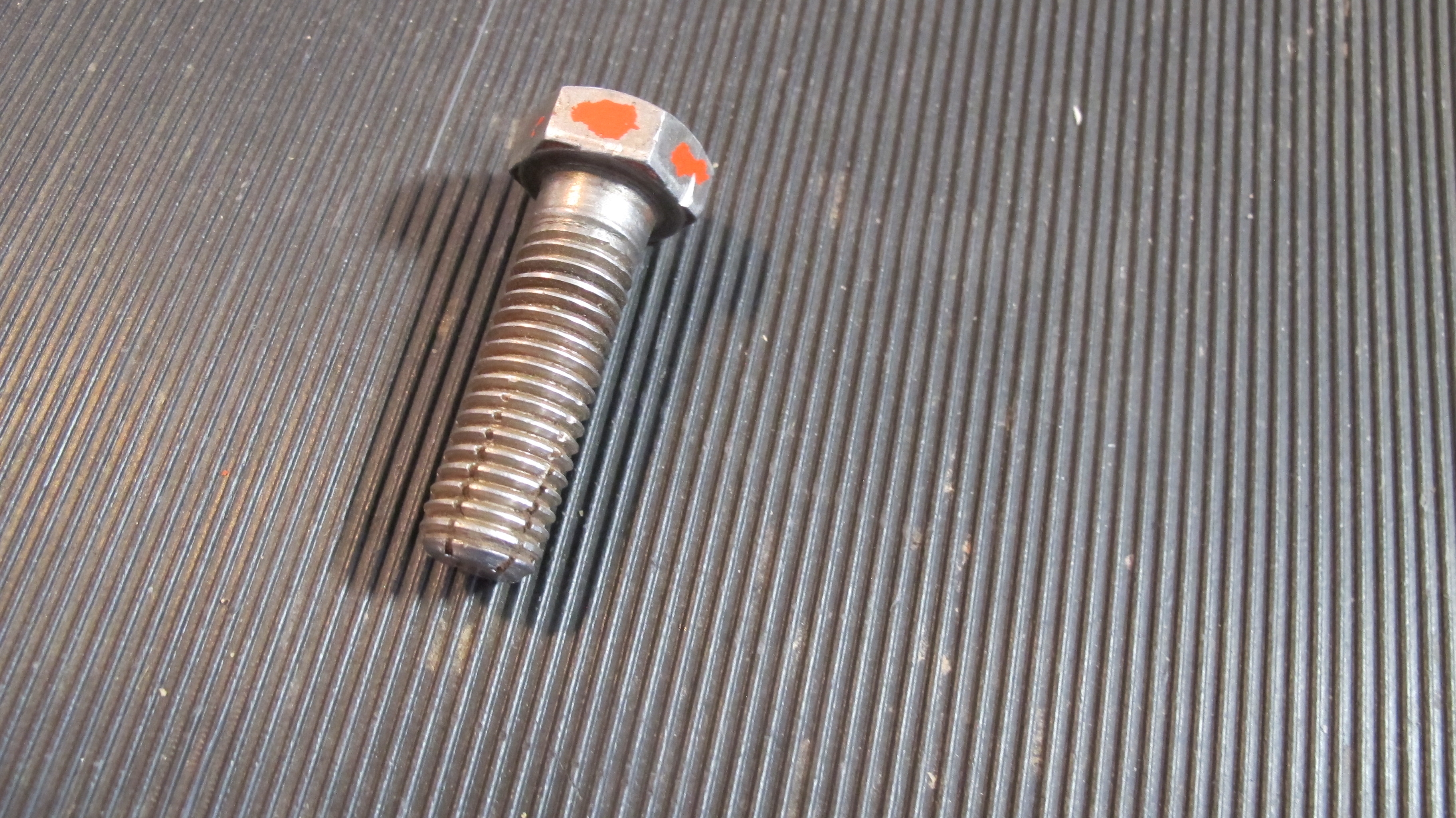

If you don't happen to have a thread restoring tool in the right size, it is easy to make one in a few minutes by slightly tapering the first few threads of a bolt or spark plug with a hand file, and then using a hacksaw to cut the slots as shown below
I've attached an example of a bolt turned into a thread-restoring tool. And the bolt is still goodto use as a bolt if necessary.
This trick works particularly well for restoring spark plug threads. It's almost a necessary tool in a shop that does work on aluminum heads.
You can control the taper by looking at the top of the starter threads. The one I've pictured is tapered about right. Also, the tool works better if you slightly slant the slots as shown.
