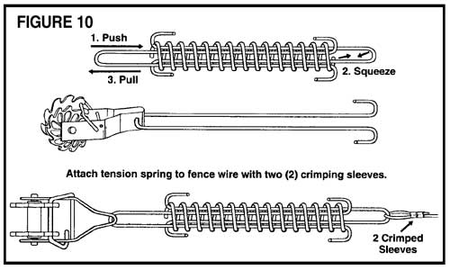

Those are what are used to build high tensile fence and are called tensioners and tighteners. You do need to get the crimping tool and the crimps to use those.
/ Stretched Fence #22
There is a special tool for creating a figure eight in the wire to take up the slack. I think Gempler's carries it. Eric
