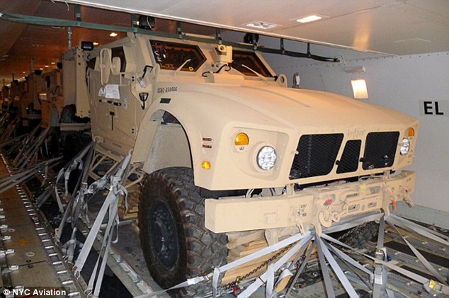

Straps...lots of straps...like the professionals.
Bruce
Bruce
My Cargo Handling Battalion Experience was before Roll On/Roll Off ships like this one. In cargo ships we lowered the tire pressure to allow putting down stress on the vehicle. Then we tied down with wire cable and turnbuckles. Qty based on tie down points available and weight of the cargo. Tracked vehicles we placed 4" dunnage under the treads first.
Ron
/ Straps vs chains - trailering #45
The CGU-1/B (5k rating) will be fine, provided you don't overload it. We calculated tie down based on equipment weight*g load. Forward g load was 3, so a 5k piece requires 15k of forward restraint. Always use tiedowns in pairs, so 4 straps or 2 10k chains.
(Retired USAF Port Dawg)
