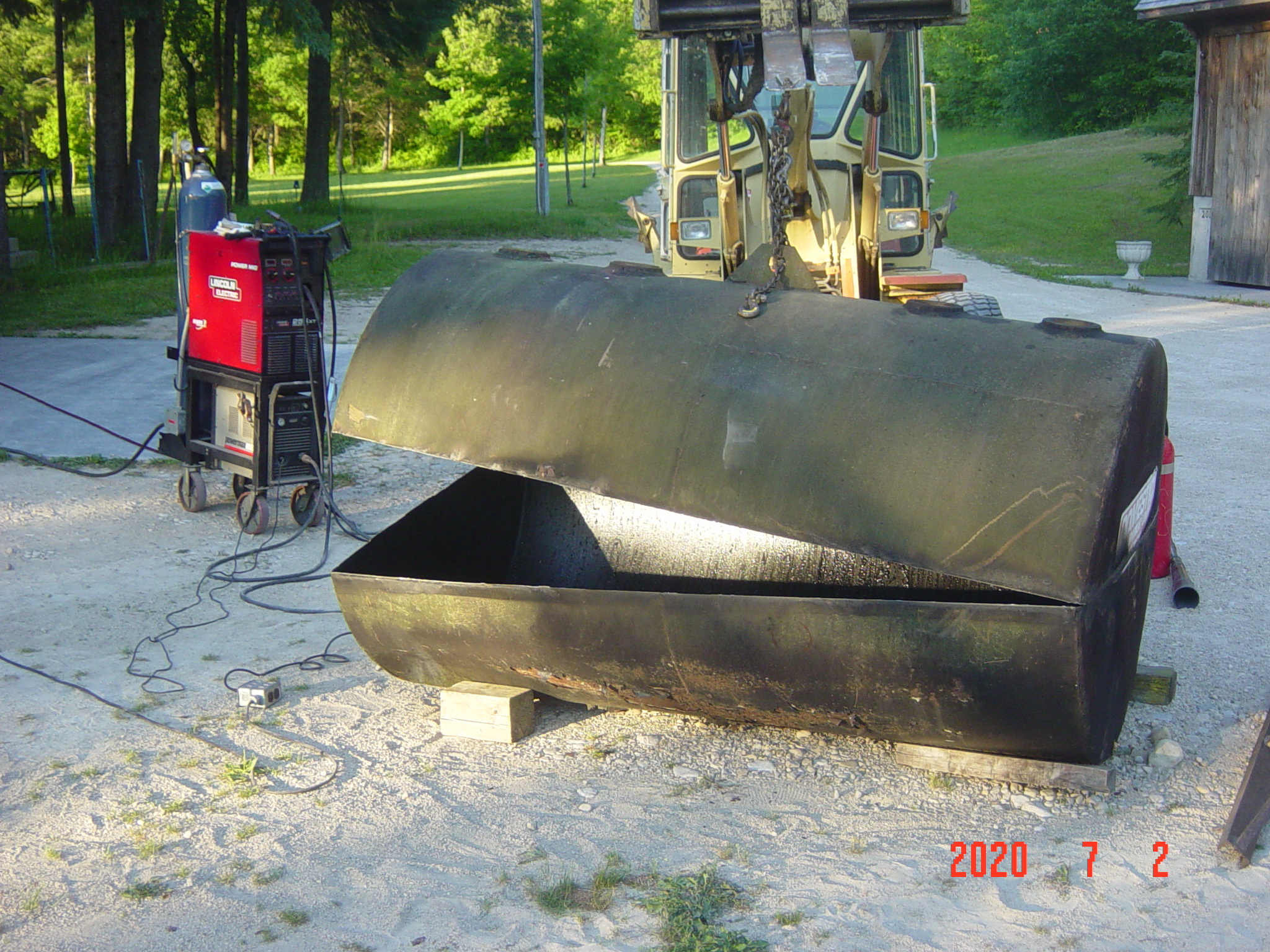

Check this one out. Only $8 There is a picture on the Welding forum post 1205
   / Straight cuts with plasma cutter. #19
   / Straight cuts with plasma cutter. #20
Awesome. This thread will inspire those in need to make their own. Oh the beauty of it.
