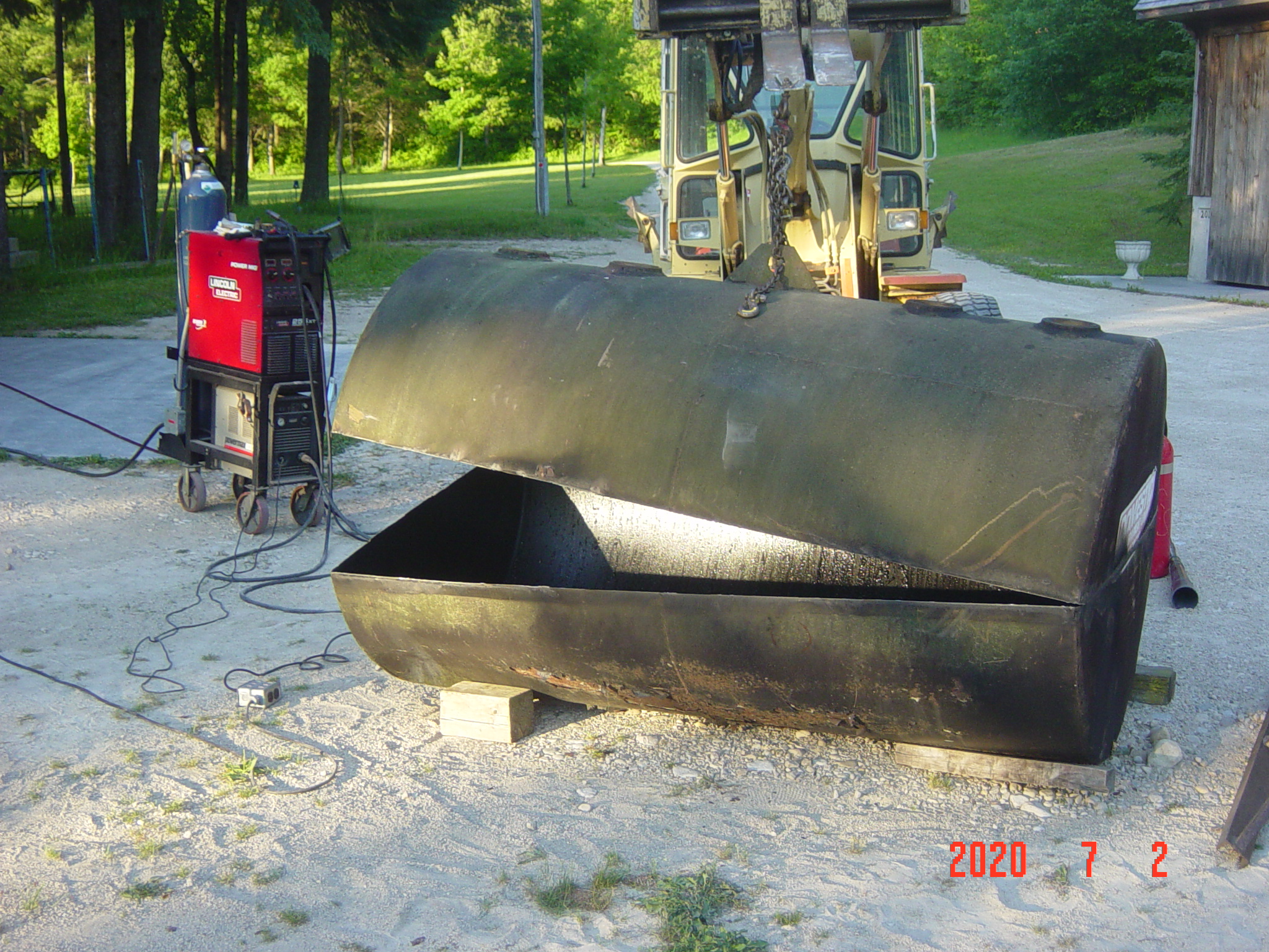

BTW, I set fire to my gloves when cutting that tank. On account of the paint, but almost intolerable when cutting through the labels.

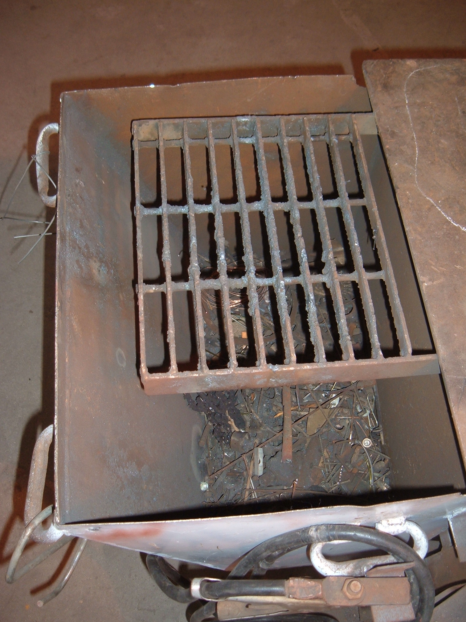

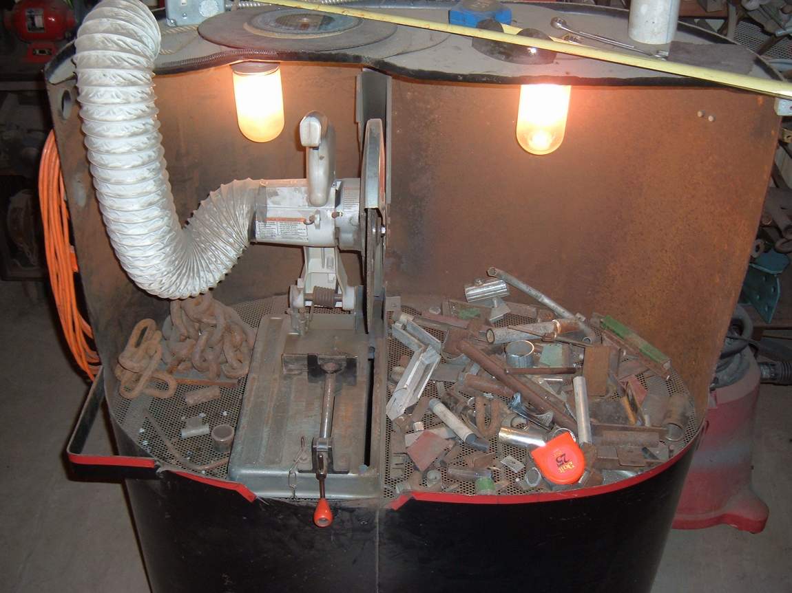

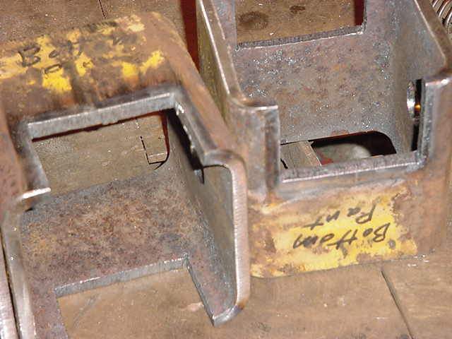

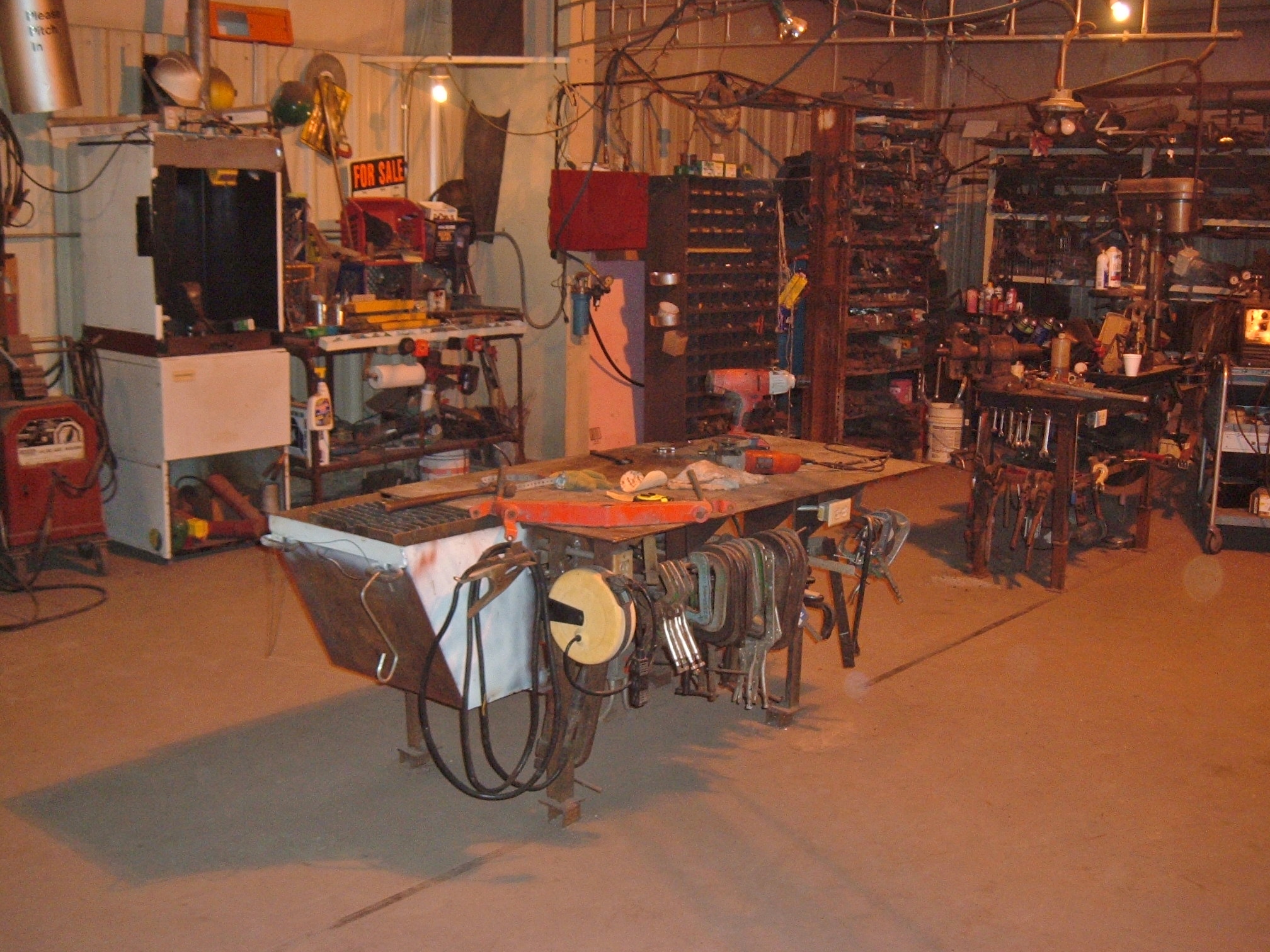

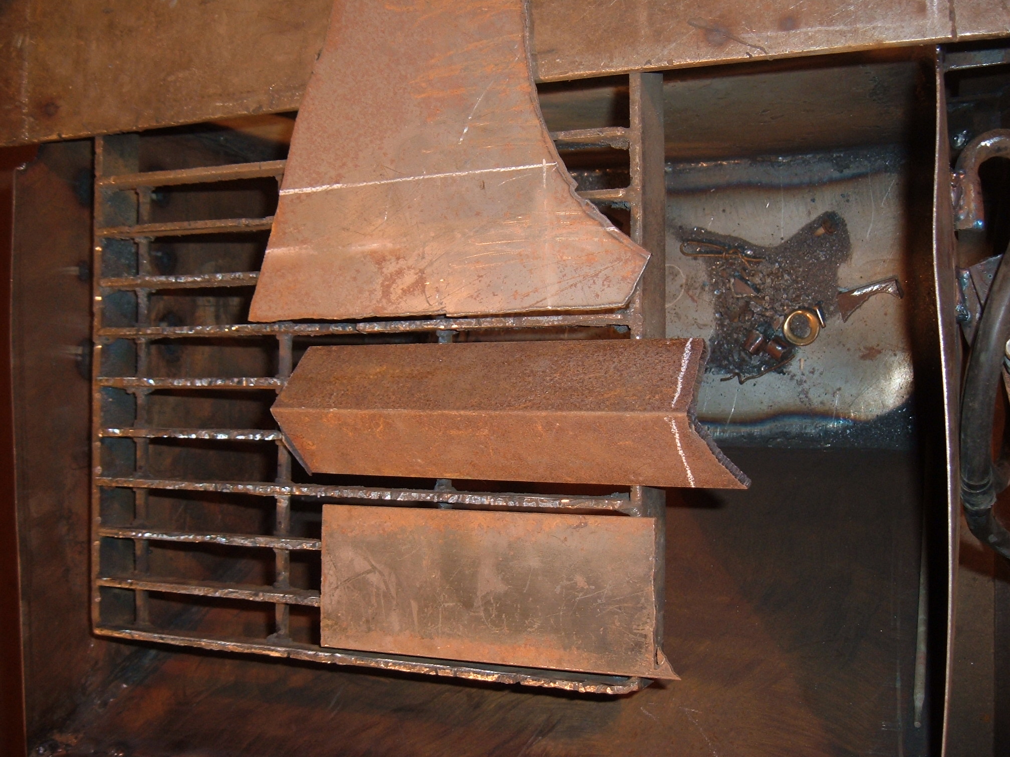

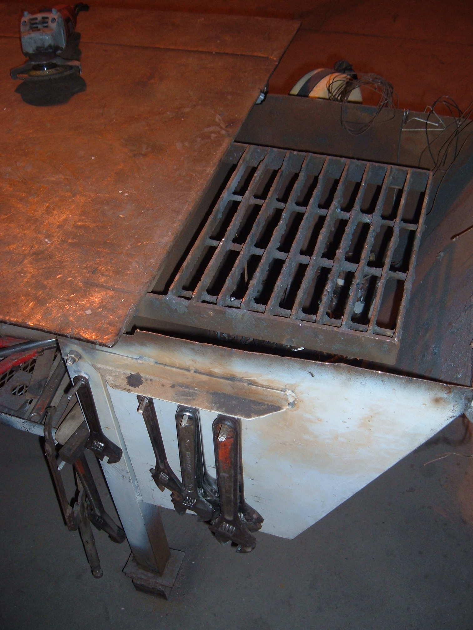

Paint sticks, yard sticks. Short stuff I do by hand, I been doing it long enough I can get close. Pic 3 oxy torch. No guide. Little jerky, I dont do it a lot or enough to be reallyyyy smooth. Can blow about 95% of the dross in the box. By the time I am done with it the stuff is really scrap.

I dont look at a lot of utube but the thing with the drill is good. An old now deceased bud of mine, Franklin Domeres invented a deal called a Steel Beaver that was similar,,, way before a battery drill was a reality but it had a crank and clamped up any conventional torch. Its a neat idea and if I was cutting a lot or making bevels would do something like that and it could be quick to build. My stuff is so limited that if the line is straight I can cut it straight and use a simple yardstick that I have the feel for. Most of the time dont even clamp it, occasionally on one end for long sheets.
That's some really nice blow torch work there. I wouldn't even show my torch work here. But the plasma I can cut it like a shear. BTW, I use angle iron with my drag tip.
