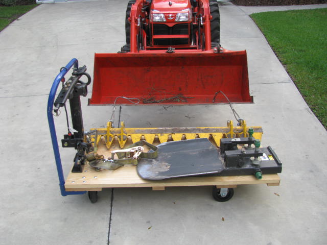

So I plan to store my attachments and tractor indoors but with limited space I would need to move some of the attachments I have by hand. Any suggestions on the best way to go about it. I was thinking some sort of dolly/cart that I could set them on and then push out of the way. Looking for ideas and thanks in advance.
/ Storing and moving attachments #2
Dollies and carts are pretty common, but you need a solid smooth floor. They won't help on a dirt floor like in most sheds and pole buildings unless they have big wheels.
I'm considering some kind of hoist, but haven't figured out just what yet.

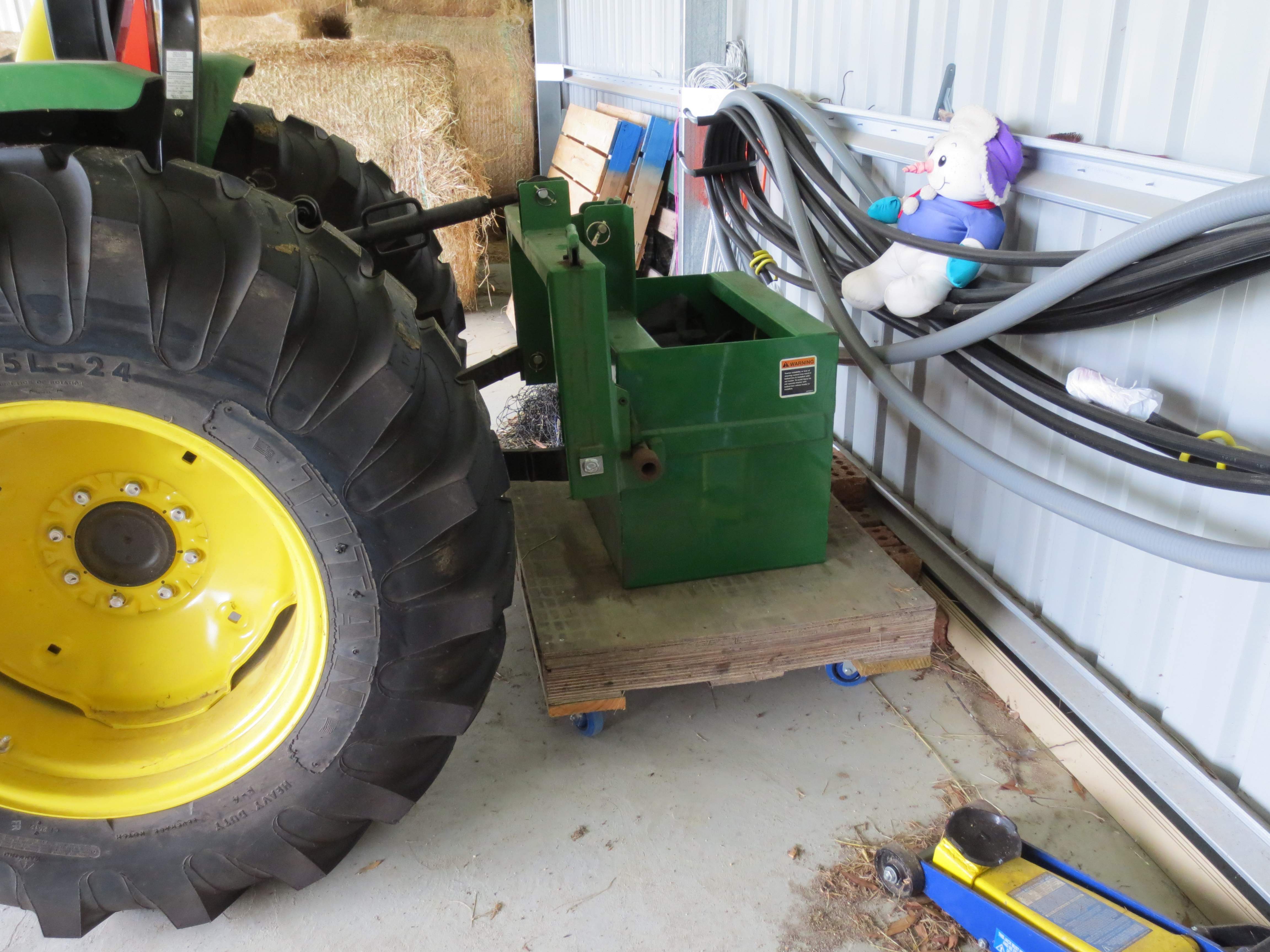

I have all (well, except my ballast roller & the drag harrow) of my FEL and 3PH implements on wheeled pallets. I made them up myself using heavy duty castors from one of our big hardware 'box stores' (as you'd call them).
My shed has a reinforced poured concrete slab floor... In the second picture there is a 'slasher' in the back, then the tiller, the 4in1 bucket followed by the fertiliser spreader. My landscape rake, also on it's wheeled pallet is also around the other side of the tractor. I just (single handedly) slide them apart and then slide them into position for hook-up. Easy-peasy.

That's awesome, prob. makes hooking up simple since you can easily maneuver the attachment...

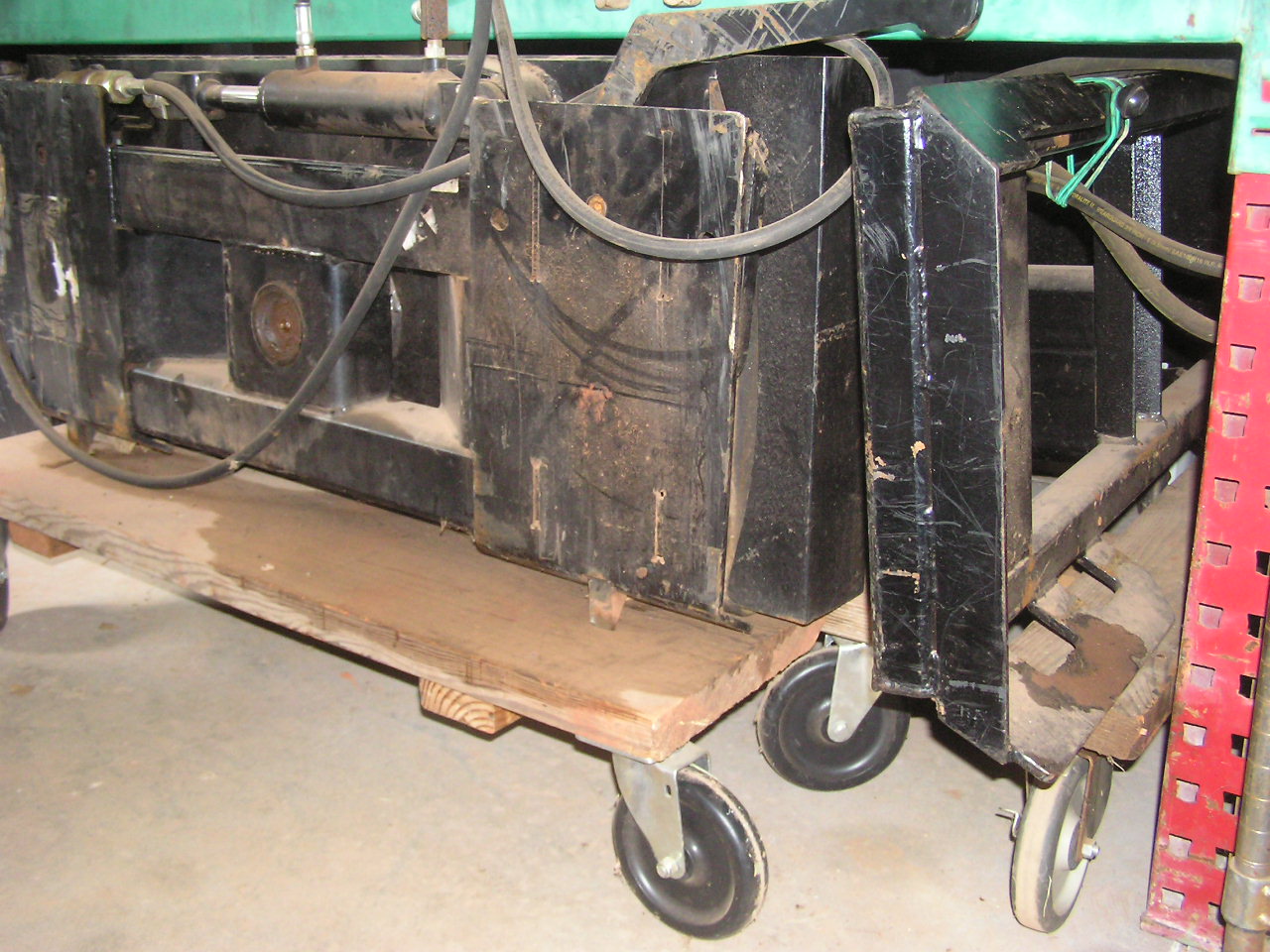

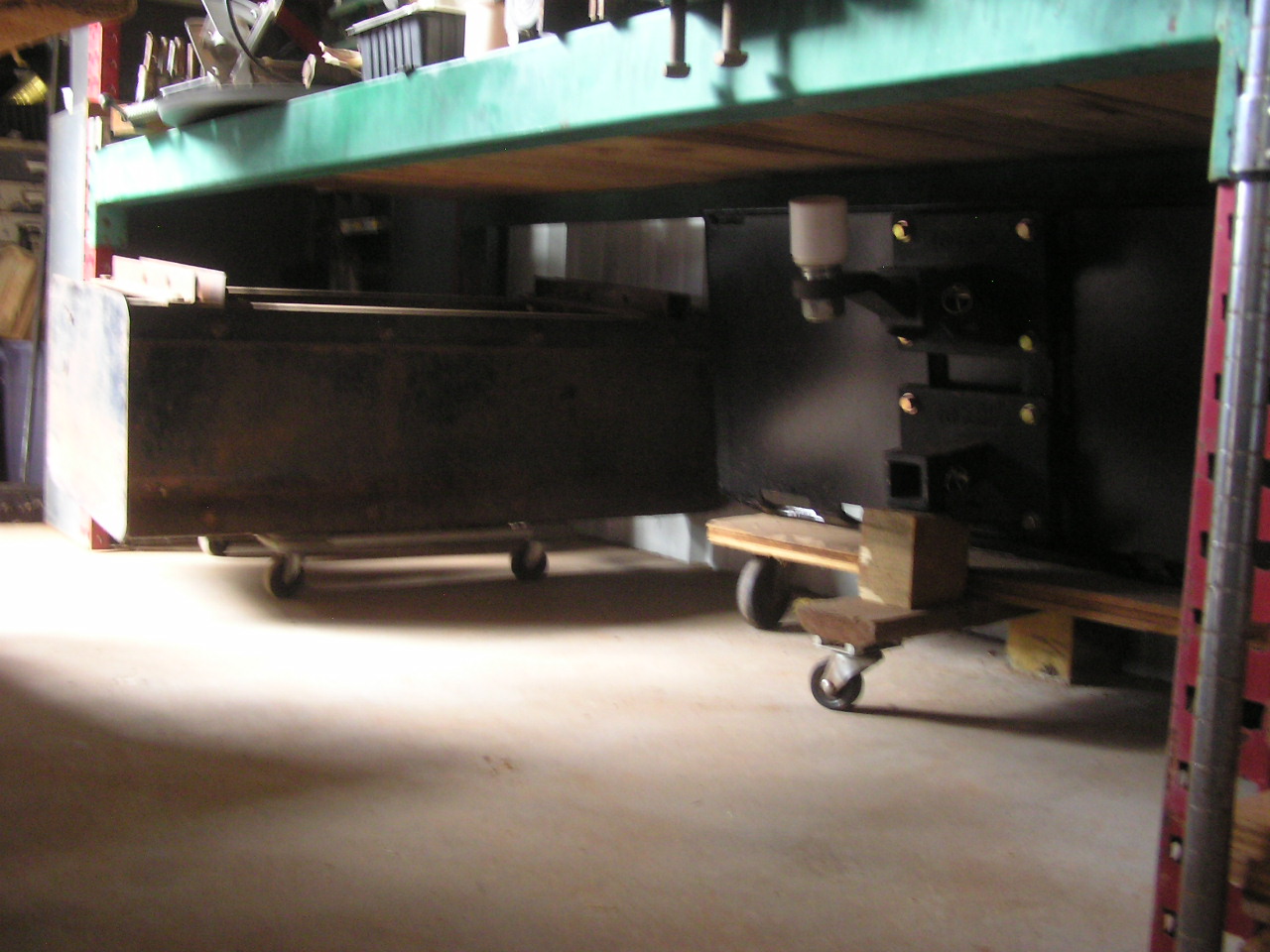

On one section of the pallet rack, I put the first shelf up a little higher than the other sections so I could store 5 attachments on dollies under it.
The first two, the 4' box blade and the dual receiver hitch:
#3, the 3 point adapter:
#4, the tree puller:
#5, the tilt-tach:
