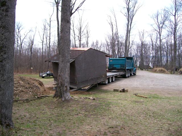

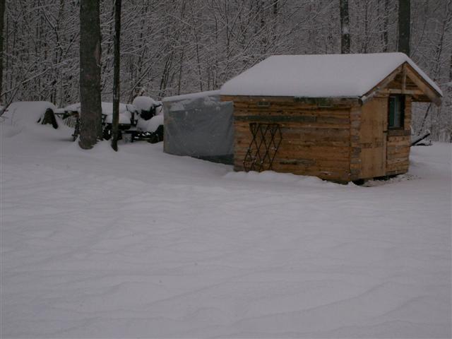

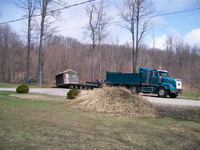

Looks like a job I also did early in the spring. My friend was getting rid of a 10x10 shed and I needed more storage so I hauled her home. I just wrapped a chain around it (with corner protectors) then anchored it to one of my big maple trees. As I pulled ahead a little at a time, I kept readjusting the chain and rotated the shed on the tail of the trailer to get it to face the right direction and set it right on my blocks. Worked out better than I expected. No jacking or bull work. I was kinda proud of myself:D first time I ever moved something that wasn't on wheels:D
Here's a pic of it now.

The one thing that worked really good (I can't explain it real good) is use some 2x8 or 2x10 planks, nice and long. I did this even though I had a hydraulic beavertail (which I didn't use to lift). Put them under your shed out the back of the trailer, down to the foundation you are putting the shed on. In my case mine went on blocks (the tops they cut off square highway guard rail posts) so by using the planks I didn't have to jack the shed. It slid right onto the blocks, then the planks just fell loose to the ground when I pulled ahead enough to get them off the trailer.

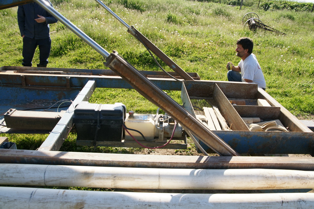

I prepared a gravel pad for the foundation and by early June the barn was done and ready to deliver. I contracted with a guy who builds barns himself and has some really cool equipment to move them. The first pictures are the site where the barn will go and a shot of the barn at the carpenter's farm. The next few are of his cool barn-moving trailer

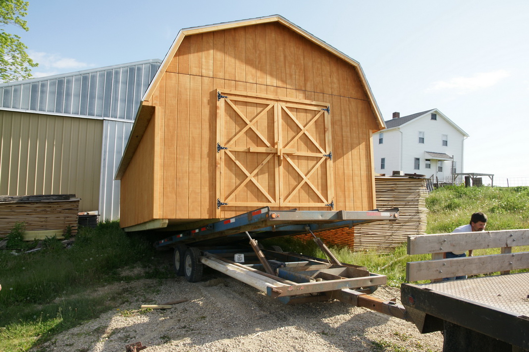

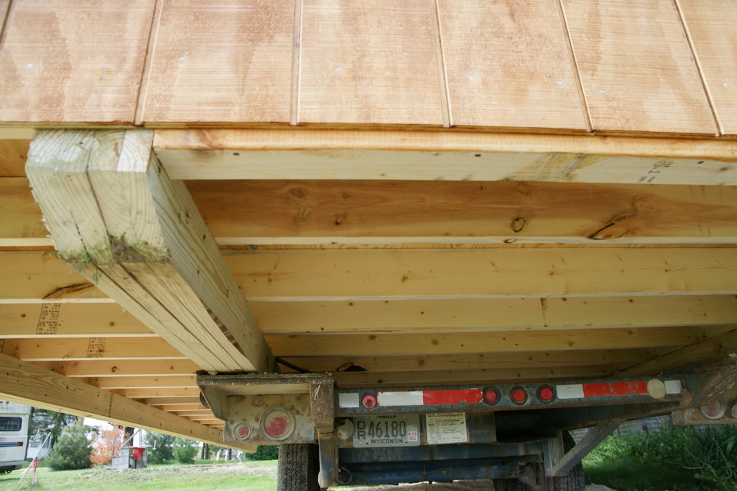

The barn mover had the COOLEST Trailer. He extended the tongue of his trailer and boosted it up and spread a little bit of WD40 on the rails and then simply BACKED the trailer up, sliding the rails under the barn skids and the barn was on! I was amazed. I thought for sure he was going to have to winch it on but he says he does it this way all the time. WOW. It was a tight fit getting out of the yard but we made it and started our knuckle biting trip home.

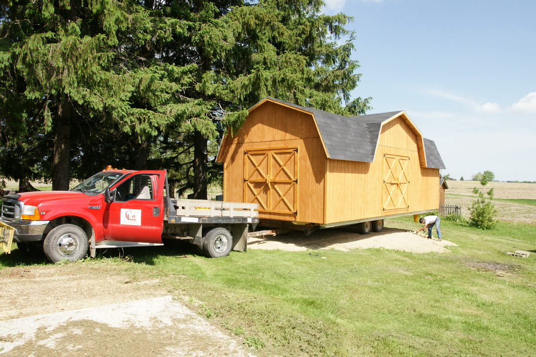

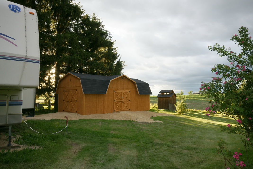

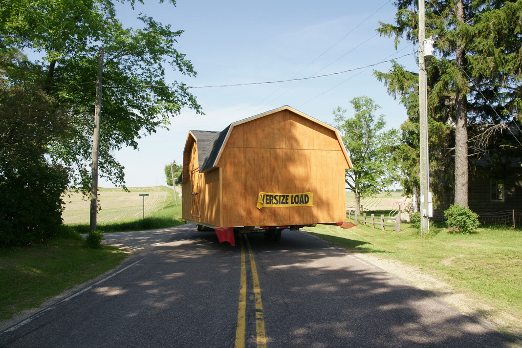

I ran interference for him once we were on the road and other than having to flag down a few drivers on some blind hills and curves the drive went well. Before you knew it we were home and unloading.
All told it only took a couple of hours to load, drive, unload and position.
Now my baby has a home. And as luck would have it we came in just under our $6,000 budget.
I'm a happy man.
