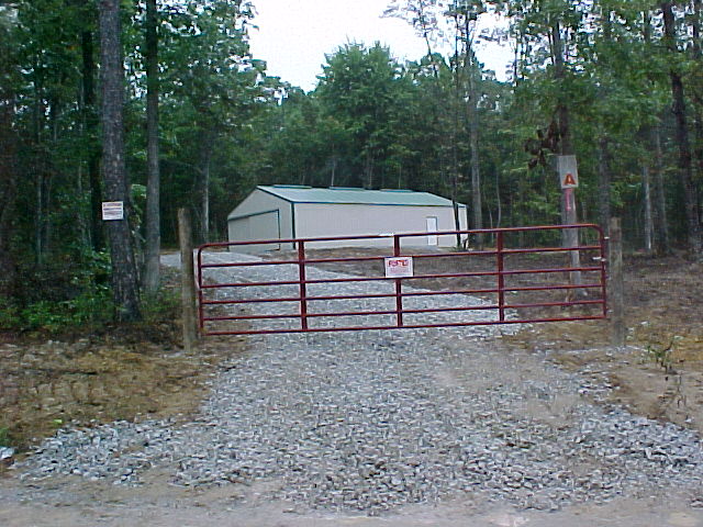

John, one decision you need to make is, do you need someone else to build it, or can you do it yourself? I had a polebarn erected for me last year by National Barn in Portland, Tn. they also serice your area. My need was larger than yours, but here is what I got. A 30x50x10 pole barn, with 30' of ridge vent, 1 man door and 1 12' slider. the complete installed price was $8900.00 ( They has a 4 man crew that did the job in 3 days) I did the concrete floor this past spring. I did the leveling and spread the stone base, plus laid the vapor barrier. I then hired a local concerete finisher. My cost for the floor was $26025.00 It is a 5" floor. The finisher charged $600 and the 22.5 yards of 4500 psi w/ fibrement was $2025.00. This all included tax.
National Barn offers a variety of sizes and they will even sell you a material kit if you wish to do it yourself. They are on the web www.nationalbarn.com. Just another option to consider.
