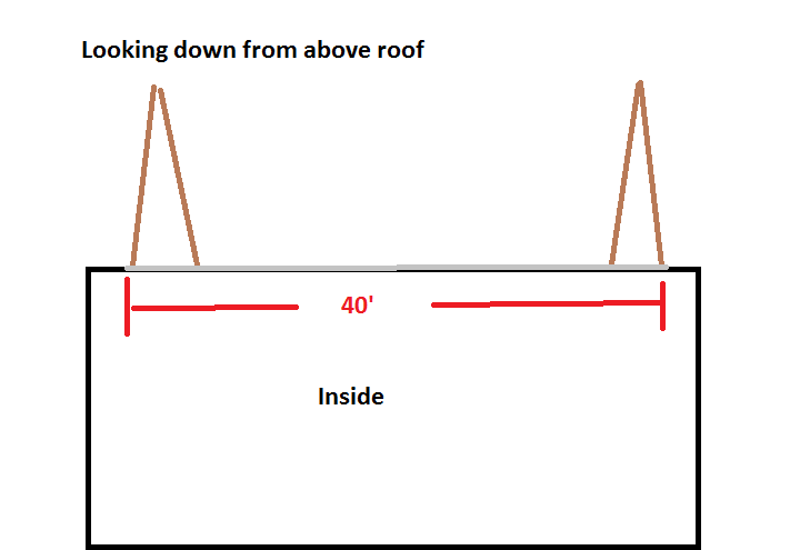

Another thought. You've no doubt seen those roll up security doors on stores and commercial buildings? Instead of rolling up overhead, what about rolling to each side? The roller mechanism would be standing vertically at either side of the opening, each retracting a 20' section. Tracks at the top and bottom would keep it aligned. No snow issues.
No idea of cost, but that doesn't seem to be part of the question.
/ Storage building door recommendations #19
You ever unroll too much toilet paper, then roll it back up. Fine. Now unroll too much toilet paper and then turn the roll on it's side and try and roll it up.
You'd need tracks at top and bottom, and some sort of tensioner to keep it on the roll since by putting it on its side, we've eliminated gravity to keep tension on it.
/ Storage building door recommendations #20
I would think a cable tension system could be used in the track grooves. As the right door opens, cables at the top and ground levels keep tension on the lending edge from the left side. Then those cables could actually pull the door closed. Same for the other side. Just an idea. Not sure if any company makes them, though. Jon
