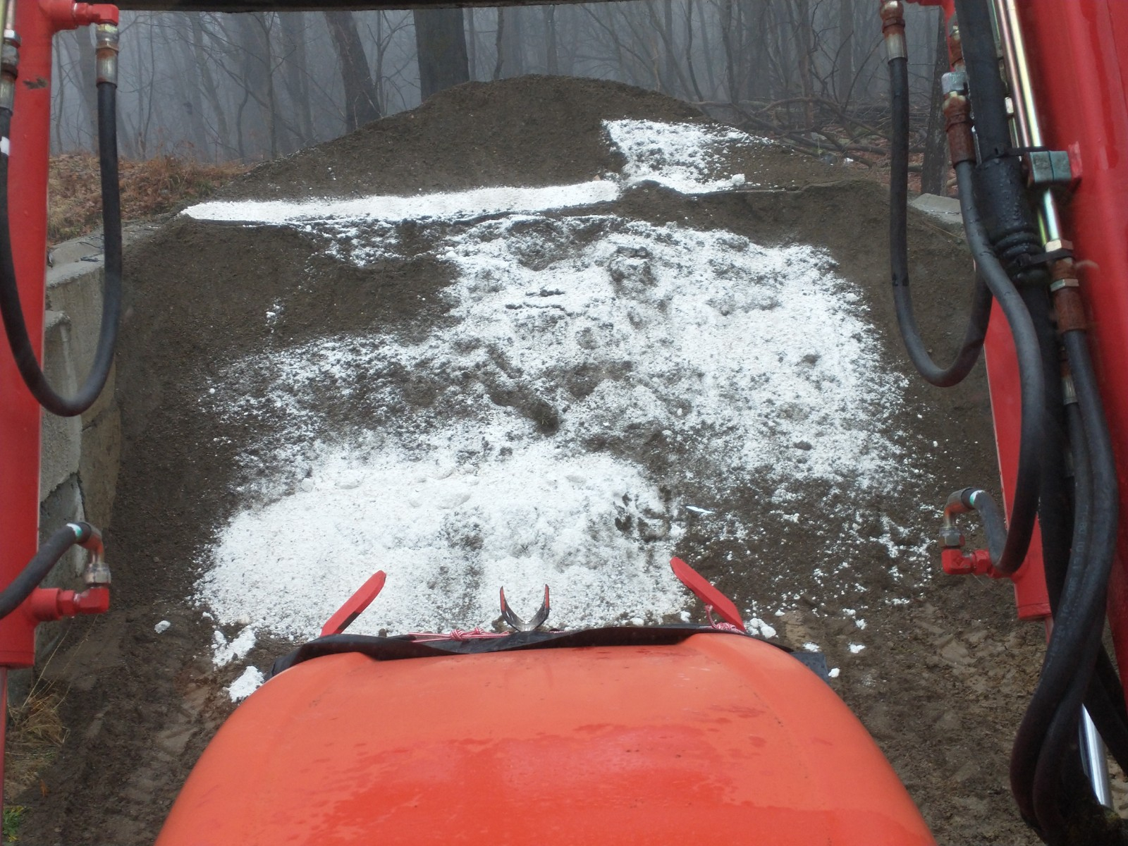

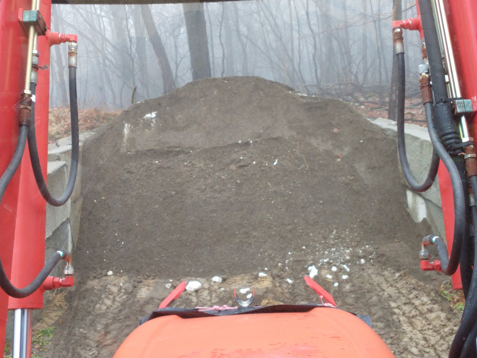

I use pit run sand, I get a triaxle load every couple of years, it has some salt mixed into it to slow down the freezing in the pile.
This year when I got my load I added 500 pounds of more salt to the top and mixed it in a bit.
I also use coal ash most years to as a good way to use the ash.
The last 3-4 sacks of salt spread out
mixed into the top layer and all pushed back

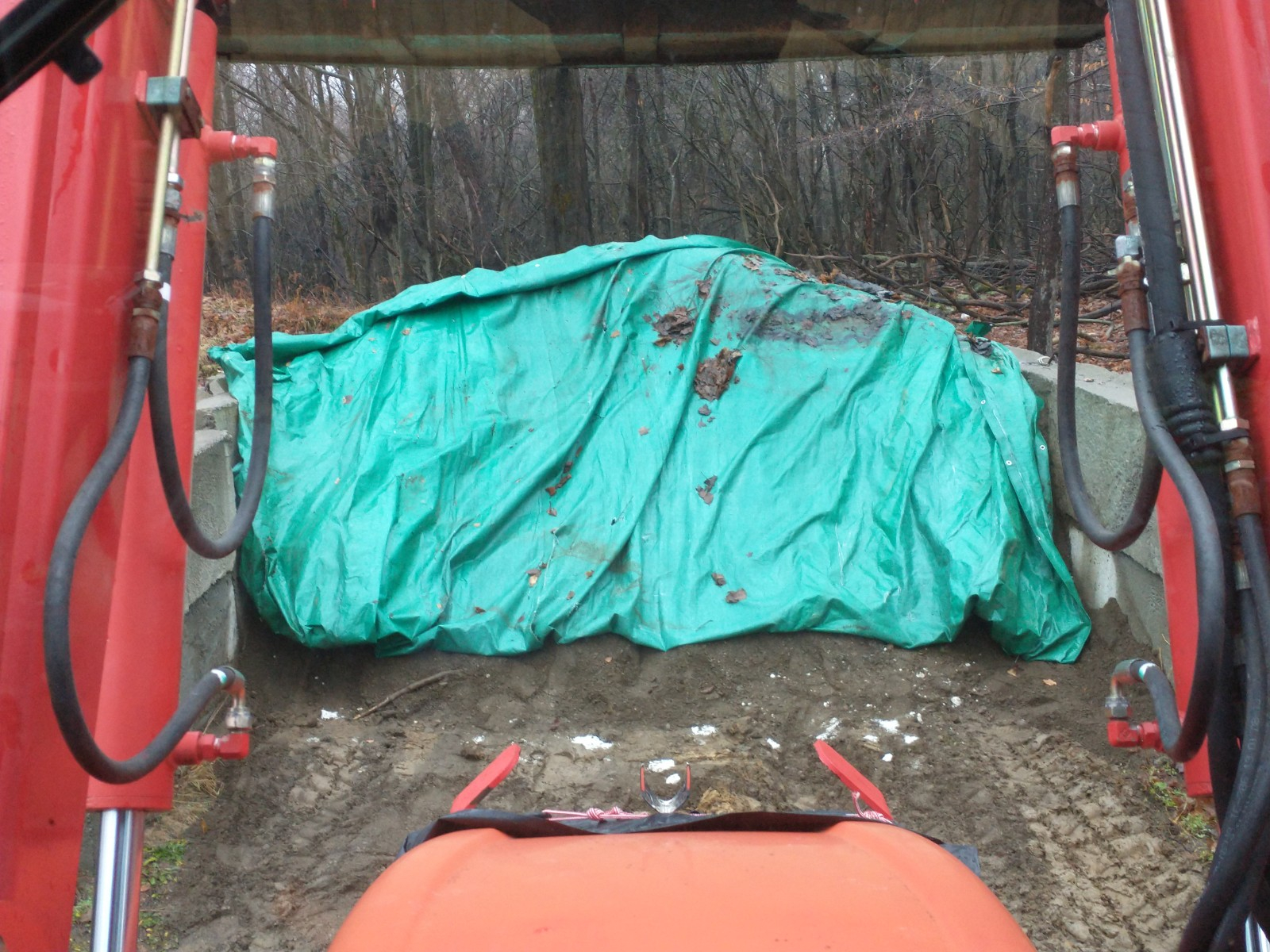

Tarped and ready to be uncovered and loaded into the sander.

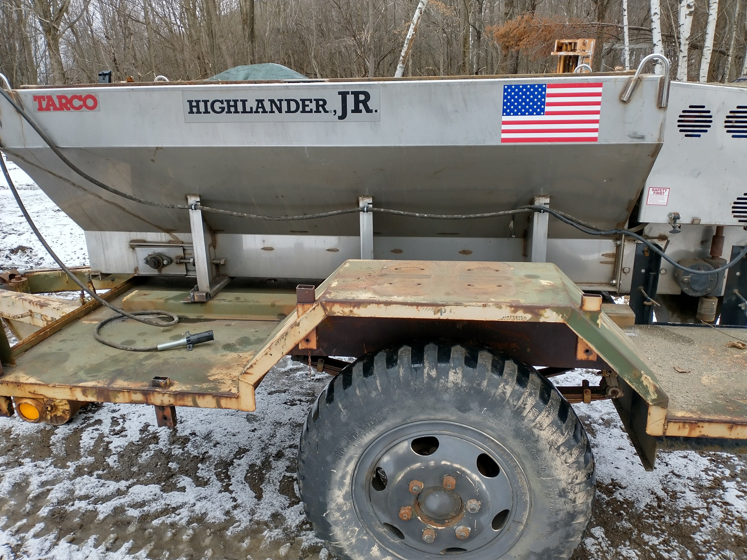

sander ready to be loaded and spread
That looks like what I want to do. Thanks!

Yes, to other questions salted sand does tend to hold more moisture.
But the salt helps minimize the freezing. At times I'll have 4-6 inches of frozen sand in my pile,
I can push in under it and break up most of it and the sand under is still thawed.
I keep it cover as best as a tarp will do, to reduce the snow and rain that gets to it.
I'll drive over the frozen chunks then they will go through my sander.
