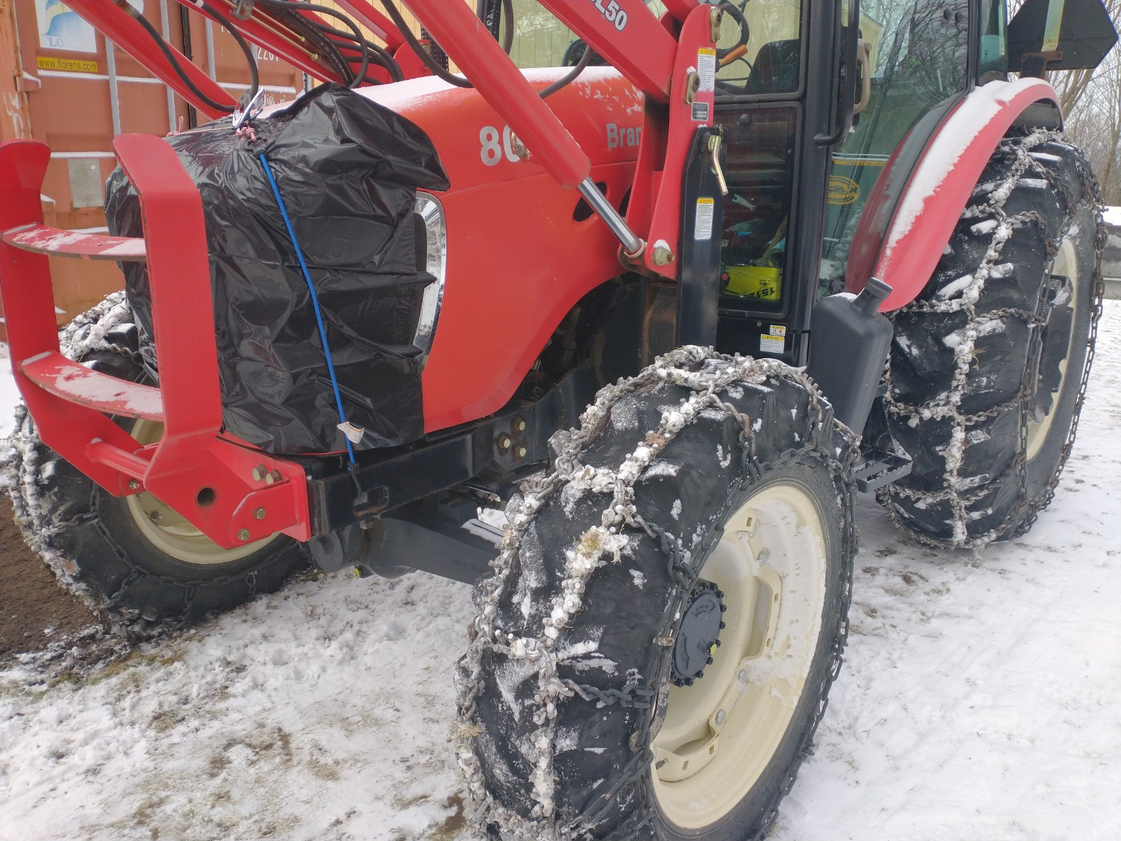

Sorry to say, the wrong chains then.
These will bit and go, the best of any chains I used in a great many years.
I can stop and backup on my 26% slope on ice.

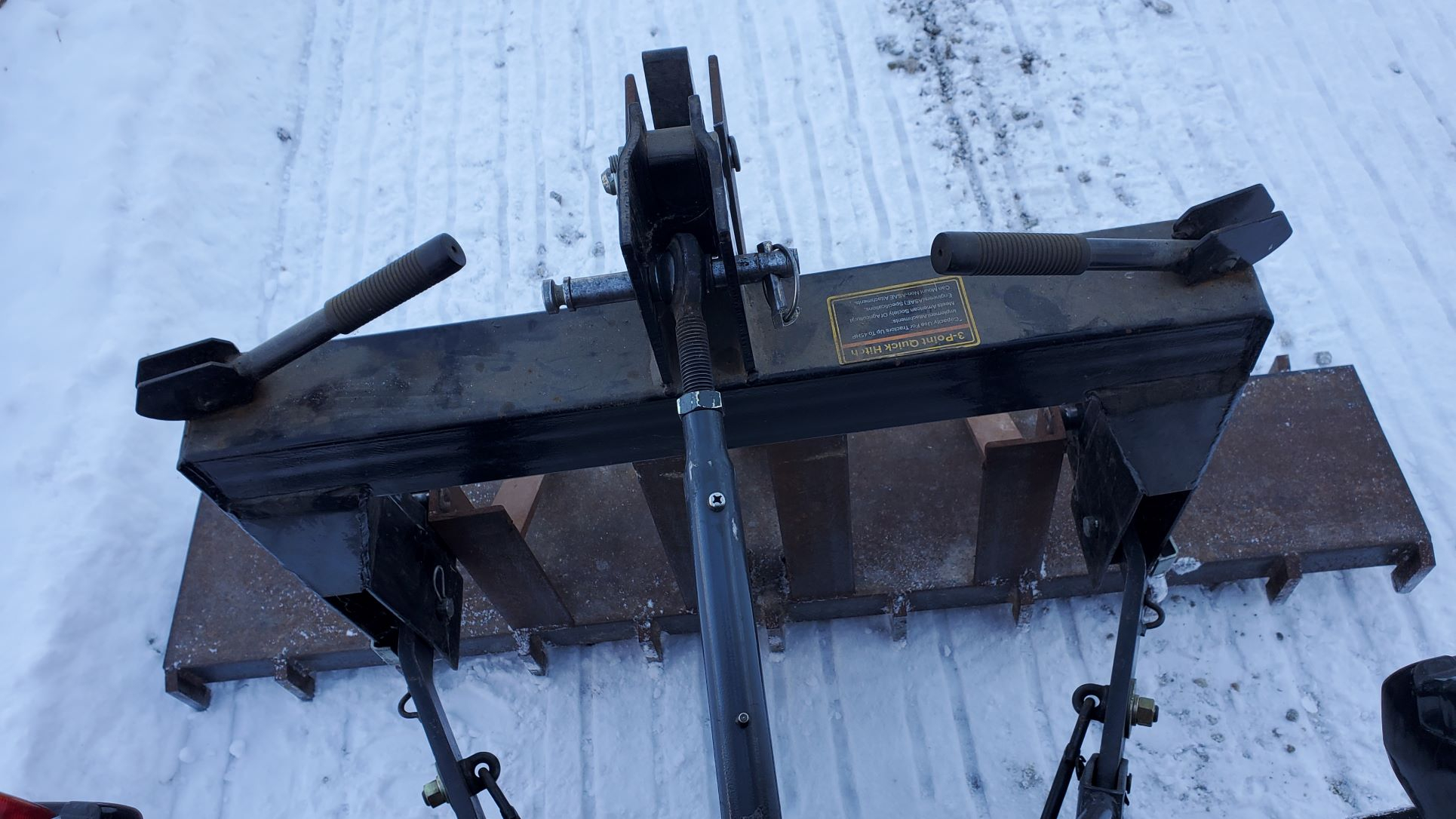

Similar here, except my drive is all uphill. I made what I call an ice ripper. simple C channel with spikes welded and 3pt frame. The tips are starting to round off, but have been using it for over ten years, but only need it occasionally when the conditions are just right to make drive ice.
