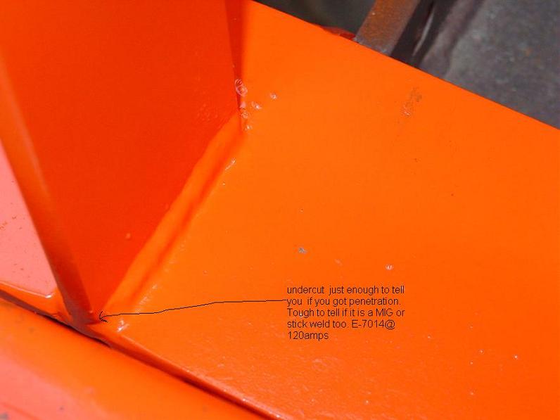

Everyone should note that 6010 is a DC rod that CAN'T be used on an AC welder. 7018 is also a rod that is tough to use on a 220 volt welder. You need 7018AC for it to work properly on a 220 volt AC Welder. 6013 and 7014 or what the industry calls "contact electrodes" in the fact you keep the electrodes in contact with the base metal. This is unlike 6011 where a arc gap diameter of the electrode is necessary. Too much gap and slag ALL over too little gap and it sticks to base metal. Holding the gap is what is called EXPERIENCE. Some times you hear contact electrodes refered to as "Granny Rods" since they are so easy to weld with your Grandmother could weld with them. If you are looking for a cheap way to drive out moisture from your 7018AC rods look no further than a used toaster oven found at a garage sale or goodwill store. I store all my eletrodes in PVC pipe containers with pipe caps on the ends with duct tape to seal them for long term storage. Moisture can't get in and if you put one of those silcate packets in with the rod the moisture will be absorbed by the silicate packet if there' is moisture in the air trapped in the tube. I always heat my 7018Ac rod for 2 hours at 300 before I use it and I NEVER heat more than I plan on using.
Now. lets talk about why lately guys are rushing out to buy to small or expensive MIG welders without the intention of welding thin sheet metal nor are they in the production welding business. The simple reason this is happening is because that they are short cutting their lack of welding experience and are trying to substitute it with paying more for a welder "BECAUSE THEY CANT HOLD AN ARC WITH A STICK WELDER NOR DO THEY HAVE THE TIME TO TRY OR PRACTICE. I know tons of guys that want that "stacked dimes" weld and think they can do it themselves. Well guess what Guys? That will NOT work in the year 2004. 95% of us would get by nicely with 220AC volt welder for the limited amount of welding we do in a year. I consider myself a VERY GOOD hobby welder and I burn 15 to 25 pounds of electrode per year making all sorts of tractor accessories and othe "stuff. 95% of my welds are on 3/16 to 3/8ths angle and plate are less than 4 inches in length. If I am in the 95% average weekend group and if I can't financially justify a 175 to 220amp 220 volt Mig welder with proper shielding gasses why is everone rushing out out and buying a MIG welder then???? A bad looking 6011 weld is 20 times better than a good looking Mig weld that peals off like bathtub caulking because you had no pentration on a poorly set up or too small a Mig welder with poor welding experience. Think about it. A Hobart 220 AC stick welder is on sale at TSC for 199.00 and you can do many more things with it on thicker steel than a 400.00 dollar 120volt Mig welder.
Check out my pix of a 7014 1/18 electrode @120 amps on 1/4 flat plate with my 220AC hobart welder. Even if I say it myself that is a darn good stick weld without being MIGed.
